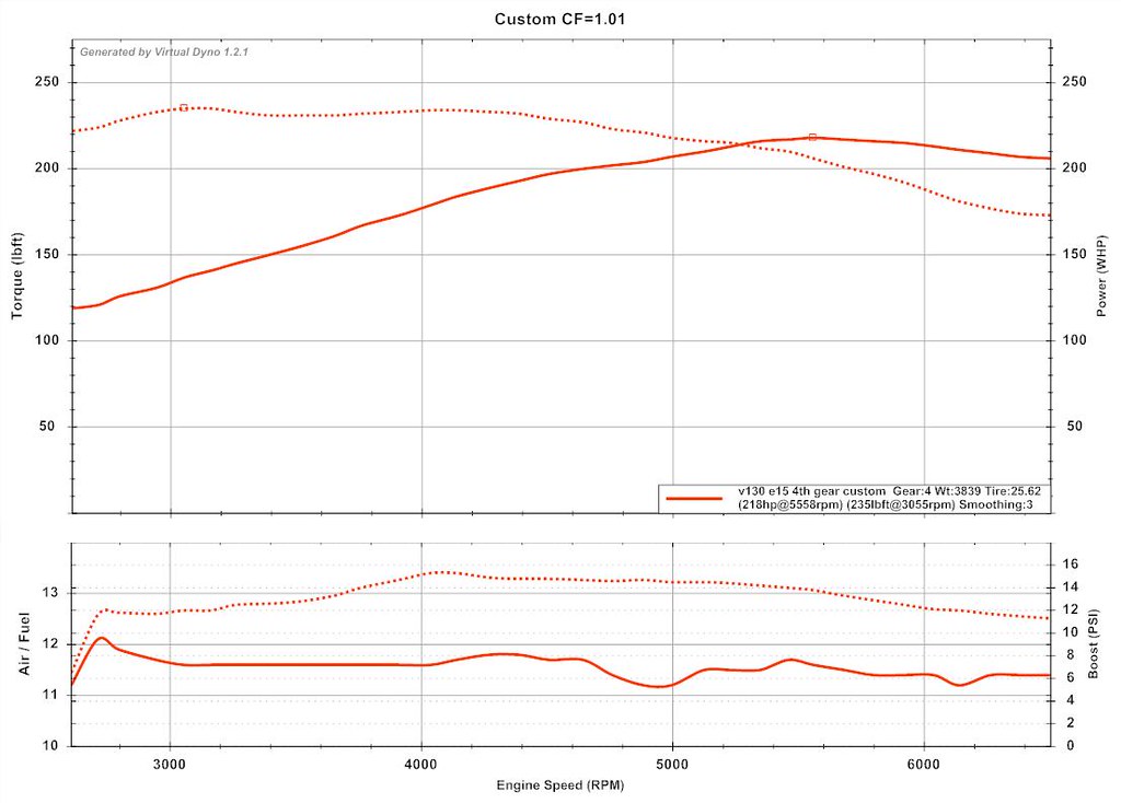

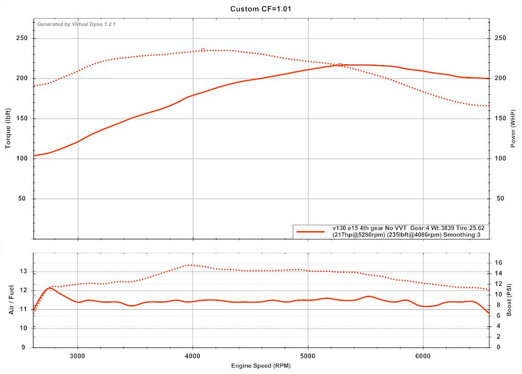

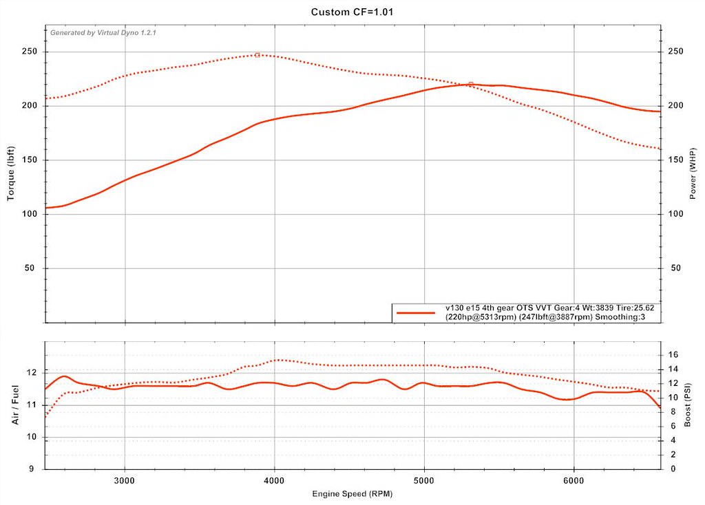

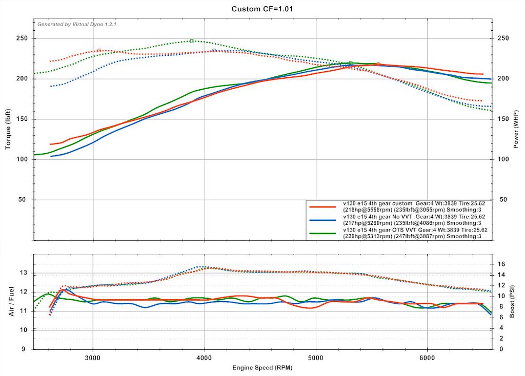

Captain
djuosnteisn's Avatar
Location: Rio Rancho, NM
Posts: 11,480   (View Stats)
Rep Power: 15759
Thanks: 33,656
This is prob the next best thing
It's not on a dyno, but it has all the pertinent information.
Basically, 30's on the VVT make the intake valves open up earlier (BTDC), increasing overlap, low end torque, and dynamic compression.
0's on the VVT make the intake open up later, up to roughly 2* ATDC, decreasing overlap, push power to redline and reducing dynamic compression.
I've always had the occasional PT KR pulling away from stop lights, and so i went ahead and expanded the region of zeros in the VVT here:
See that upside down triangle of low values around 2500-3000 rpm and 0.69 load and below? I pretty much expanded this triangle downward, decreasing the values at higher loads to essentially decrease the dynamic compression.
It seems to have worked like a charm, but i also having driven my car in a like 2 weeks or so.
500awhp 440awtq uncorrected

 Old 01-12-2013, 05:09 AM   #116
sidekick's Avatar
Location: San Jose, CA
Posts: 3,093   (View Stats)
Thanks: 5,963
I did each run within 10 minutes of each other, so conditions were pretty much identical between each pull. Here are the results:
All three:
No VVT:
Custom VVT:
OTS VVT:
My settings and no VVT had almost identical results, but there was a pretty big increase in torque with the OTS VVT tables. I've attached the logs as well.
