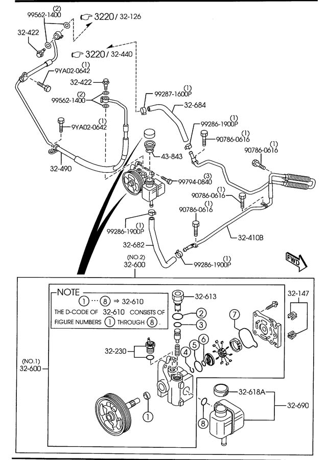

My PS is leaking all over the place from the line that run across, right under the radiator (hard return line) and from the cooler as well; I'm thinking of getting your kit... however I found something inconsistencies here vs your instruction.
The hard return line fitting has actually a 1/2in diameter near the cooler while the rack side has 3/8 ?
In the instruction for your kit, you also ask to keep the "S" hose, which is the one between the rack and cooler, while the picture show that it is replaced anyway. Does it stay or we replace
Also, you replace the hose between the hard return line (under the radiator) and the cooler, with what appears to be a 3/8 hose ?
Would you happens to know what the hose fitting size is under the fluid tank ? I would trash it and simply replace it with rubber line 3/8 up to the tank, it's not a big deal since it's the low pressure side.
@MATT DAMOND;
If you mind clearing that up for me, I'm a bit confused.
Here is the setup I plan: I'd like to remove the 32-410B hardline forever, and have a single hose to replace the 32-684 from the rack to the cooler, and then replace the 32-682 with a single hose from the cooler to the fluid tank.

I just happen to have the PS reservoir off the car, so can confirm that the bottom hose connection is nominally 1/2 inch as is the hard piping. Most small coolers are 3/8 and I've used a 3/8 cooler and hose for years with no ill effects. I sourced 1/2 x 3/8 reducers in stainless from McMaster-Carr.
