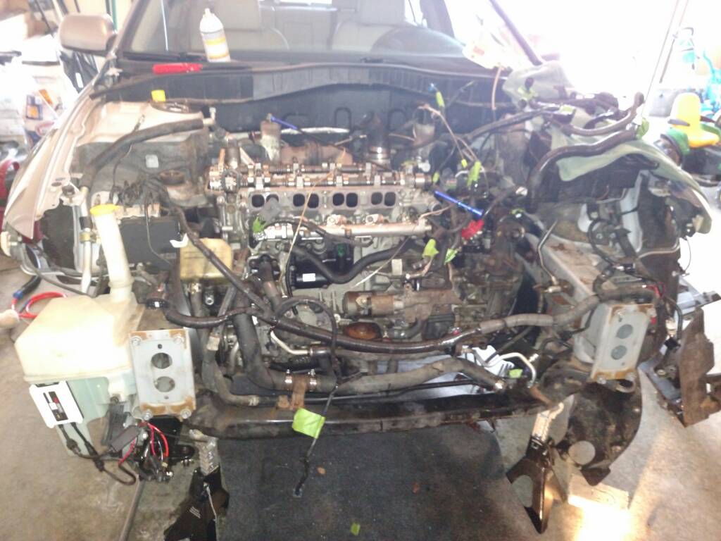

| Not Ranked : 0 score The engine is out; Thanks for the advice! I'm tearing everything off the motor, replacing: Water pump Tensioner pulley Idler pulley Belt Thermostat Clutch kit I only have the one hoist, no engine stands, how much of a pain is it going to be swapping the transmission over to the new engine? Is it easy enough to do with everything just sitting on the ground?
__________________ _______________________________________________ Driver Mods - Mid Ohio Three Day Racing School 2006 Mazdaspeed 6 GT - 130k+ miles. Daily driver (Actually my Wife's car) Shooting for a reliable 350 AWHP. Surefire Remanufactured Engine Installed @ 135k. Mods: BNR S3 Turbo \ Grimmspeed EBCS \ Guardian Angel \ Cobb AccessPort \ Bosch 3 Bar MAP sensor \ AWR RMM \ TurbineTech FMM \ Corksport HPFP \ cp-e Injector seals \ Autolite XP5263 plugs \ Ebay Circuit Werks DP \ Stock CBE \ HTP 3" Intake w/ DIY CAI \ cp-e TMIC \ DIY boost tubes \ Primary & Secondary EGR delete \ Bilstein Shocks \ 215/45ZR -18 Continental ExtremeContact DWS PERM dual PVC plate and two Damond Motorsports catch cans. Full vacuum setup w/ VTA for over pressure. PERM #1 -> DM OCC V1 -> DM PCV valve -> Check Valve -> Intake Manifold. PERM #2 -> DM OCC V2 w/ VTA -> Check Valve -> Tee -> Valve Cover & TIP. The others: 2009 BMW 135i - N54 - JB4 w/ backend flash \ SRI. 1998 VW GTI VR6 - 248k miles (stock clutch!) when wrecked (not my fault) ![]() 1995 Jeep XJ - 4.0 - AW4 \ Lift/Tires etc. 230k miles. Rust bucket / winter beater. 1995 Honda del sol VTEC - DIY hodge podge turbo setup \ self tuned w/ Neptune. 2550lbs ~270whp \ 150k+ miles on stock bottom end (4th clutch though) \ knock limited on 93 octane. |

| Not Ranked : 0 score Well, I got the transmission off pretty easily with just the hoist. Hopefully it isn't that hard to align it back to the new engine using my He-Man powers alone.

| Not Ranked : 0 score I suggest pulling the front clip off. It just frees up so much room and it's really pretty simple. Maybe it's different from a 3 to a 6, but I wouldn't even hesitate pulling the front if I have to do this again. Just my .02¢ Sent from my XT1254 using Tapatalk again, mine is a 6, but just an idea of how much more room you free up/less obstacles.

| Not Ranked : 0 score its always easier to remove the whole front clip.
