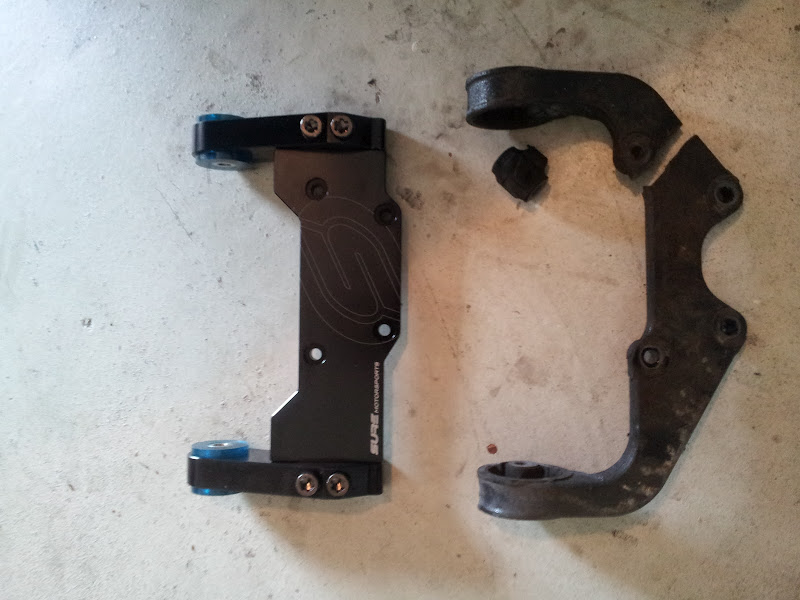

One of the weaker links in the MS6 is the rear diff's bushings. You can buy replacement bushings, or if you're hardcore like all of us here on MSF, you'll just upgrade the whole damn mount! Because RACECAR!!
The rear diff actually has 2 mounts. Here are ALL the options you have for rear diff mount upgrades.
Bushing Upgrade:
$44.08 USD - Turbine Tech Bushings
Stock bushings for reference
"Rearward" Rear Diff Mount:
$255 - SURE Motorsports Dreadnaught
$269.00 - CP-E Rear Diff Mount
"Forward" Rear Diff Mount:
$245 - SURE Motorsports Juggernaut
$289.66 USD - Turbine Tech Differential Mount
2007 MS6 - broked & gone
2006 MS6 - less broked

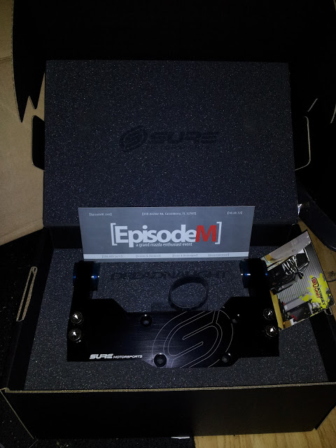

Feel free to post your own pics & rants/raves of your diff mounts. The more feedback we get, the better we'll be able to help newer guys looking to upgrade theirs not have to ask too many questions.

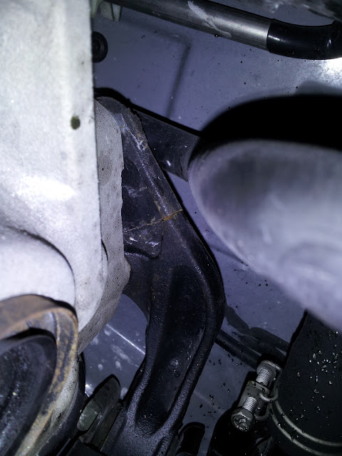

Ok so yesterday I noticed while downshifting there was a clunk noise which felt like something hitting the bottom of the car. Gotta be a diff mount right?
I knew I should of done the diff mounts before AP but I want more Powa!!
So question is. Do I stock out go to dealer and have them fix it under warranty or just upgrade the mount now and avoid the hassle. I can just limp around until it's fixed right?

i am in the same boat now, had the same holy shit i hit a huge pothole noise.
Had the sure mount on since i got the car just over a year now. Dissappointing to say the least.
I have a clicking type noice that changes with acceleration and if you pull up a couple clicks on the ebrake. Going in tomorrow. pretty sure it is the internals.
Fidelity extended warranty is about to get tested... worried they are goung to tell me to shove off because of what is in my sig below...

Could very well be. Just get under and take a peek at your bolts. I limped around for a bit but wouldn't recommend it if you don't HAVE too. Depending on how cool your service dept is maybe you can go in for warranty and give them the aftermarket mount to put on instead of that oem pos.

Hey guys, I installed the SURE Dread and Jugg Diff mounts yesterday. Everything feels freeking awesome!!! Much stiffer on the rear end! I love it.
Although...
While downshifting I felt a "Clunk" in the rear end. This is after I put on the mounts. I can recreate the noise every time. I've heard of clunks from the stock mounts, but not after the install. I drove it home from our NATOR house this morning and the car runs fine, no squeaks, no grinding, no odd noises other than this. (I swerved my car side to side to see if something was really loose, nothing out of the ordinary.)
Any thoughts on what it could be? I did disconnect my Sway bar (No funds for a new one.) I've read it could be the endlinks? or something else? Any help will be greatly appreciated.
I'll double check all the bolts to make sure they are tightened down again tomorrow.

i think this is a good place for this
went to the track one night, took off fine, shifted into 2nd, heard a boom and hit redline. quick systems check, hit the gas and kept going lol. took the left axle with it so the driveshaft shop replacement is on the way. its actually marginally cheaper than the oem after the core price...

After doing roughly a dozen diff mount installs(I cannot remember the exact number), I'll share my opinions on the subject.
First off, the stock rear diff mount(the one with 2 bushings), should be upgraded on pretty much every MS6. Every mount I've pulled, even once on a MS6 with 14k miles, the bushings were completely shot. The OEM bushings of the rear mount are a poor design, and they allow for way too much flex of the diff. That's why ppl break the rear diff mount, front diff casing, or the front diff mount at the bolt holes.
For 90% of the MS6's out there, you really only need to upgrade one mount. The 10%(you know who you are), pushing lots of power, doing many launches, tracking, and hitting up the strip, it's better to have both of the mounts upgraded. But for the occasional launcher, daily driver, light track duty, 90% only need to really upgrade the REAR mount. Upgrading the rear mount, will pretty much take all the flex out of the diff, under high loads, launches, etc.
If you upgrade to just a front diff mount, you'll still get the diff to flex, since the OEM bushings in the rear are garbage. This could lead to the rear mount breaking, and the cases could crack.
As for which mounts are the best, the rears are all pretty much the same. They're all beefy as fuck, they have little to no flex in the bushings, and they cost roughly the same. I don't really recommend just adding the TT rear bushings, unless you don't plan on launching the car. They still use the rear cast mount, and it can still break.
For the front diff mounts, I'd recommend the TT FDM over Sure's FDM. Simply because it has more mounting points, and more effectively "wraps around" the diff. However, the FDM's are really only need for the 10%, and once the rear has been upgraded, adding either FDM will have the same effectiveness.
As for NVH, you'll barely experience any with the mounts upgraded.
