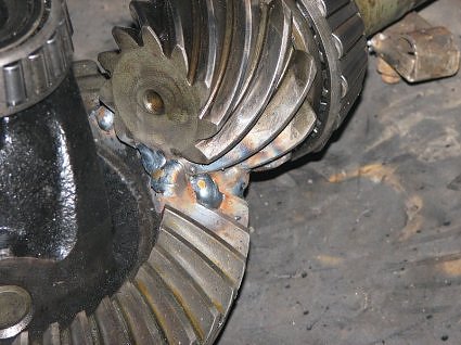

triplejumper18's Avatar
Location: Portlandia, Oregano
Posts: 2,569   (View Stats)
Thanks: 2,295
Groans: 196
The Following User Says Thank You to triplejumper18 For This Useful Post:
breakfstincluded (07-03-2012)

Damn triplejumper18, what caused that to happen?

......wow, you didnt get the joke. Tha picture is called internet joke.
Front diff is open, rear diff is limited slip. Meaning as long as the tires on the rear are the same, it doesnt matter too much on the front tire tread depth.
