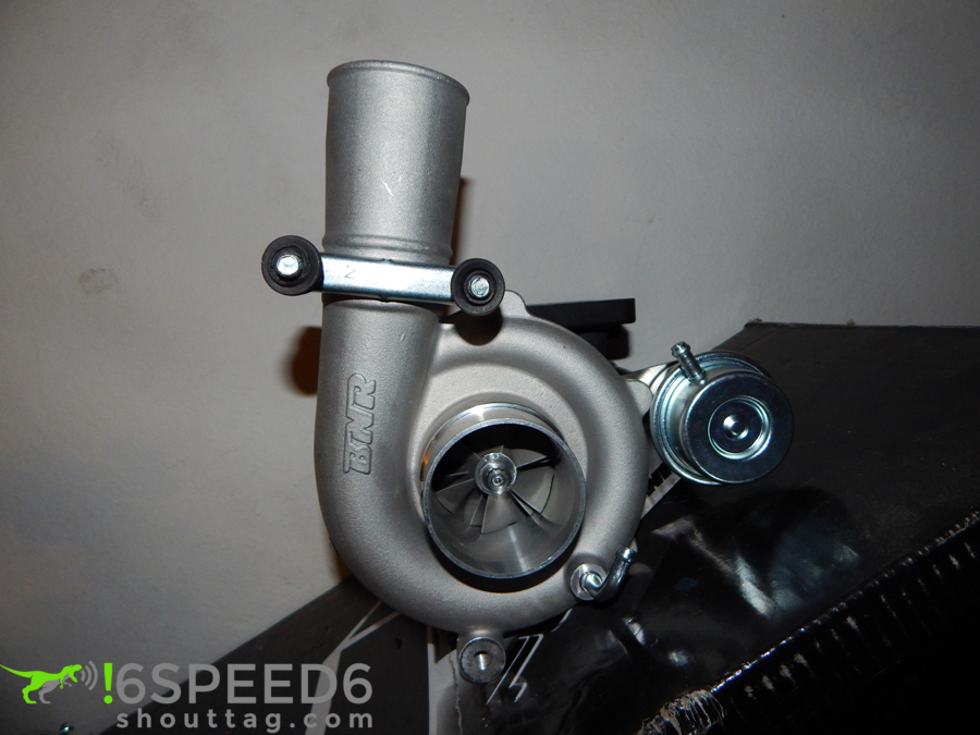

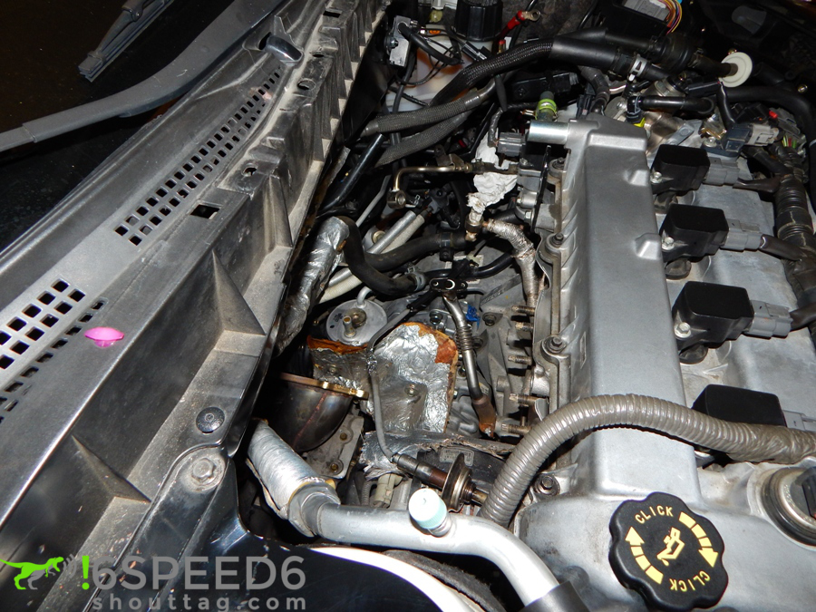

Here's the patient ready for it's turbo augmentation surgery. We are going for DD's and a tummy tuck.

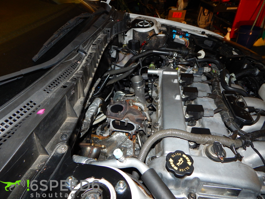

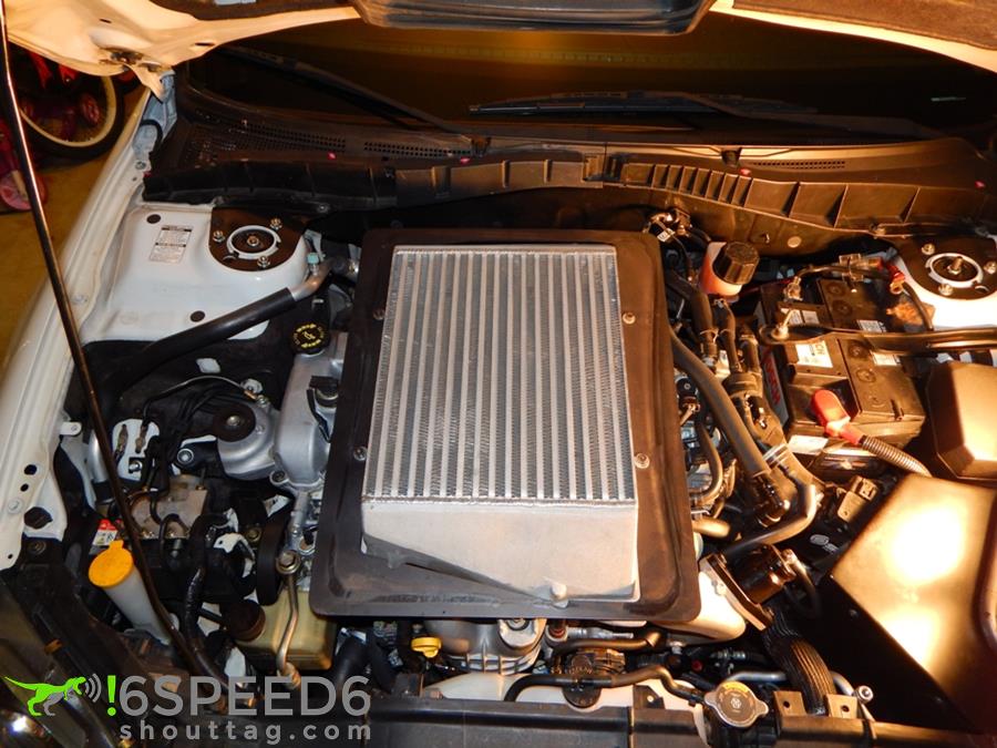

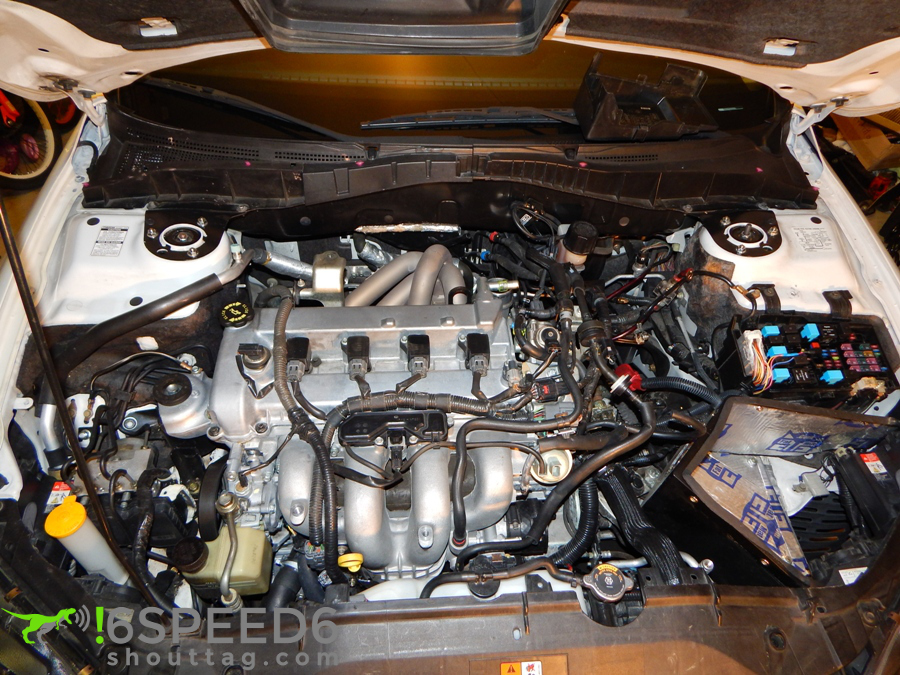

Intake and TMIC area cleanly shaven for surgery.

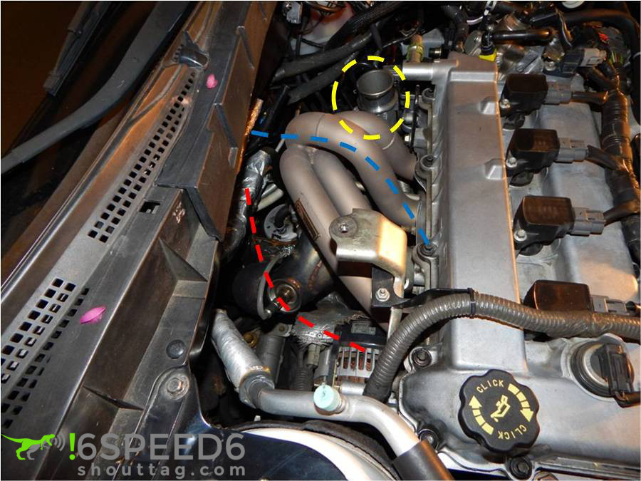

Next I made an incision on the red line just below the nipple and pulled the skin back. Then I pulled up on the flesh marked by the blue line and move that up. Then I removed the ugly flabby mass circled in yellow.
The outcome 2 hrs later. The flabby mass has been removed.
Honestly, I could have done the full swap in 1 night, 7 hrs or so, but I got greedy on the turbo studs. I figured since I recently replaced them and used a ton of anti-seize that I could easily reclaim the studs with the double nut method. No such luck. I saved 2 and already had 3 new ones. I need 4 more tomorrow. I should have just had all new studs standing by.

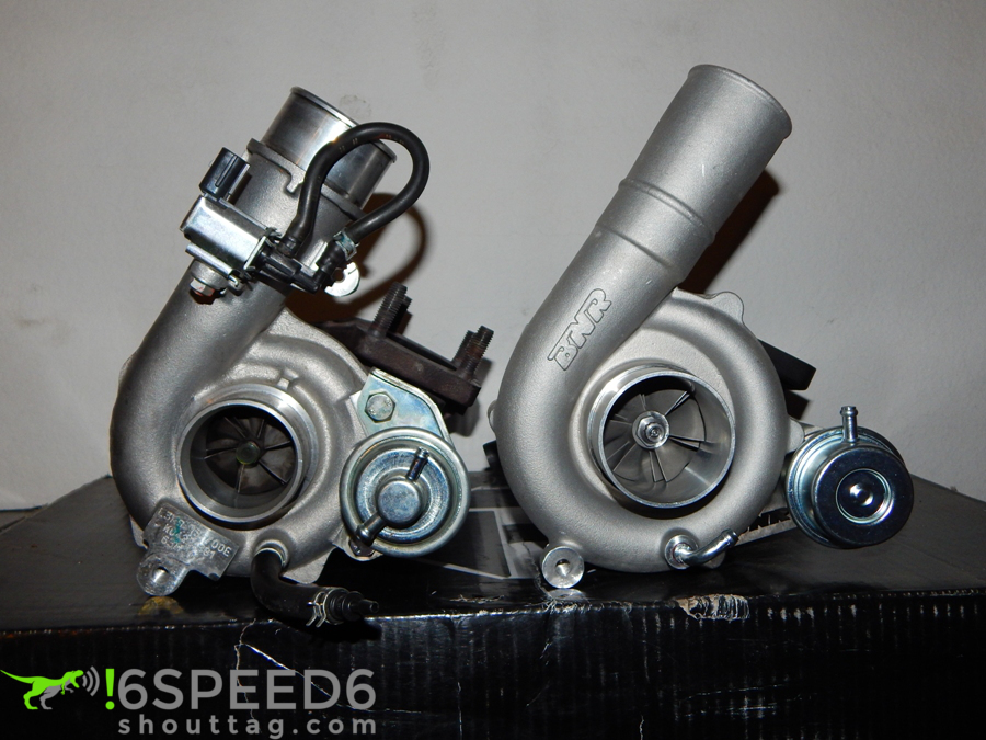

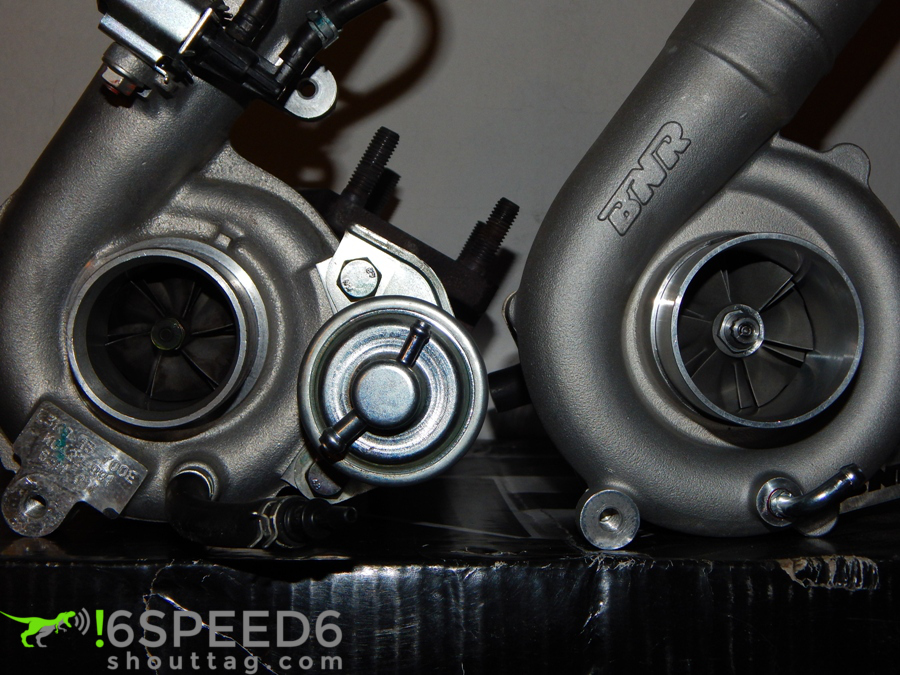

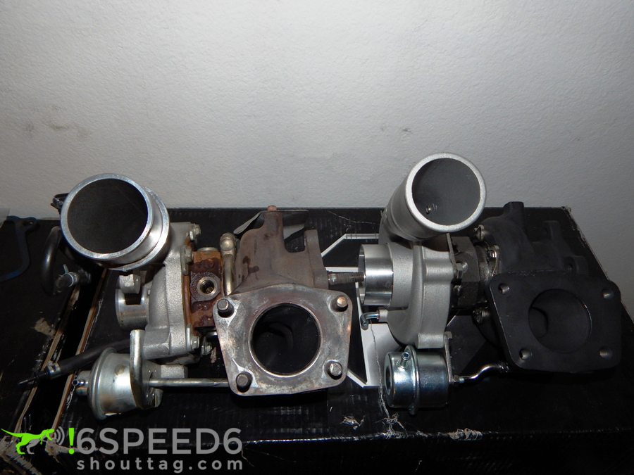

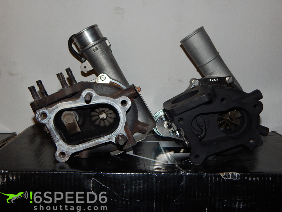

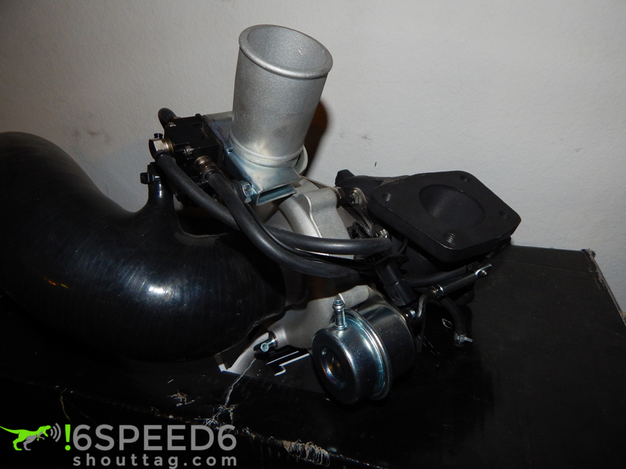

Here's a couple side by side pics of the turbos

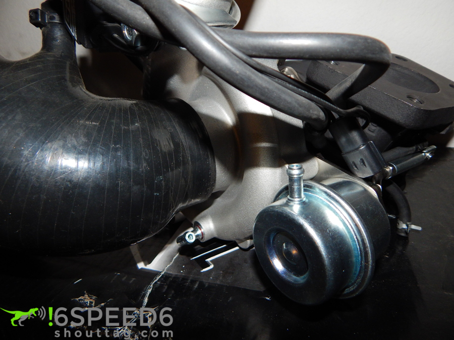

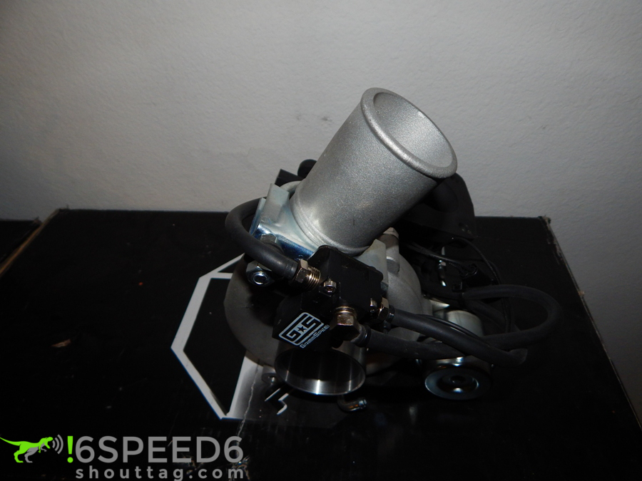

This was my EBCS hack. I wanted the EBCS as close to the turbo as possible, like in the stock location. There's a reason it's there; the vacuum line runs can remain very short. It will also keep my stealth theme going.
Start with a 2" u-bolt from McMaster and thread it on just below the bump in the neck.
That u-bolt is damn near the footprint of the Grimmspeed 3-port EBCS! It goes right on with a couple of nuts. Now I basically have the Grimmspeed in the stock EBCS location. Not bad for $1.99 u-bolt setup.
Finally, I have to say it, I bought the SURE FULL 3 AEROS long before the whole fiasco, but the thing fits perfectly over the BNR inlet. Slips right on like it was made for it.
I should have the new turbo in tomorrow evening after a trip to the parts counter and begin tuning this weekend. I should be pretty well dialed before the dyno day next weekend.

@Rob@Freektune; and I experienced boost creep up to ~18.25 psi with a 0 WGDC. I would be prepared for that.

Make sure to use steel clamps for the ebcs lines and not zip ties in that location due to heat.

Ahhh good point. The pic you see with the plastic zip ties was after I pulled my 3 port off of its temporary home on the firewall. I'll get some clamps also.

@JgamB; check out this sweet EBCS mounting location. Next BNR swap gets this done.

Not after Arthur told me how that solenoid would (not) hold up to the heat. We'll see how Dale fares with it there, it looks slick.

The stock plastic PLASTIC body ebcs with plastic fittings is there on the stock turbo that runs hot as shit. I would say the odds are in my favor.
Well....I actually looked at this quite a bit when I was making these things (and will be doing more in the future for people that need them).
The recommended temperature range is 0-120°F. This is the only reason I'd mount it in a location closer to the battery box.
Edit: For reference: http://www.technologie.com.pl/mac_valves/pdf/35.pdf

If 120F max is the case, the valve shouldn't go in the engine compartment at all. The standard industry rule of thumb is that underhood average temps are 100F+ambient (outside) temp (i.e. 100F + 50F outside = 150, 100F + 90F outside = 190). Granted the temps are probably a little higher near the turbo than the battery box. Obviously we don't understand underhood airflow and how even the airflow is and if there are any hotspots.
If these valves failed at 120F constantly, we would know about it because they wouldn't work in cars. I may be pushing it; I'll be the first to admit it doesn't work if it doesn't. I couldn't find a single case of MAC EBCS failure anywhere in Internetland attributed to heat.
I just can't picture the stocker being more robust than the MAC in that spot...
Only reason I made mention of it is the tuner/fabricator I work with locally (not for my tune) stated it may fail prematurely due to the extreme temperatures, much like an overclocked CPU. I like the idea a lot, and it looks very nice - but I'd rather have 6" of extra vacuum hose and keep it completely accessible next to the fuel pump bracket.
There's a hole in it that shares thread pitch with the provided Cobb bolt, so it's a clean install as well.
Minor stuff, on with the rest of Dale Gribble's outstanding documentation and data gathering!
Yeh I mean. Those are just recommendations. The actual range of the device can be way outside of that I'm sure.
I was simply making the point that I would much rather reduce the risk of failure; I haven't really heard of a failure yet, so maybe it doesn't matter at all.
Also Dale - I see you haven't done a coolant bypass yet (2nd pic). I bought 3/8" coupler at OReillys for $2.50 and my BATs dropped 20*. Whether or not that is because of the sensor location or it's a legit drop, I think it's worth looking into.
The 3/8" coupler will *not* allow the OEM clamps to fit over the hose, but it's also 3 rows of hose barbs deep and sure as shit not coming off without ludicrous force. Go with the 1/4" coupler if you would rather rely on clips instead of man handing the hoses in place.
I kept mine easily reversible just in case of spontaneous ice age temperatures in Alabama, but I sincerely doubt you need the ~200F coolant in your TB.
I'm also going to have to do the coolant bypass. I've had that sitting in my garage forever.

I have read about valves failing due to excessive heat exposure in the past, but they were mounted in close proximity to an exhaust manifold or downpipe. Whether they were MAC valves or not I cannot recall.
Personally, I doubt you'd have an issue. Perhaps a couple layers of Reflect-A-GOLD would be a good idea? Even just for peace of mind.

Thanks @JgamB; I did that bypass a long time ago when I did my derale fan controller mod. I think you're right- it's probably a safe bet.

Or for a cleaner look... do this with the hose than the barb
Throttle Body By-Pass
