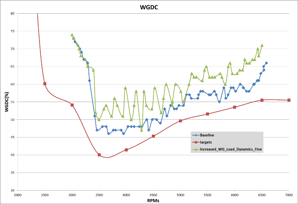

I have been playing around with the Wastegate Dynamics, specifically the Load Error Compensation (coarse) and Fine (Load Based).
FYI, the computer doesn't like too high of Load Error Compensation (coarse) values. It just starts oscillating like crazy. You can see the baseline (blue), which uses lower values and the adjusted map which allows about 25% more WG correction (green). The extra correction just results in WG, boost and subsequent load oscillations. I really wasn't trying to do much here, just experimenting. I was trying to give the computer a little more leeway to reach for load targets, but this is the result.

FYI, the computer doesn't like any Load Error Compensation (coarse) values over the stock mapping.
I don't understand what you mean by this. Are you saying that the ECU doesn't like values that are greater than the ones in the stock map?
With my S3 I've found +4 to +5% and about -10% works pretty well.
Your values are close to mine on the WG adding side and I still have stock values on the overload (pulling) side. My car never goes over targets though since my load targets are at or just above what the car can hit. If you go much above 6%, you'll start seeing oscillations like what I plotted.
