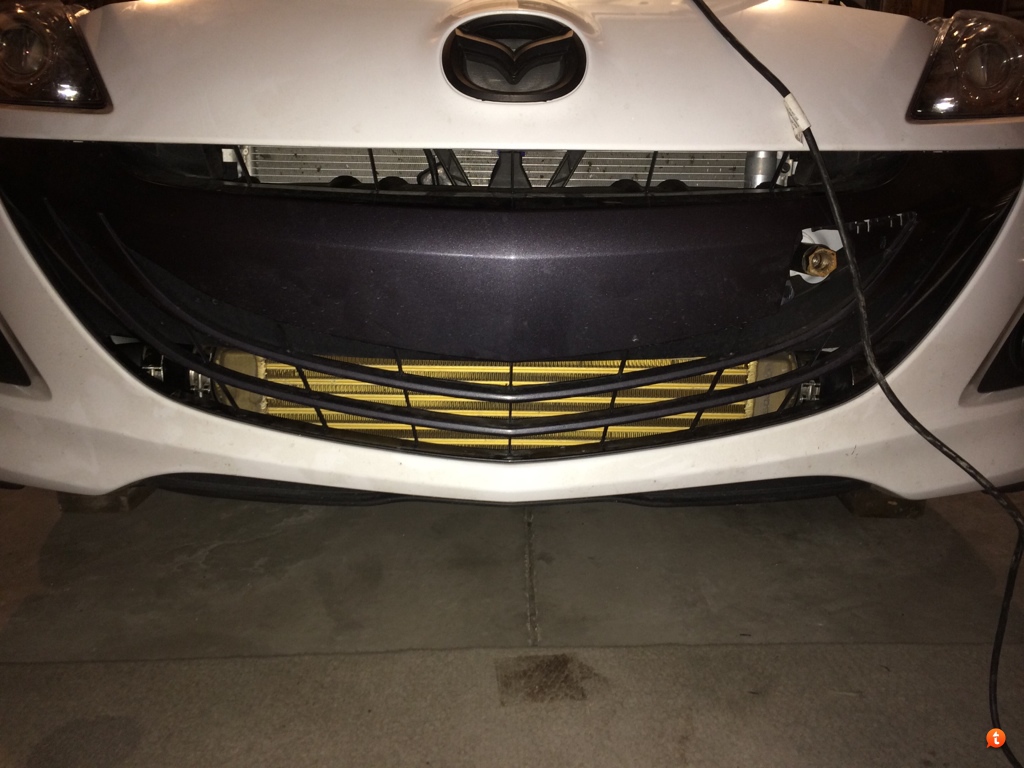

Like you, my end tanks are Reflect-a-Gold wrapped as well. I did some relatively non-scientific testing (not enough trials for there to be any significance to the results), but it looked like my BATs dropped by a degree or two in traffic, at idle, etc.

I had to repaint my spearco FMIC as it was shot so I wire brushed all the paint off the cast top and bottom and the "things" that the air goes thru between the exposed fins (sorry brain dead).
Time consuming but then went and covered all the fins before painting because I did not buy the special paint. After coating everything well I did a few light passed with the fins exposed.
Came out great but I would not have painted the whole thing without covering exposed air cooling fins.
I dont think it would make a huge difference but enough pain and will be less room for airflow and less cooling along with heat transfer issues between fins to paint to air.
And the whole black thing does not make any sense, but ive no reason to get into that. Paint it white and try the argument.
