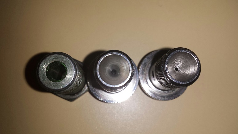

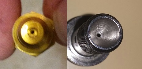

My immediate plan is to not change my setup. Namely no restrictor or filter until some data can be gathered.
IMO a guy should install a pressure gauge in the feed line and measure actual pressure at higher RPMs then compare to Garrett's recommended pressure and install the correct size restrictor if needed.
It could very well be that we are over oiling the GTs but really have no idea by how much. So ATP is erring on the side of caution and so will I.
Maybe when I install my GTX I'll throw a gauge on there and see what's what.

pertinent info from the other thread
holy shitstorm of conflicting information batman!
Garratt says use a restrictor..but only if you are under 40PSI
ATP says..do not use one.
some guys use them
some guys dont
has anyone actually measured oil pressure at the feed line in the upper RPMs?
edit: I see that Garrett wants pressure at least 40-45PSI if lower then the restrictor will increase said pressure in the CHRA.
This may be the same source @rfinkle2 quoted
Ball Bearing Turbo
"An oil restrictor is recommended for optimal performance with ball bearing turbochargers. Oil pressure of 40 - 45 psi at maximum engine speed is recommended to prevent damage to the turbocharger's internals. In order to achieve this pressure, a restrictor with a 0.040' orifice will normally suffice, but you should always verify the oil pressure entering the turbo after the restrictor in insure that the components are functioning properly. Recommended oil feed is -3AN or -4AN line or hose/tubing with a similar ID. As always, use an oil filter that meets or exceeds the OEM specifications. "
Oil & Water Lines | Turbobygarrett

So here are some details on my setup cross posted from ATP/Garrett Hate - failure GTX3076
So while swapping out turbos to get the GTX back in I thought I'd take a closer look at the restrictor's I have on hand.
In the below pic, from left to right you have:
the bolt that comes with a brand new ATP GTX kit, the Garrett BB bolt on e-bay and the Garrett "restrictor" bolt on e-bay.
Its hard to tell but the middle bolt is just slightly larger than the one on the far right. The one on the far right is what I was running on the failed GTX. So I have to wonder, if a "restrictor" bolt is needed, and we see that in Garrett's documentation, why does ATP ship out a new kit with the bolt shown on the far left hand side?
Not sure which bolt I'll use, out of the two on the left, the most restrictive bolt is out for sure. The far left bolt is what I ran my GT28 with for almost its entire life, 20-25K miles and I just ran it for 2 weeks as a temp with zero trouble - it runs like new. The middle bolt was run on the GTX for a while then I ran the most restrictive version for just a few K miles.
anyway I thought it would be good to have more data on this subject.

Here is a pic of a restrictor my buddy is running on his GTX3582r in his bugeye.
comparo to my smallest restrictor.

Turbo type:GTX3071r
Restrictor used: no restrictor using Garrett Turbo BB low profile banjo bolt
Failure Mode: CHRA bearing failure
Oil feed line used: OEM
Oil return line used and if modified for length: OEM modified (cut accordion section out and installed 5/8" steel braided hose to allow better flex.
Vendor Purchased from: original owner purchased from ATP
Answer/resolution from vendor or manufacturer: CHRA exchange with ATP for $742.49
Symptoms: nails on chalkboard sound when turbo experienced any load.
Turbo mileage: 20,000-30,000 miles between two owners
Turbo failure after blown motor: no
I did have some compressor wheel to housing contact. There were some brazing marks on the housing but I was able to smooth it out with some 2000 grit wet sand paper.
