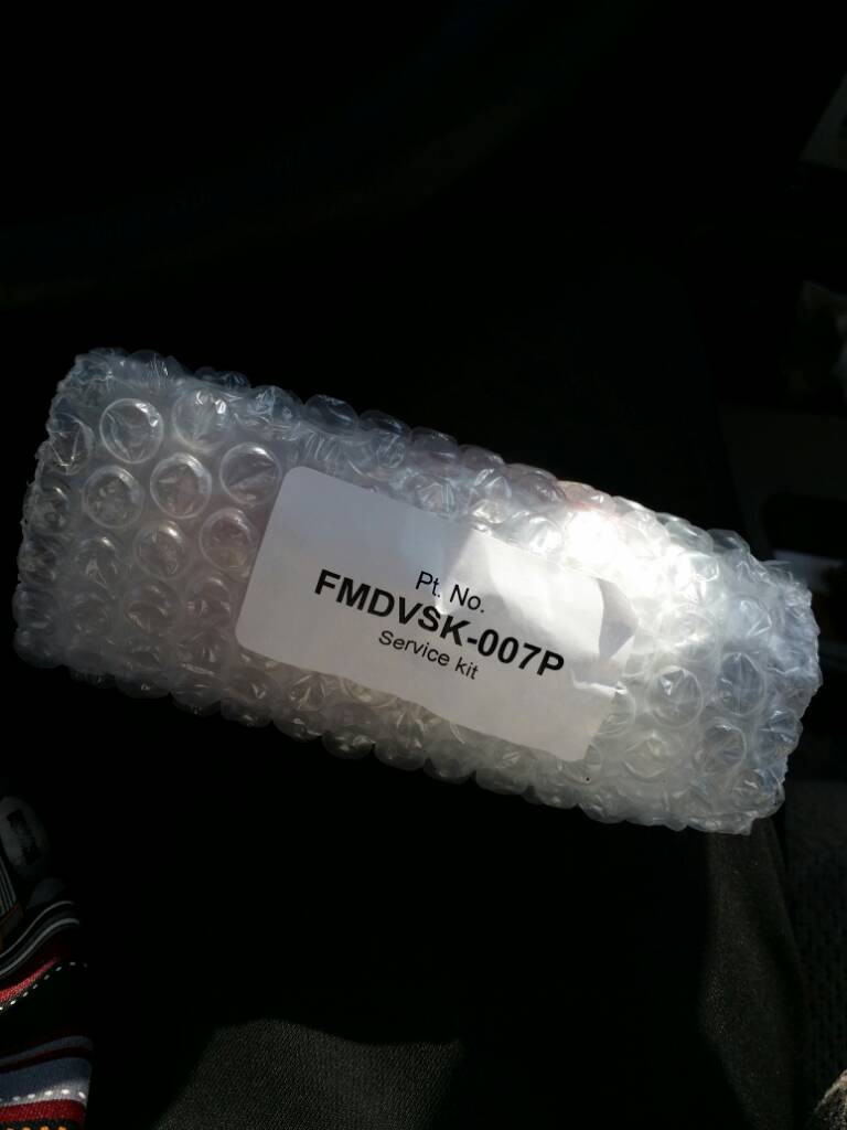

 Old 08-29-2014, 02:28 PM   #20
Jeff23spl's Avatar
Location: Quebec
Posts: 2,233   (View Stats)
Thanks: 161
OH already ship !
1993 Ford Probe KLZE 143dB
1989 GM 6.2 diesel pickup
Wife drive 2010 CX7
...Because French Canadian...
Scare Dem (08-29-2014)
 Old 08-29-2014, 02:37 PM   #21
Jeff23spl's Avatar
Location: Quebec
Thanks: 161
Money sent!
Wife drive 2010 CX7
 Old 08-29-2014, 02:44 PM   #22
Scare Dem's Avatar
Location: FLORIDA
Posts: 1,505   (View Stats)
Rep Power: 1419
Thanks: 2,235
Thanks you!
