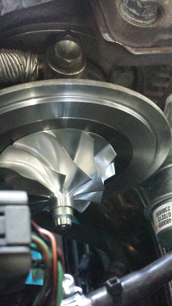

Heres one to start
Angle isnt perfect but you can see the WGA could be moved closer to the comp, bying clearance to the FW.

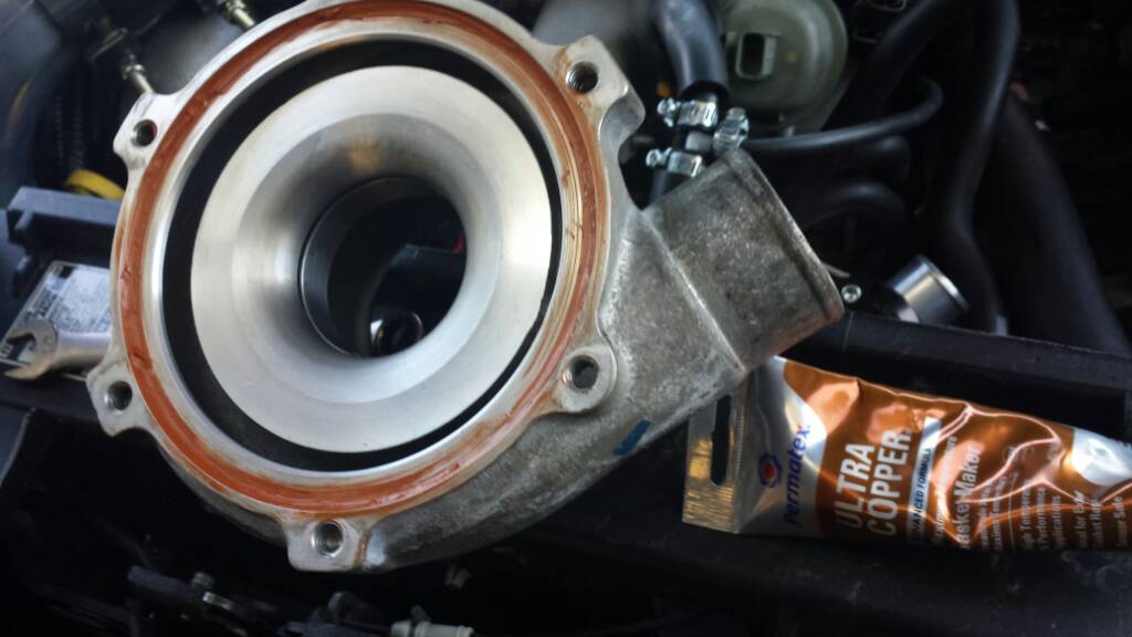

No gasket that seals the surface connection..
So I used a very thin layer of high temp RTV...
Im not saying you will have this problem, but I sure did.

Originally Posted by Nel Mazdaspeed View Post
This is what happened to me before I used the RTV.
I sealed up as well.
Then had to detorque the comp side and use a pipe to rotate it 5 deg to clear the boost toobz
Grrr
Here was my IWG port, eventually went 44mm TiAL MVR and blocked this port with a Cobb IWG bracket
Guardian Angel and a fast synapse BPV and hope

Thats the plan, I was going to splice it, but If I can decrimp one end, thats mo better
Is that crack common?
that 38 you mention, that leads to what? screamer pipe?

So, the OEM return line is a larger bore than the braided line, but know this, that flange has to be drilled out to accept the 5/16 screws in the ATP chra, I don't know what variety, but it is a work hardening stainless, and you will need carbide to do it. Also, the pipe ends don't face each other perfectly and kinked a bit on a rebend. In hindsight, I would flat grind the flange face at a slight angle to get the bulk of the mismatch corrected
with a simple bracket and wire, I was able to keep the WGA rod free from blanket interference
I am now reasonably happy wiht the WGA mechanical geometry, you can see the new WGA bracket finished next to the supplied bracket, and mounted up
The support bracket will be, using a long stud, clamped against the DP's nut. that is not ideal, granted, but I could not come up with a better, practicable way
