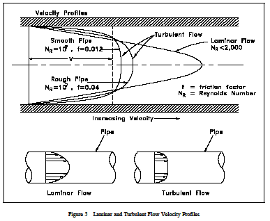

Here is some info they posted about how honeycomb is used in windtunnels to help make flow more laminar
Wind Tunnels - Honeycomb
The restriction of the material seems to be somewhat beneficial. Incoming air is a fluid it will take the easiest path. Which will have a normal distribution within the system like the natural flow image below.
The honeycomb cell placed in the location of the previous easiest path restricts it a %, but instead of losing that flow volume, it is displaced to a previous difficult path cell. Making a more consistant flow across the entire system.
I noticed this playing with a few dozen smoke bombs. Here the system is open and the smoke lazily takes the course to the fan output.
With the cells in place it is all business, the air sweeps in fast, goes directly down. One of the wind tunnel sites I have read said once you "straighten" the air and remove all the tiny eddies, and the distribution is even. It is much easier to control. For corners and such.

I wouldn't see this as much of a restriction. But you definately have the right idea. You have the proper length channels to create that nice laminar boundary layer in each channel.
I would have to look it up, but to create nice laminar flow you need something like a channel length of 4x time the diameter of the channel. I would have to research that. I drank all my knowledge of engineering away.

I'm going to preface this post by saying that i am the wind tunnel engineer at freightliner trucks.
I would say that the edges are the area where you should be least concerned. The maf is located center of flow so the edge effects wouldn't really make it to the maf. Especially if the straightener is close to the maf inlet. That's really the whole point, to eliminate turbulent flow characteristics, which are mostly caused by boundry layer development.
However, the turbulent region in the intake tube is probably most likely caused by the non uniform intake material (aka cone shaped filter going to tube shaped maf housing). You can imagine the not so smooth course that the air has to take to get to the maf.
Basically if your maf is close enough to your straightener, you should not see any turbulent effects. In the wind tunnel, we have a 1ft thick straightener for a 40x40ft intake and we can't measure any turbulent region at the straightener outlet. To give you an idea of turbulent boundry layer growth, we see a 10 in deep boundry layer at the bumper of the truck which is 100 ft away from the straightener outlet. This is all at 60 mph of course, and the boundry layer growth will be much greater at inlet air speeds.
But that's still at the walls of the maf housing.
Cliff notes: do it, it will work.

@lucz0r would that boundry layer around the inner circumfrence of the tube, say the outermost 20-30% of the ID have a much lower average flow velocity than the innermost 20-30% of the tube?
If that was the case then the crushed part of the straightener around the outer edge would have almost no negative impact on the flow.
Also you mentioned that your wind tunnel uses a 1' thick straightener, for a tube with a 3-4"ID and intake velocities less than 450mph, is there an ideal thickness for the straightener?
And last could the stem that holds the maf electronics be creating its own boundry layer with a thickness that increases in proportion to the intake velocity? If thats the case then maybe it would be a good idea to build the straightener around the maf stem such that maybe the boundry layer will be distributed across the entire ID.
Thanks for posting in the thread, it just got alot more interesting.

Its important to note that at high flow rates, the reynolds number in even a big maf car is very high, indicating that the flow is a fully developed turbulent flow. I did the calcs awhile back when I was proving why the "straightener" in MSCAIs are for improving maf stability around idle, not at WOT. I can dig up the spreadsheet if needed.
Airflow "straighteners" would be more appropriately called turbulence inducers as the reduce the effective diameter of the pipe in the vicinity of the MAF. Those airflow straighteners in windtunnels are for recircing windtunnels, which typically have low flow velocities (ie laminar flow)
[lengineering diatribe]
MAF sensors are based upon the amount of cooling a resistive wire wire receives. The amount of cooling is directly related to the mass of air passing by the wire, but only is valid if the flow remains turbulent. If the flow is slow enough, is starts to fall out of a turbulent flow near idle, causing eddies to develop and the equations that relate the cooling of the wire to the amount of massflow to no longer be valid. This screws royally with the fuel trims. Larger pipes lower the flow velocity, causing it to drop out of the fully turbulent range earlier. The MSCAI has a larger MAF diameter than stock and the bend before the MAF tends to organize the flow making the problem worse, thus requiring the "straightener"
[/engineering diatribe]
Ziggo is right about the Reynolds number being really high. It is a low density fluid in a high speed flow characteristic. However, the air straightener reduces the Reynolds number. It decreases hydraulic diameter of the pipe, which if I remember correctly is in the top of the Re equation.
As for the maf using turbulent air to cool the wire, I'm pretty sure they are talking about the region immediately around the wire itself. I do not think this is a concern for our maf since the wire is not located directly in the free stream, although I don't exactly remember where that wire is... I just remember that plastic extender with the wire "in there somewhere."
As far as air straighteners in wind tunnels, we use an open loop system as opposed to closed loop (recirculating) and still utilize an air straightener for obtaining laminar flow and eliminating boundary layer.

The wire is located in the free stream, its inside that plastic extender. The plastic on either side is to help lower the effective diameter of the pipe around the maf also. The whole basis for a MAF operating is that wire sitting in the free stream. If it gets even crud on it, it wont work very well and thats when you hit it with the maf cleaner. As for the air straighteners eliminating boundry flow, they do this by INTRODUCING TURBULENCE. Its why golf balls have dimples, its why race cars use diffusers, and why ricers put those stupid little triangles on their roof (even if they don't know it) Turbulence cuts the boundry layer and reduces drag.
The characteristic length that goes on the top of the RE equation is a minor player compared to the velocity term that also goes on top when talking about pipes. Velocity increases as a pipe gets smaller much faster than the pipe diameter drives it down. I have linked the spreadsheet below, check the math if you don't believe me, change the pipe diameter around and see how it changes the "RE" column. Note the temperature above the columns is the IAT temperature.
If the RE is less than 2300 you are getting laminar flow. If it is above 4000 you are getting fully turbulent flow. The in between is like the eddies behind a paddle in the water, which can be organized by bends in the pipe making the MAF freak out.

Ziggo is once again correct on all accounts. However I think he is over looking some small points when it comes to the Reynolds Number. He is absolutely correct that the velocity grows much more rapidly as the pipe diameter decreases. This is due to the fact that the velocity of the air is dependent on a Velocity*Area constant, ergo, as the area decreases, the velocity must increase proportionately, and since the area of a circular cross section is pi*r^2, the velocity must increase at a squared rate as compared to the decrease in radius.
However in the case of a straightener, the area does not decrease very much since the material of the straightener is extremely thin. BUT the effective diameter (characteristic length) is greatly reduced from the diameter of your big fat maf housing to the size of the holes in the straightener. But Ziggo makes a good point, this alone will not drop Re below 2500 and achieve laminar flow. Not to mention the fact that Ziggo did not account for the dynamic pressure drop due to suction (which I would be quite surprised to see since it's almost impossible to calculate) and the consequent drop in dynamic viscosity.
But, once again, I feel Ziggo has overlooked some small details. In the case of turbulent flow, there is a rule of thumb that explains how long it takes for internal flow to become fully developed, which is 10x the pipe diameter. What this means, is that the effects of the straightener will not disappear for 32.5in.
The effect that the straightener has is to cut down the size of turbulent vorticies in turbulent flow. The smaller vorticies will have less pressure and density difference within them and will tend to neutralize since the they are moving in parallel. Boundary layer effects will not affect the flow in the center till 10 diameters.

I don't really get your point. My point was that these things do not affect MAF stability at WOT, they improve it around idle. There are no "eddies" in a fully turbulent flow to make the MAF freak out, and you can see that the RE numbers are nowhere near the transitional borders at WOT like MAF flows.
I am not trying to engineer the next delta rocket here, and I don't believe these equations are 100% accurate or that I have accounted for all effects, but the results are very clear and the basic physics all point in the same direction. At 100g/s RE values are in the order of 125K, and reducing the effective diameter in a pipe increases turbulence. (increases RE)
The MAF straighteners will tend to flatten out the velocity profile in the pipe, is this what you are talking about? I don't see the velocity profile affecting MAF stability as while the profile would throw off the sensor, it does it in a repeatable way that could be accounted for by trimming the sensor with the MAF cal tables.

I think the problem is we are confusing laminar flow with an evenly distributed velocity profile. And we need to realize that we need a fully developed flow to be able to achieve a consistent reading.
So who’s ready to bust out some navier stokes equations? Joking fuck that short hand heuristics>>fucking theory any day.
And looking back at some of my engineering books, it turns out turbulent flow is not such a bad thing. Really it is a good thing since we are creating a uniform velocity profile. In laminar profile the greatest velocity is at the center of the pipe decreasing exponentially across the radial axis. Use navier stokes equations if you really want to find the exact profile. But the picture below shows the velocity profile as we digress from laminar flow to turbulent. As we become more and more turbulent we see that the velocity profile becomes a straight line where at any point the velocity will equal the average.
So then if we already have turbulent flow as shown by Ziggo, then why do we need an air straightener?
This is because flow is not necessary fully developed turbulent flow. So any inconsistencies (ie. bends, bungs in the pipe, any non-conformity) will cause disruptions. These disruptions cause eddies and other irregularities. So now we have to ask how much time will it take for these irregularities to go away. In fully turbulent systems
The entrance length can be expressed with the dimensionless entrance length number expressed as
El = le / d (1)
where
El = Entrance Length Number
le = length to fully developed velocity profile (m, ft)
d = tube or duct diameter (m, ft)
We want to find le , we already know the diameter of the tube. So we need to calculate El the entrance length. The equation is found below.
Elturbulent = 4.4 Re^1/6 (2)
So say we are just cruising at low flows well say we have a Re of 5000 then plugging and chugging we get an El of 18.2
Now to get the le (length for fully developed flow) we use equation 1 and assume a diameter of 3” tube
18.2=le/(3”)
Solving le=54.6”
So to get a uniform flow before the maf you would need a pipe that is 54.6” long. And this pipe has to be straight with no obstructions. So obviously that is a little too long and unreasonable. So how bout we throw an air straightener and reduce the effective diameter. We’ll use the same Reynolds number assuming it is constant up unto the straightener.
Then solving for the effective diameter is. We’ll assume the diameter of one of those cells is one tenth of an inch
18.2=le/(.1”)
le then equals 1.82” so then the length of those small channels will need to be 1.82” long for fully developed flow
And really it doesn’t need to be 1.82” I’m sure if we looked at the actual equations instead of heuristics we would find that even a length of 1” will probably get you like 95% fully developed flow. No doubt that the equation is exponential.

Excellent, now I am on board. I never thought about the velocity profile or entrance length till I started questioning myself yesterday and you just proved my suspicions. The more turbulent the flow, the longer the entrance length will be, and while a honeycomb will increase the turbulence, it will also significantly decrease the entrance length.
In summary: The flow in the pipes is turbulent and should remain so.
MAF straighteners have 2 benefits: they increase turbulence at low flow rates to keep the flow turbulent at low loads, and decrease the entrance length at all loads to remove the effect of bends before the MAF.
Now we just need 06speed6 to prove the theory. I will add an entrance length column to my spreadsheet so he can figure out his spacing.
