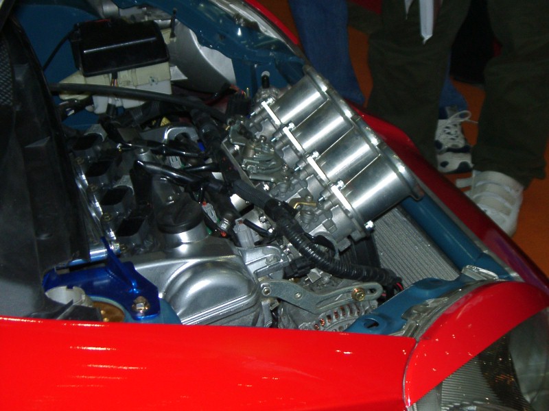

Also, please put ITBs on that thing.

Yeah, I've been drooling over those lately...
