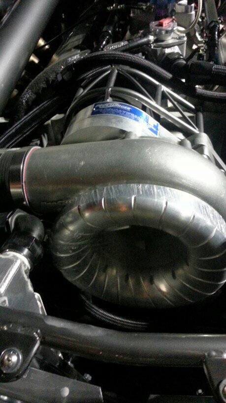

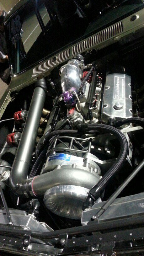

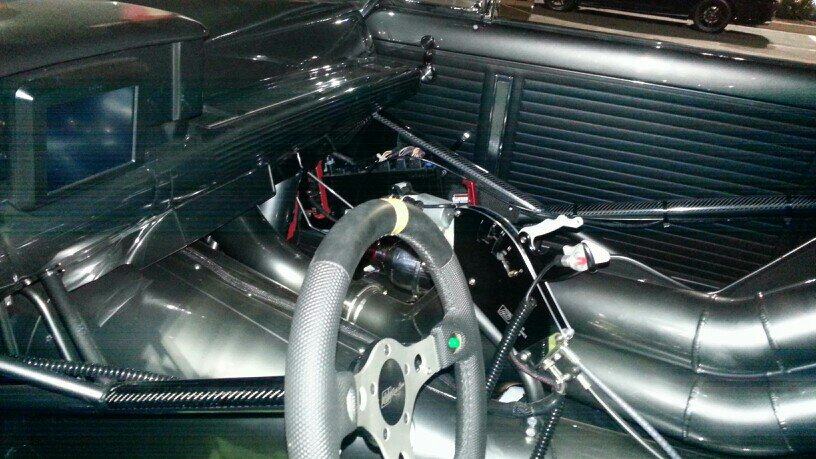

 Old 10-18-2013, 11:07 AM   #12
Matrix311's Avatar
Location: Tempe, AZ
Posts: 2,133   (View Stats)
Thanks: 13
So you want to run a setup like this? I saw this at a local car show last Saturday and this guy is pushing out 2,250whp. It's pretty insane!
Oh yeah and check out this video. Just listen to that thing spool up when they show the video of the rear of the car.
