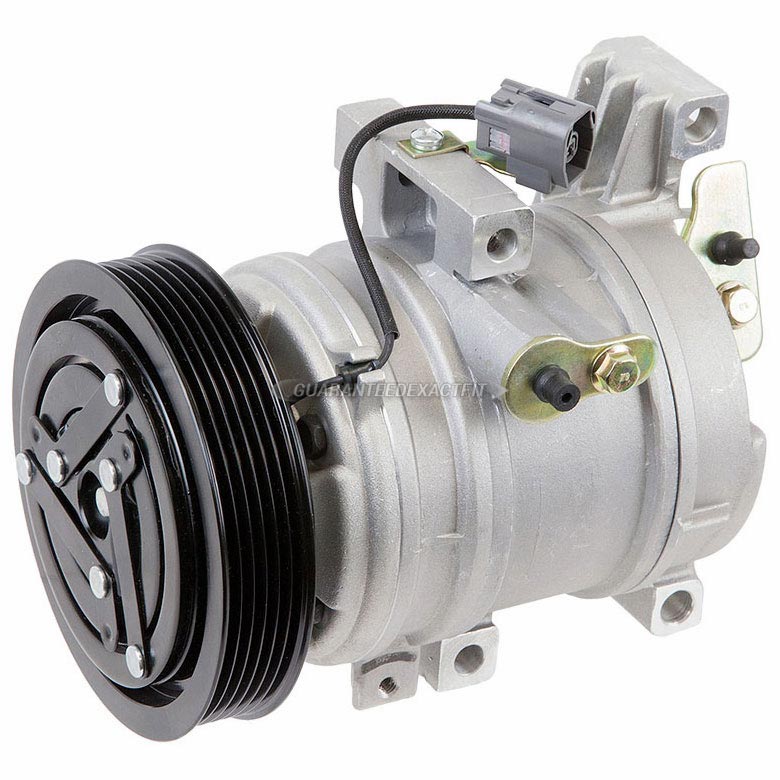

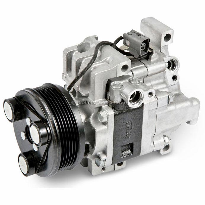

Got a question for you guys. I had a speed3 but sold it before I got a chance to put in the replacement AC compressor and clutch assembly I had bought.
A year went by and I decided to sell the part on ebay to a mazdaspeed6 owner.
Their mechanic said the part was different and wouldn't fit.
There seems to be 2 different styles of AC compressors. Can you tell me which one you guys have on your speed6's? I've actually seen references to both.
129mm clutch:
105mm clutch:
Thanks.

Bringing this back from dead (sorry), but does anyone know the answer to this AC compressor question?

Pretty sure the bottom picture is what is in a speed 6, I have to gen 1 speed 3 and that's the one I have in my car

Yep. I just ordered a replacement and that's the syle that showed up.
