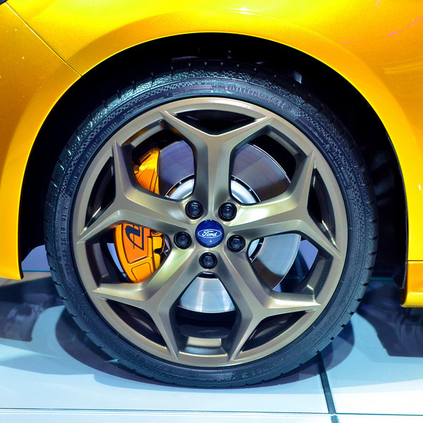

The ST they've been showing on the auto show circuit has what looks like body-colored multi-piston ATE front brakes, along with some pretty trick-looking rotors:
Stance is not a verb.
2008 MS3 GT
2016 MX-5 Club
Lex (02-25-2011)
 Old 02-25-2011, 04:06 PM   #20
That's a pre-production module IIRC. They really don't have much reason to have more braking than we do for 250hp. I'd rather see a Torsen diff and revo knuckle.
EDIT: How do you know those are multi piston?
 Old 02-25-2011, 04:47 PM   #21
Nliiitend1's Avatar
Posts: 5,749   (View Stats)
Rep Power: 4020
Thanks: 10,876
I don't, which is why I said "looks like."
I'm basing the assumption off of the overall shape of the caliper, which follows that of a typical multi-piston unit. Also, several publications have referred to them as "multi-piston" as well.
...and I know it's pre-production, which is why I referred to it as, "The ST they've been showing on the auto show circuit" and not, "The ST."
While our cars don't need any bigger brakes, we track rats could still certainly benefit from the added heat-handling capabilities and pad wear profile of a multi-piston setup, and I'm sure the ST would benefit in the same way.
When I was at the DC auto show they said they were 6 piston in the front, and 4 piston in the rear.

I had heard that the rear was just a fancy-looking single-piston unit, which is what it looks like to me in the pictures...
Also, I'd be pretty surprised if those front brakes had any more than 4 pistons in them.
I guess only time will tell what the final production version will get.

I had heard that the rear was just a fanvy-looking single-piston unit, which is what it looks like to me in the pictures...
I just looked at the pictures I took at the DC show to make sure it was the same model they've been showing everywhere else, and it was, so yes I agree with you on thinking those rears are single-piston.
I asked the people I went with if I had been imagining that they claimed it was 4 in the back, and they also remembered them saying that. Not sure what's up with that, maybe the actors they hired to talk about it just didn't know wtf they were saying.
Wish it hadn't been on that rotating podium so I could have gotten down and dirty checking out the suspension and braking components.
