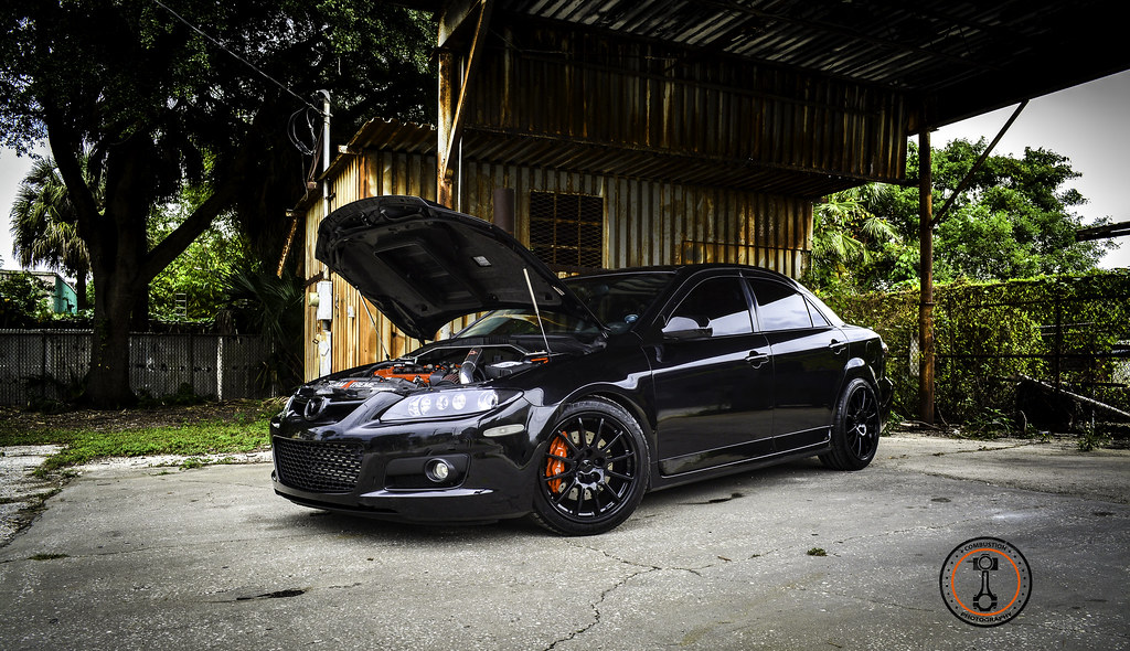

Just have the mounting ears of the caliper machined like I did, it is much better than using a spacer behind the rotor IMO.
How many of you have been running the Brembos for a while? What are your thoughts on them still? I am about to hit 15k miles since putting them on and I love them still. The feel, the look, etc..
I did paint them gold recently though.

Mine have only been on for 8 months or so but I still love them! I never get tired of looking at them.
:: Gusto :: and vortk355 like this.
