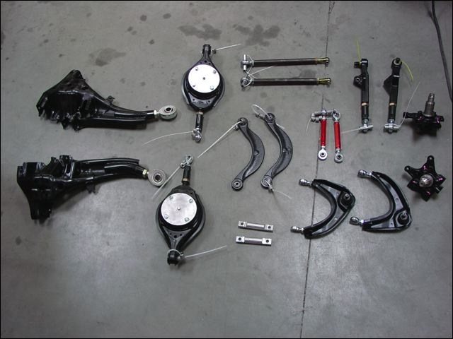

Have you seen this thread? I didnt read much and may not be any good info. However the pic is very interesting:
http://www.awrracing.com/proto6/images/image92.jpg
I haven't seen that, but similar things have been done with other cars. It's not an option for me due to class rules.

Yep, the orange material is similar to OE hardness. I daily mine without issue. I had the rear suspension apart today and checked out the ones I installed last year. They look great, no tearing or cracking.
I finished up the rear suspension:

What do you guys do with all the play/adjustment in the subframe bushings? Seems like if you install if wrong your alignment will get all messed up. I know I am not sure if I lined things back up correctly when I lower it.
Obviously a proper alignment shop would know how to do deal with this but not Firestone. I guess it is to allow for adjustment of the rear LCAs?
