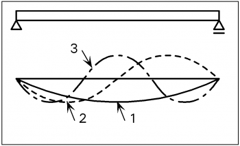

New sway bar testing ... I found some text results from when I modeled an Eibach sway bar for one of my cars, using a "simple beam theory" program. It reminded me that for a long slender bar like your new one, there is a contribution to lever-end deflection due to torsion bar slope at tube ends. If you transpose the applied point load to a force and a moment on the axis of the torsion rod section, the bending moment in question is based on the distance between the transposed force and the support bushing center (due to the dogleg in the lever arm). This puts the rod in "second mode" bending, with added deflection due to the slope at the ends:
A simple manual dial indicator at the "hump" in the torsion rod position would capture this effect:
http://i21.geccdn.net/site/images/n-.../TLS_53304.jpg
This effect was small in the more typical bar I had modeled, but your bar is much more prone to this, based on geometry.
Right, it's just an overhanging load of equal and opposite forces at each end of the bar. I've been meaning to revise my theoretical spring rate calcs (not previously posted) for the bar and arms now that I have everything in hand. The shape of the arms was the big unknown, so I should be able to calculate everything now and see how closely it matches the bench rate.
