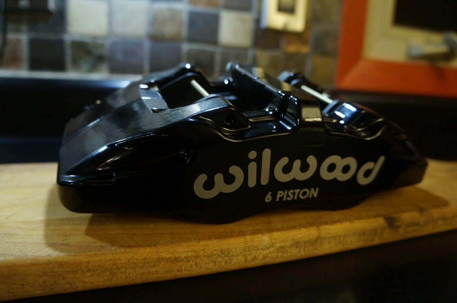

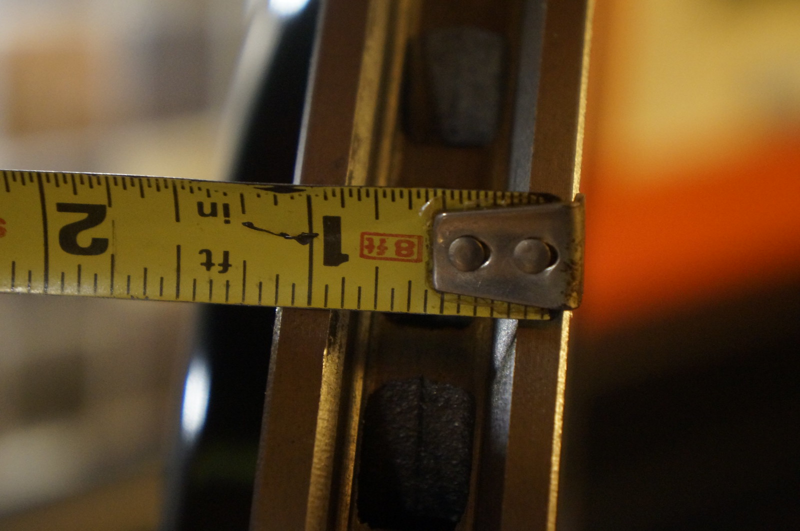

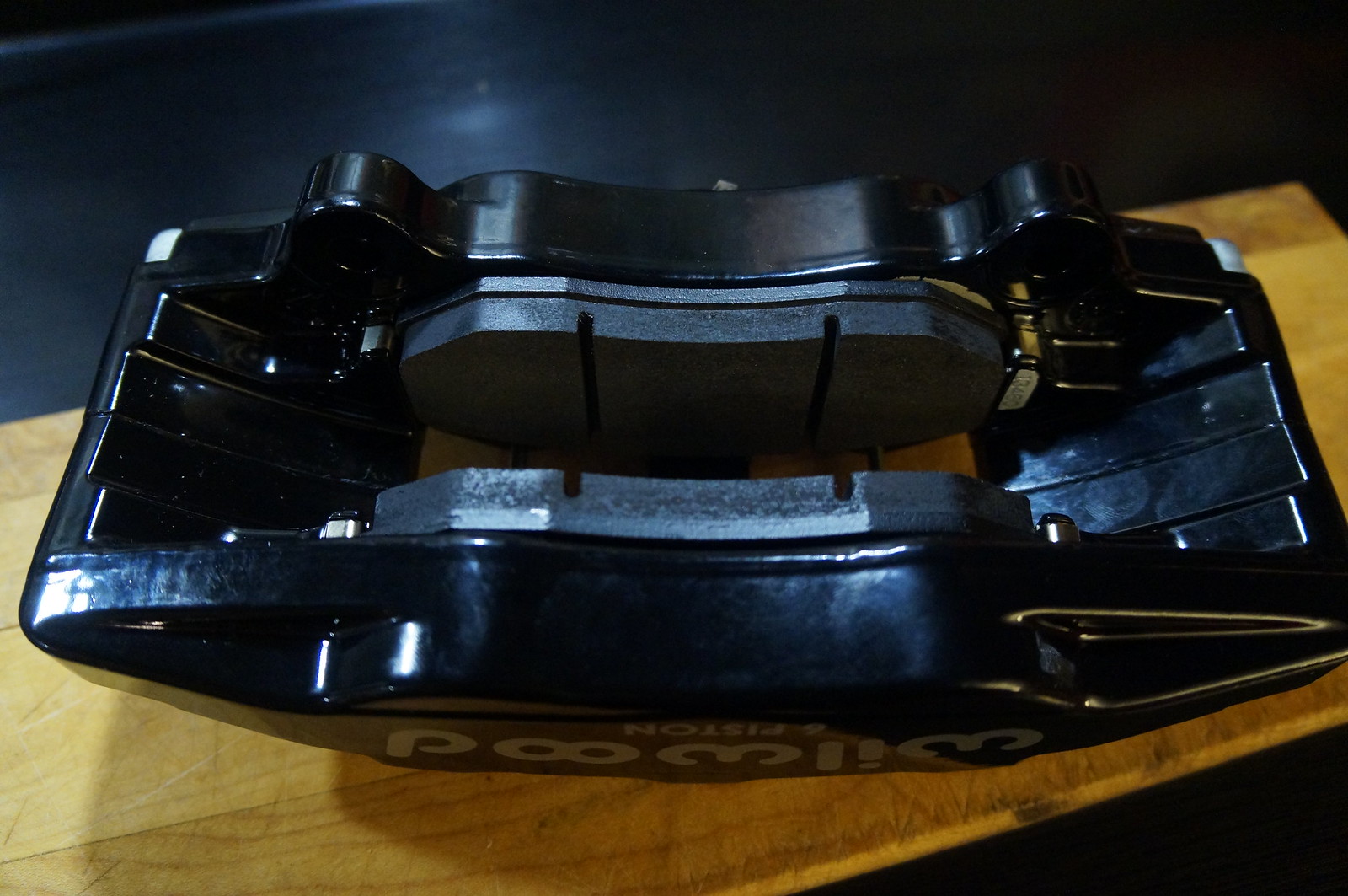

So my Wilwood 6 piston kit came in today, I figured I'd take a pile of detailed pics you you guys

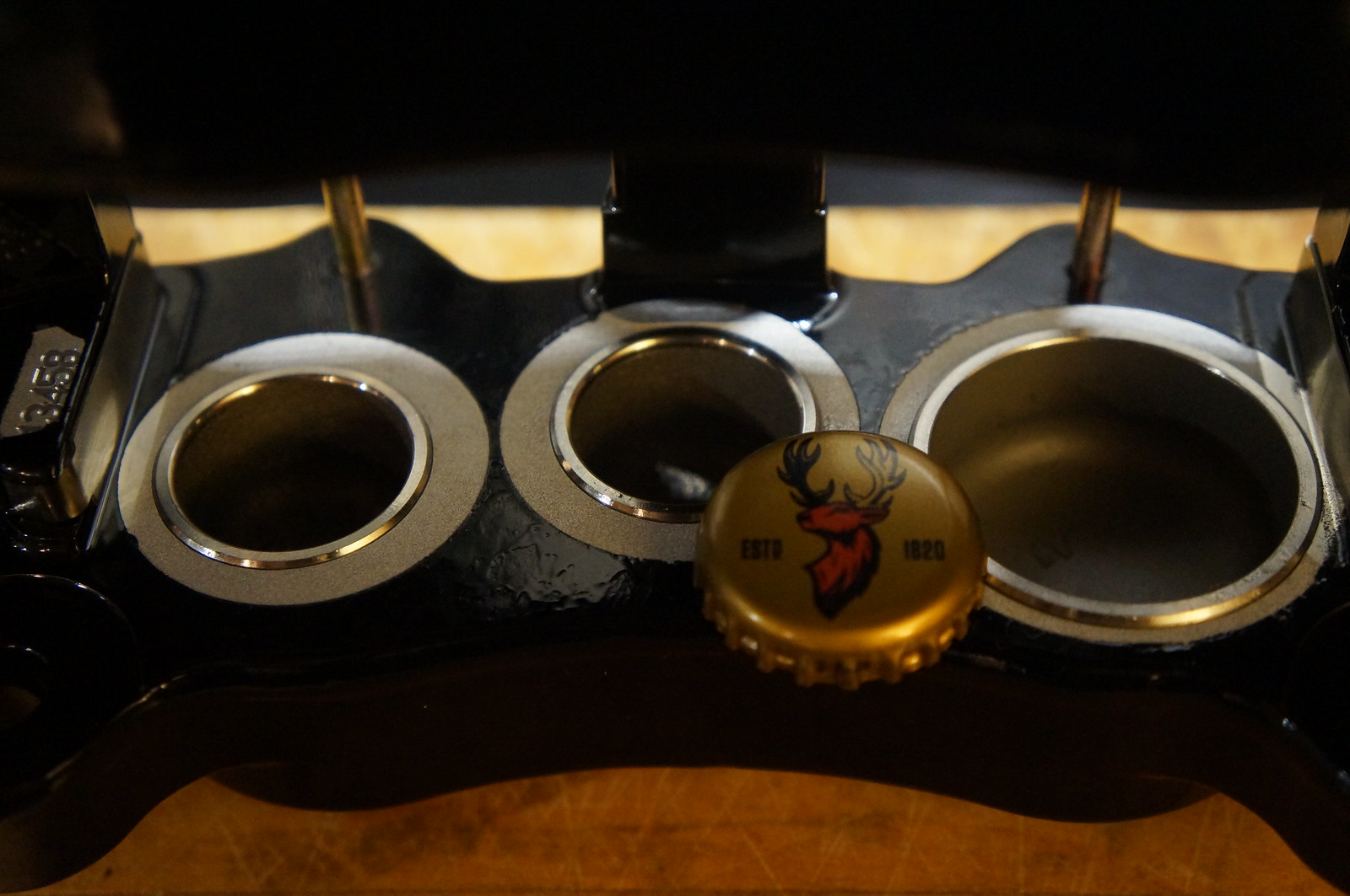

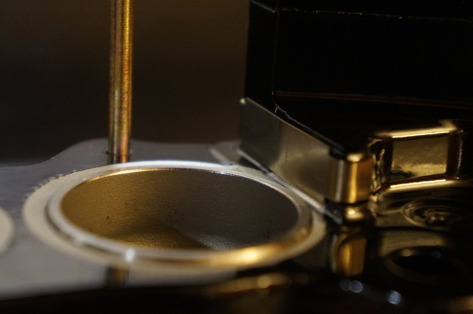

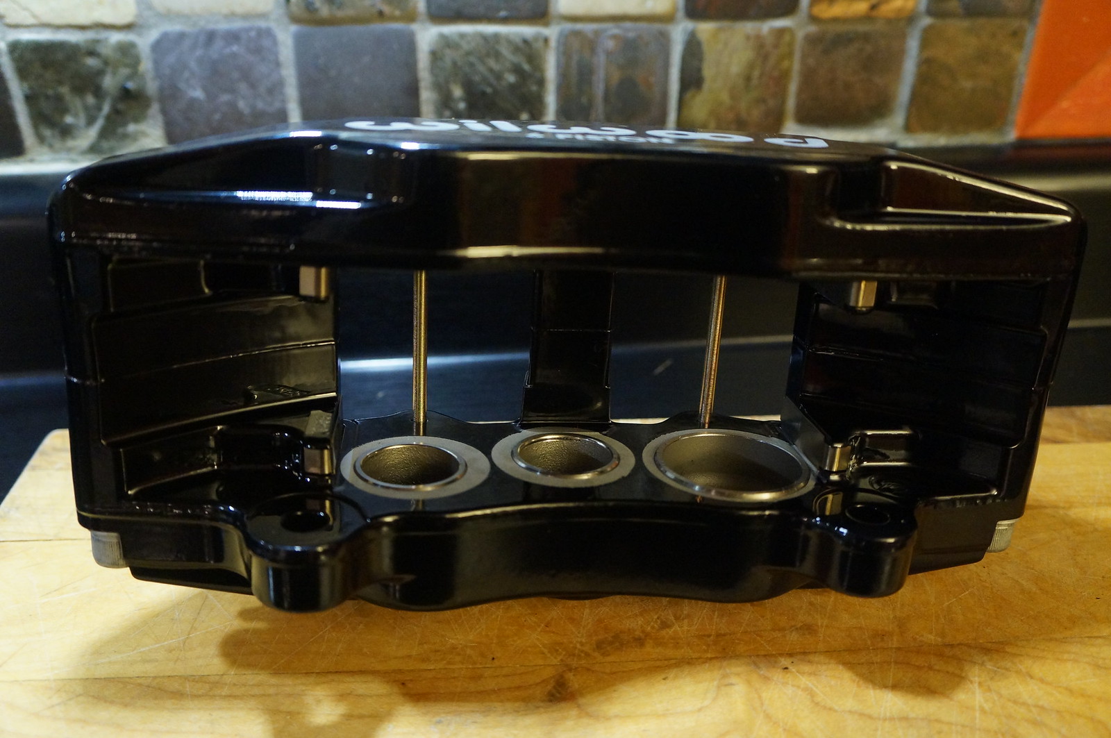

Some very nice looking stainless steel pistons

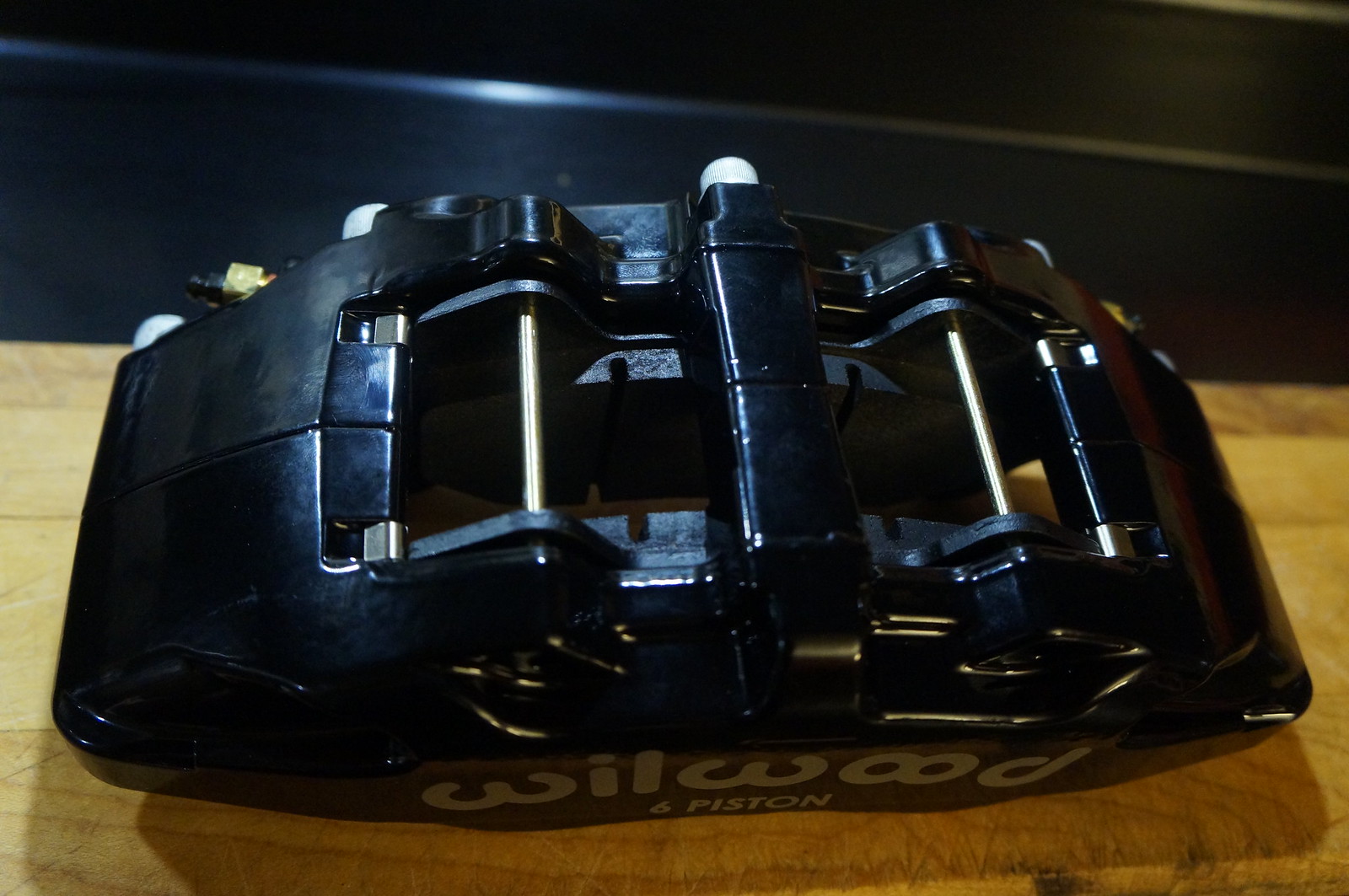

Brake pad pins are removed by popping out these little C-clips

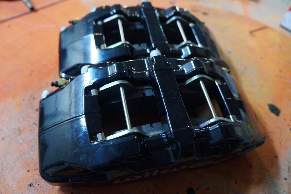

Size comparison

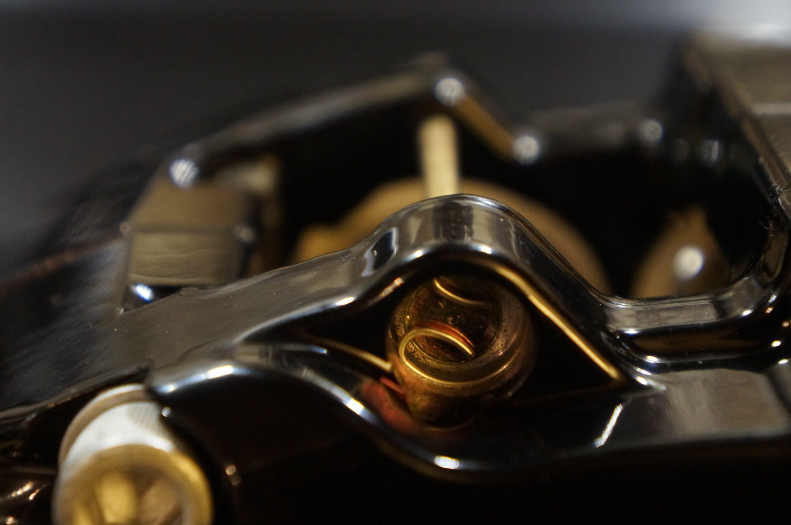

The edges of the pads press into these small compression clips, I'm thinking it's to minimize movement
Inside of the caliper has no cracks or ridges for brake dust to build up in.

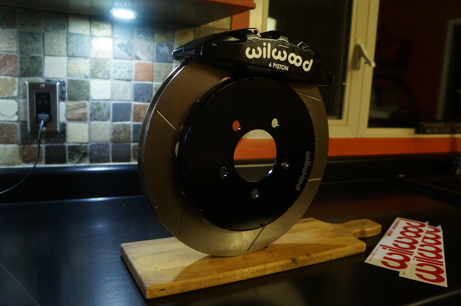

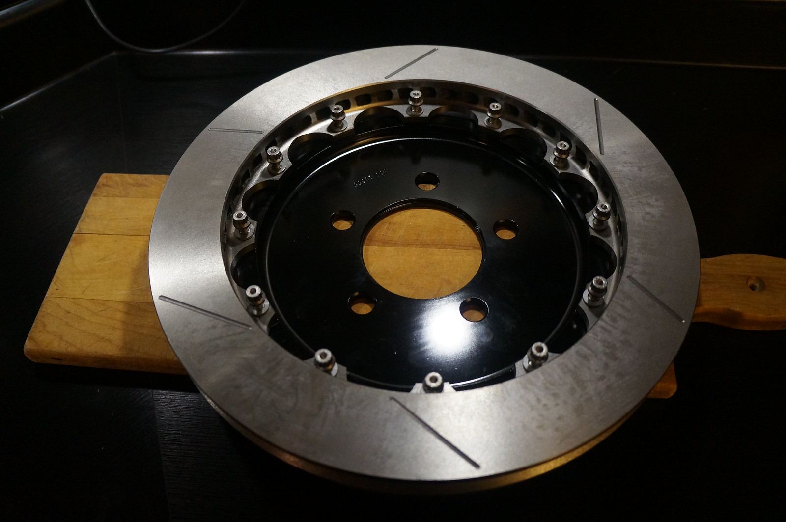

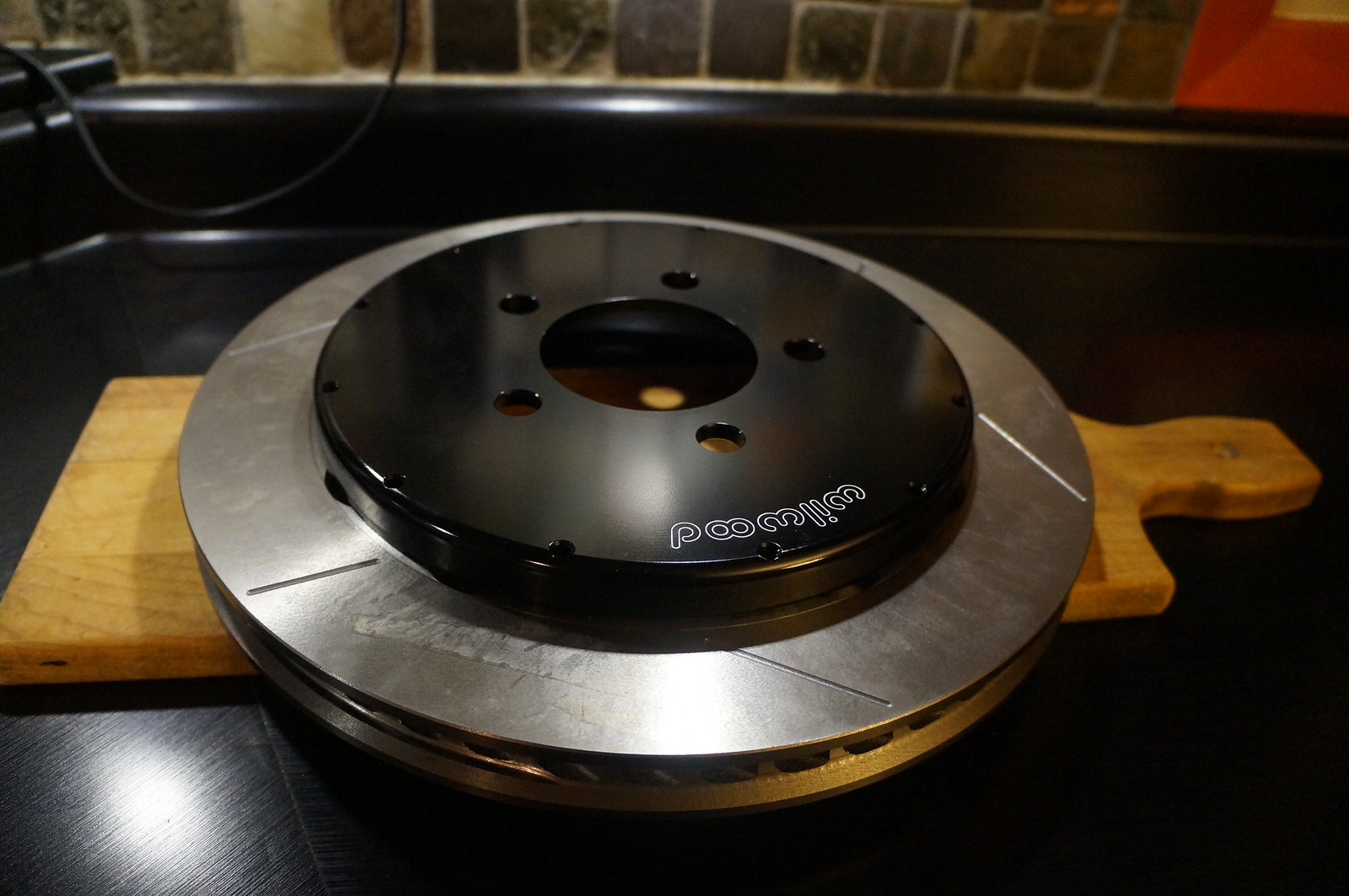

13" 2 piece rotor

Looks nice. But no dust boots. You live in Ontario. Salt may be more than inconvenience.

I'm running the stock setup for the winter, salt would fuck these right up, dust boots or not. I have been in plants that bag ice melt, that is some scary shit that I don't want anywhere near these.
The rotor uses all stainless steel hardware but the rest of the kit does not.

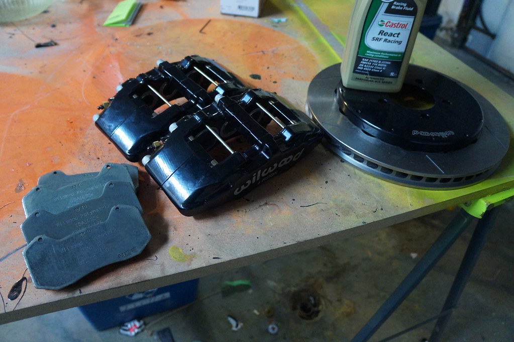

Interesting. My rotors came black...
Tho the install wasn't as bad as I thought. I more peeved with having to use red loctite on everything. Tho I had some issues with my spacers. I'm not sure if its b/c of the ring that wilwood gives you for the hub or not.

Mmmm I spy Keiths! I need to venture back across the border here and get me some

Everything. The bolts securing the rotor hat to the rotor. The bolts on the caliper bracket. Only thing I didn't use loctite on was the brake line fittings where I used ptfe instead of the tape. The instructions called for loctite 271 on every bolt. I have yet to get my car off jackstands to see how well it holds up.
but as you can see my rotors came black.

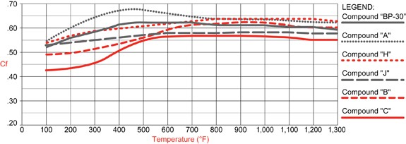

So I'm bumping my own thread, because I can and because spring is coming soon.
I'm buying pads and I'm kind of torn between PolyMatrix A and Polymatrix H. The "A" have a very aggressive cold bite but also has the highest hot friction out of any wilwood pad.
The "H" compound has a very linear bite that gets most aggressive as the pad gets over 700 degrees F. The "A" compound starts heavy bite at well below that and slowly tapers down until it reaches approx the same friction values at the same temperature.
I'm leaning towards the "A" compound because the low temp bite will be great on the street and the description has me sold to an extent as well.
"Race ONLY compound used in ARCA, ASA, ALMS, Grand-AM, NASCAR, REMAX, SCCA, USAC, and other severe duty oval, road course, and off-road series that require an aggressive response and durability in the highest temperature ranges"

Got the calipers loaded with PolyMatrix A's and got some Castol SRF
Will post a review in a few weeks when the weather clears.

Do you plan to use the Poly A for street only? For street the Poly A will eat your rotors. I'd recommend BP-10 or BP-20 for the street. I don't believe in dual purpose pads, too many compromises, so I ran BP-20 for street and Poly B for the track.

No, these will be track pads. I most likely won't bother swapping them around for the summer though.
I don't believe in dual purpose pads either
