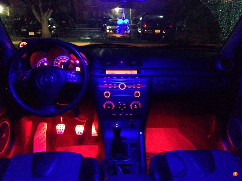

I think I wired mine into the fuse box under the glove box. Our cars share a common ground instead of positive. It's kinda weird I'll take it out and get some pics after work unless you already figured it out.

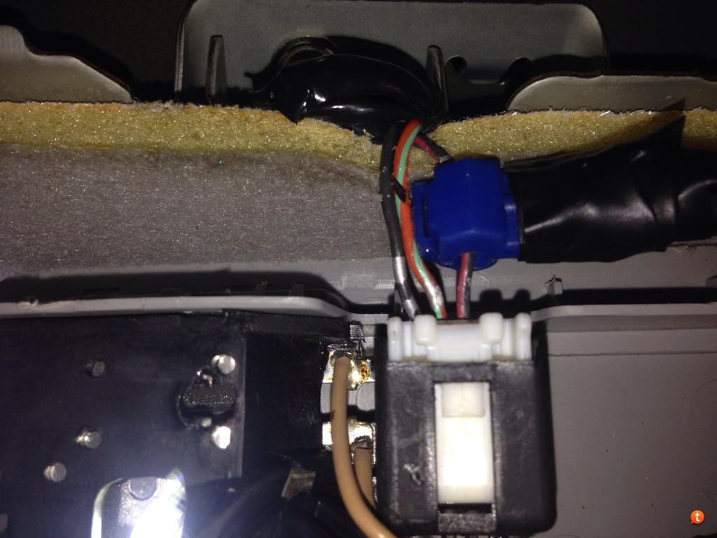

Ok guys I connected my ground wires from both led strips to one wire and ran it to the dome navigation lamp above the mirror and spliced into the black and red wire. I connected both positive wires together and ran one to one side of the sunroof fuse under the glove box that has constant 12v power. Hope this helps anyone trying to install leds to operate with the doors. Here is a pic of the dome lamp and where I spliced into it.

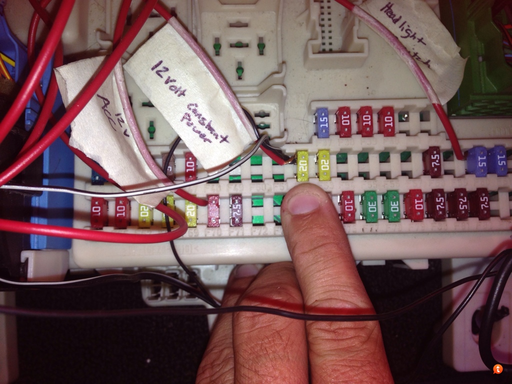

And here is the pic where I connected the positive for constant power

In need of some add-a-fuse!

Yeah was gonna do that. Lol but it seems to be working fine for the past 50,000 miles
