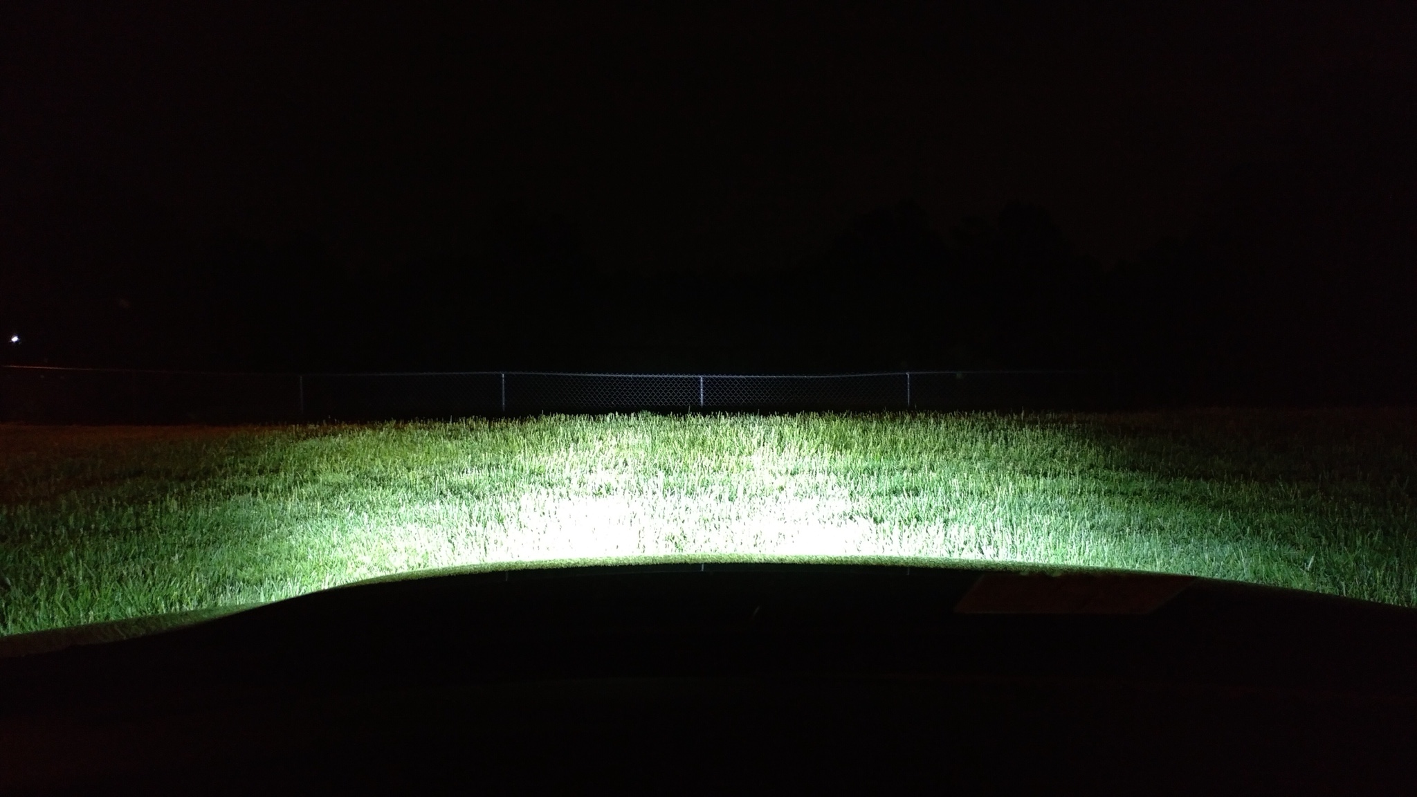

Wonder how much brighter my H1 high beams would be with those OPT7. An H1 halogen bulb is around 1550 lumens. These are rated at 3500 lumens.
@Solarsurge; how much brighter are your high beams now? Very noticeable difference?
 Old 09-20-2018, 11:46 AM   #6
Solarsurge's Avatar
Join Date: Apr 2016
Location: Richmond, VA
Posts: 577   (View Stats)
Thanks: 24
Thanked 120 Times in 95 Posts
Substantially brighter. This was in a very poorly lit area, across a small field, and you can see the fence clearly on the other side.
