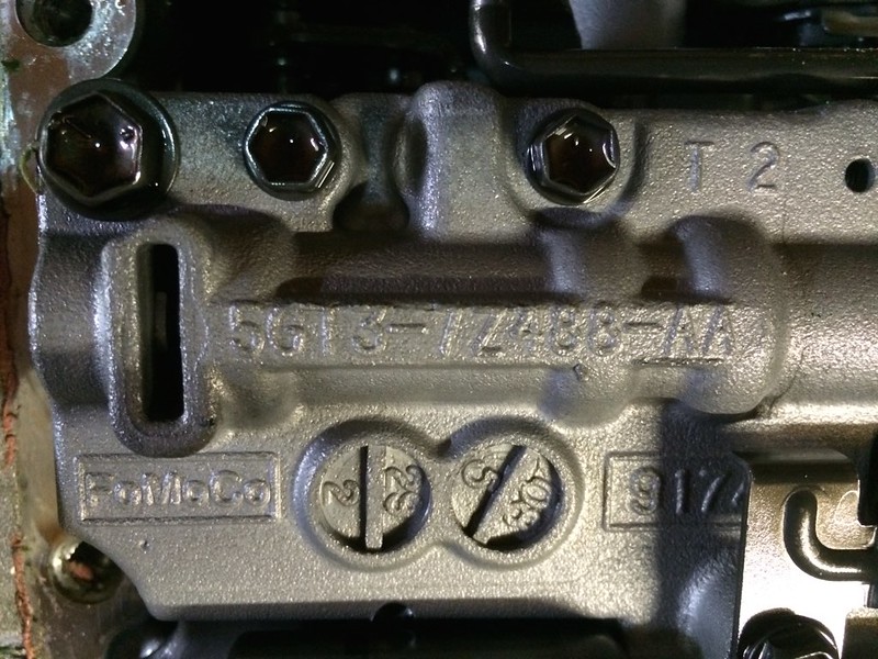

Close-up view of the transmission and assy of the valve body

 Old 12-02-2014, 06:24 PM   #16
Ozynigma's Avatar
Posts: 743   (View Stats)
Thanks: 225
So how accessible is all this with the transmission in the car?
Of course I have the luxury of a spare transmission out of the car at the moment which I can play around with
 Old 12-02-2014, 07:14 PM   #17
torquemaniac's Avatar
Location: Montreal, QC
Posts: 733   (View Stats)
Thanks: 927
This is a very good question...maybe the CX-7 shop manual can answer that...il look into it
Damnnnn...you have a spare transmission...lucky you...I though you only had a spare transfer case!
When will you start modding the spare trans and give some feedback
2011 CX-7 AWD 2.3 turbo
 Old 12-02-2014, 07:24 PM   #18
Thanks: 927
The valve body can be easily removed according to the CX-7 shop manual...see section 05-17-38 to 05-17-41 for in-vehicule removal

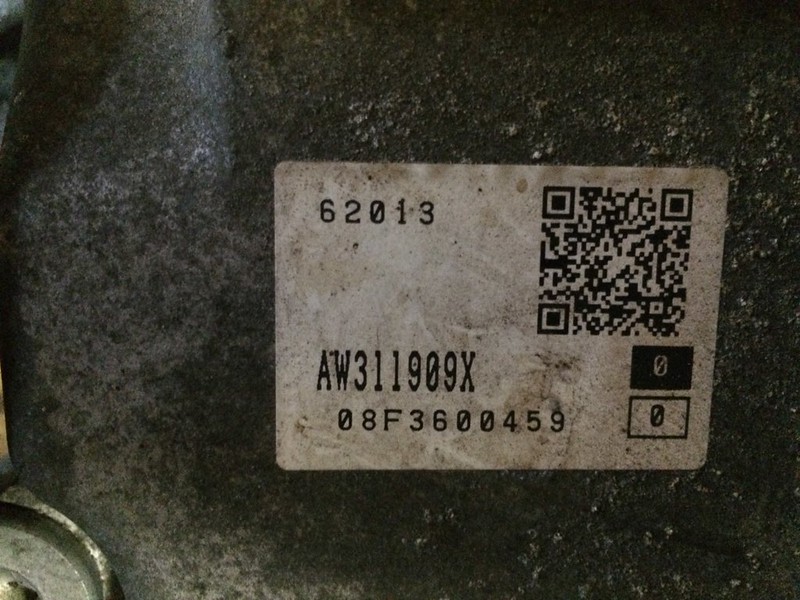

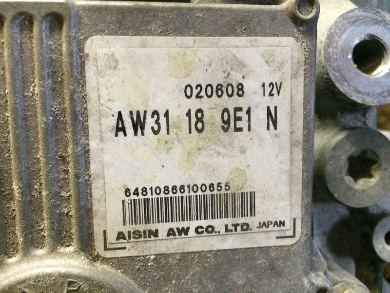

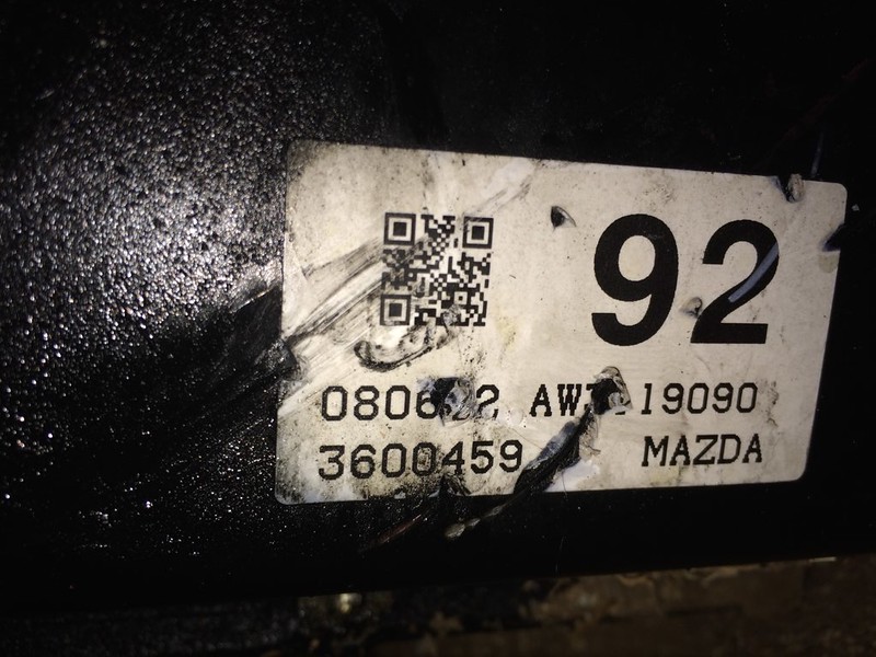

Here are the three ID tags I could find on my spare transmission.
On the front of the transmission on the black removal cover.
Untitled by ozynigma, on Flickr
On the top of the transmission control unit.
On the top rear of the transmission casing

Thanks Ozy, but what I really need is the identification of the valve body...

 Old 12-08-2014, 02:05 PM   #25
Ozynigma's Avatar
Thanks: 225
So does that involve removing the black cover and looking for an identifier on an internal component?
 Old 12-08-2014, 05:39 PM   #26
Thanks: 927
Yes sir...if you dont mind...otherwise Ill take a guess
 Old 12-11-2014, 04:45 PM   #27
Ozynigma's Avatar
Thanks: 225
In plain text
T2
5GT3 - 7Z488 - AA
2/29
08/5
9174
The Following User Says Thank You to Ozynigma For This Useful Post:
torquemaniac (12-12-2014)

To set some reference, this is the top of the valve body
And this is the bottom
First step is to remove the 6 bolts form the top (I suggest putting the bolts on a foam to remember were they go...they are not all the same length)
After this, turn the valve body over (bottom is now face up) and remove the 19 bolts
Now you must be very careful because the 5 layers (3 bodies and 2 separator plates) of the valve body are loose...you must keep everything in place for now to prevent stuff from falling
Next step is to carefully remove the 4 bottom layers of the valve body (bottom is still face up) in one shot
You must make sure that 4 bottom layers stay together all the time, otherwise you risk losing some miniature check-valves
Now you will remove the 4 miniatures check-valves in the top layer
There are 3 metal check-valves and 1 plastic one
Now you can turn over the top layer
The round thing with the screwdriver slot is the main pressure regulator valve
On the back of the top layer is a metal key that need to be removed in order to get the main pressure regulator valve out...gently press on the head of the valve and use a magnet to take the metal key out
After this, take out the valve
Be careful not to lose the boost valve that is in the main valve
Next remove the OEM spring
Put the new spring
Put the main valve (with its boost valve) back in
There are stair steps on the main valve head
You must put back the metal key on the second (lower) step of the main valve head (this is important to get the proper valve travel with the new spring)
Once the main valve is secured with the metal key, its time to put the check-valve in their respective places
After this, carefully put the four bottom layers (all at once) back on the top layers
Make sure the layers are properly aligned and insert back the 19 bolts on the bottom layers (which should still be face up)
Screws the 19 bolts until all the layers mate...do not torque them up at this point
Turn the valve body over, and insert the last 6 bolts (same procedure as above)
At this point, use the CX-7 workshop manual specs to torque the bolts
Now on to the clutch control valve adjustment...
This is the B1 clutch control valve adjuster screw...use a 3mm hex key and turn it 1.5 rotation counterclockwise (540 degree)
This is the C3 clutch control valve adjuster screw...turn it 1 rotation counterclockwise (360 degree)
This is the C2 clutch control valve adjuster screw...turn it 1 rotation counterclockwise (360 degree)
Now you are done and ready to reinstall the valve body back in the transmission
Extra notes :
- you can remove the manual valve to have it out of the way
-I dont remember if you need to remove this bracket to get the harness out of the way, but if need be, be careful when you remove it because the pins that secure the solenoids could fall off
- Be ready to get dirty...every time you will manipulate the valve body, trans oil will spill...there seems to be an endless reserve of oil inside
If you have questions, dont hesitate to ask
