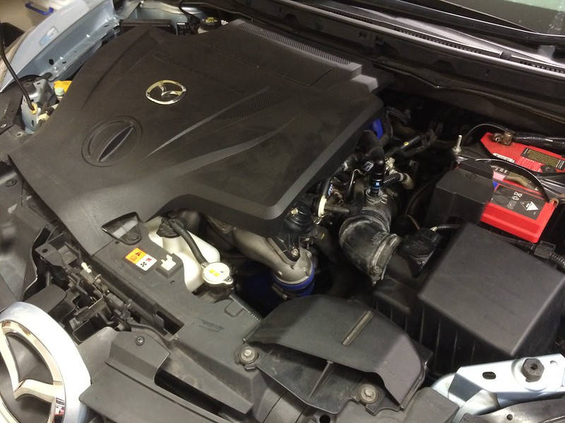

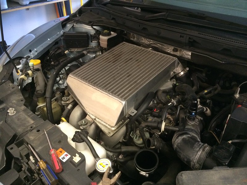

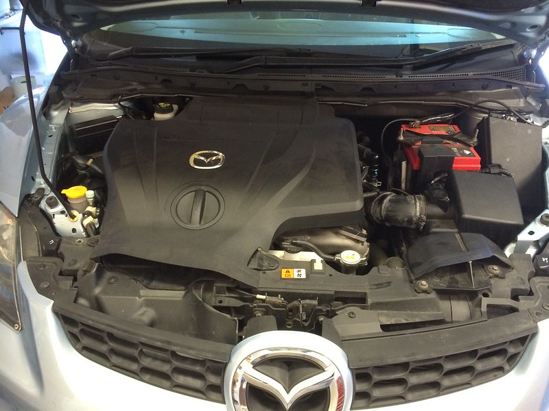

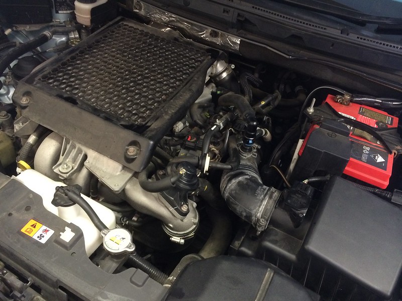

Well I installed my first mod this week, an ETS intercooler
Here is the stock engine bay. Note the nice cold air intakes for the intercooler on the left and air box on the right just under the bonnet behind the grill.
Untitled by ozynigma, on Flickr
Here is the stock intercooler, it doesn't need a shroud as the engine cover directs the air down through it.
Here is the test fit for the ETS, the engine cover still works fine on the deeper intercooler. The extra tabs are to mount a shroud for an MPS3 but this is not required for the CX7.
Here is the final installation with blue Sure boost tubes, these were thrown in with the second hand TMIC by the seller. Looks just like a stocker
The ETS TMIC has made an noticeable power improvement across the rev range. The motor is more willing to rev and from other dyno graphs it should be giving about an extra 20hp on a 240hp motor. So a very worthwhile and effective upgrade.

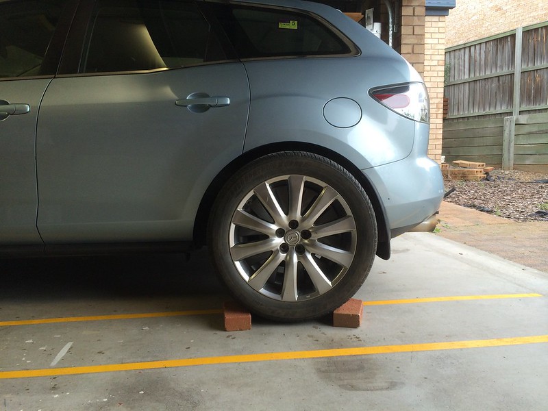

Here is what I posted on OzMPS a short while ago.
I have bought some CX9 wheels 20x7.5 to replace the 18x7.5's. Offset is 45 for the 20's vs 50 for the 18's so there should be no issues there.
The CX9 tyres are pretty stuffed and are 245/50/20's. This is almost certainly the size I will fit which makes the new tyres 10mm wider and 13mm taller than the 235/60/18's.
I did consider wider and lower profile but any wider is marginal for a 7.5" rim.
Here are some pics.
With the 18's.
And with the 20" parked in front.
Now imagine that with a 30mm drop as well
The wheels are in pretty good shape with only a few marks and scratches. I am thinking of getting them powder coated.
I am thinking of a medium to dark grey gloss finish. Any other ideas to complement the "Icy Blue" Mazda colour?

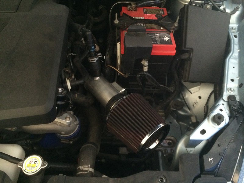

Just installed an SRI of unknown provenance (except it was used on an MPS3 hill climb race car).
Wow what a difference to the sound of the induction. Now I can hear the turbo and BOV working. I haven't done a full throttle run yet to see if it makes a noticeable performance difference like the ETS TMIC did.
This may not be the final induction setup because I would like to run a silicone TIP to a custom cold air box. Unfortunately Corksport don't their cold air boxes for CX7 anymore. If anyone knows where I could get one that would be great.
The install was fairly straight forward. I had to rotate the MAF housing 90 degrees to the side to get the PCV hose to connect vertically from the top. Also my COBB XLE BOV went in yesterday.

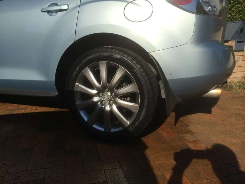

The 20" wheels are fitted.
Here are some before photos.
So while it will never be a sports car I am going for the more Sports and less Utility type SUV.
So roof racks are off, tow bar extension is removed, dodgy stickers are removed from rear window and 20" wheels are on.

Originally Posted by FatSauze View Post
Do you have a full side view with the new shoes?
I do now. The first shots were taken with bad afternoon sun and were the best I could do at the time. I took another shot this morning. I will take more when the lowered suspension and bigger brake rotors go on.
