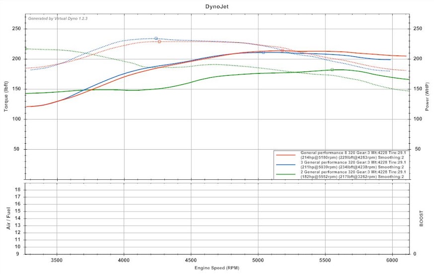

| Not Ranked : 0 score I don't know how familiar you guys are with Virtual Dyno, but it's been proven to be fairly accurate over the years. It's been a while since I messed with tuning our CX7 at all but here's a graph that shows the gains I saw just from tuning. The only mod (if you would even call it that) is a K&N drop in filter. ![]() The solid lines are HP and the dotted lines are TQ. I picked up about 32 whp and 17 ft/lbs of wtq at peak, but the real story is how much smoother the power curve is and the gains throughout the entier rev range. You can see some spots where there's close to 50 ft/lbs between the before and after torque curves. |

| Not Ranked : 0 score Good evening all! Here my result, start from two pedals. from tuning: bnr s3, 3port ebcs, hpfp autotech, downpipe 3", inlet pipe. Boost 1.3bar. |

| Not Ranked : 0 score Oh yes some insuperable pause 1-2 sec. at the beginning of start. I don't know how to overcome. CX-7 of 2010-2012 known to me go also or worse. CX-7 2007-2009 go as a rule for 1-2 seconds quicker. it is possible that different gear boxes on cars of different generations? we don't find other reasons Last edited by Dimka; 12-17-2016 at 01:43 PM. Reason: MSF Database - Automerged Doublepost |

You have to change the ignition timing lower limit to about -6.5 (this is what I use)...this will allow you to build boost and load the torque converter, and give you a good launch I can build 20+ psi of boost of the line with this and launch like a king...with my 20psi tune (safe tune with no meth injection) I managed a 5.6sec 0-60 See post 509 here : Big turbo build CX-7 :P The downside to changing the ignition timing lower limit to -6.5, is that the gear shift will be a little slower (about 200msec slower) Dont forget to remove the TCS/ABS fuse when doing this...otherwise the TCS will engage with tire spin and affect the launch

| Not Ranked : 0 score Thanks to the setup, it got a little better |

| Not Ranked : 0 score Hello. Updated firmware. On this we will stop before installing FMIC or TMIC + WMI |
