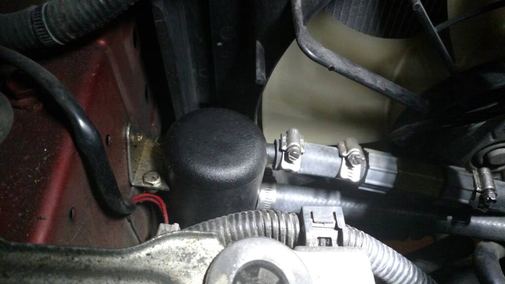

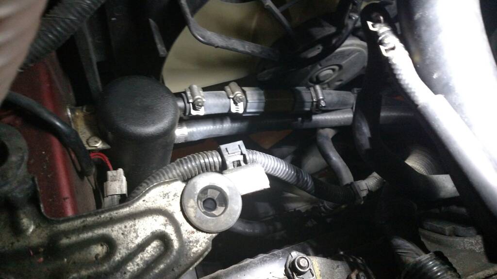

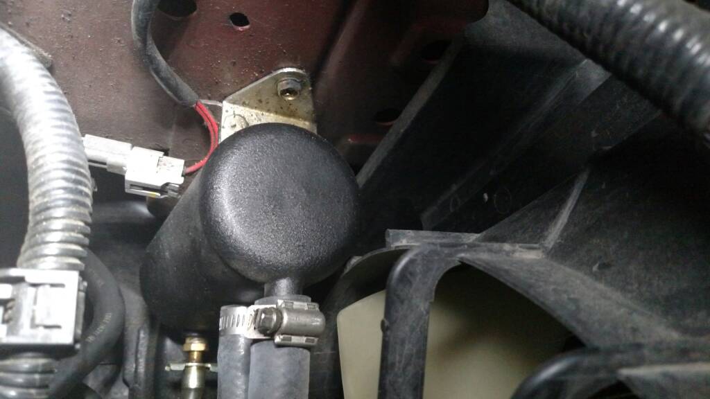

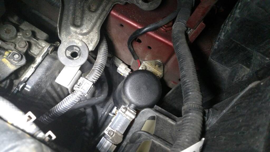

Here is where I mounted mine.
File Type: jpg 14992078_10154686759098407_5447655473240980977_n.jpg (104.4 KB, 12 views)
