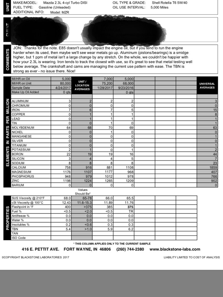

Is it just me, or are the number of stupid questions that could easily have been answered by searching and then research have been increasing? Put in the time like the rest of us. No offense op and since that was borderline dick... I use rotella. Here's a UOA on it. 85k. Mods are in my sig. Please search. Have a good day.
