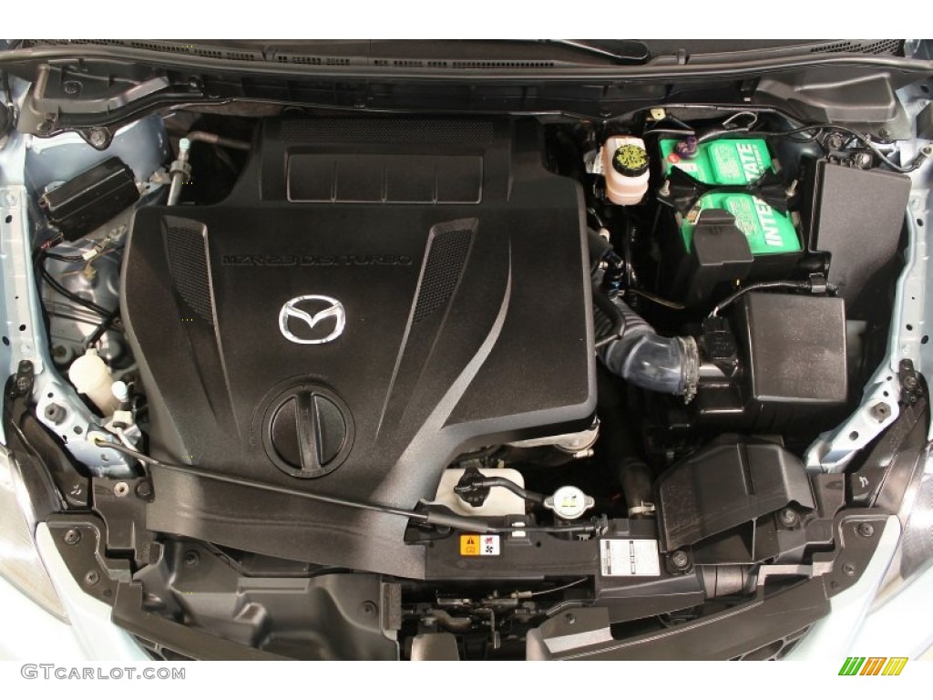

Im replacing the strut mounts on mine as I think that is where the noise is coming from. I get it when I turn the wheel and as the strut actually spins with the knuckle on CX-7 vs. independent on MS6 (strut mounted to LCA on MS6).
2007 Mazda CX-7 FRONT SUSPENSION MECHANISMS
I bought Monroe strut mounts:
Have to reuse top hat. I need to go rent spring compressor again so I can get these in.
Have to take off this plastic cover in front of cowl to access nuts:
I should also check the sway bar bushings as well but I am more concerned about getting these replaced, getting alignment and getting new Nitto 420s installed before winter. I can replace sway bar bushings after alignment if they are bad as well.
