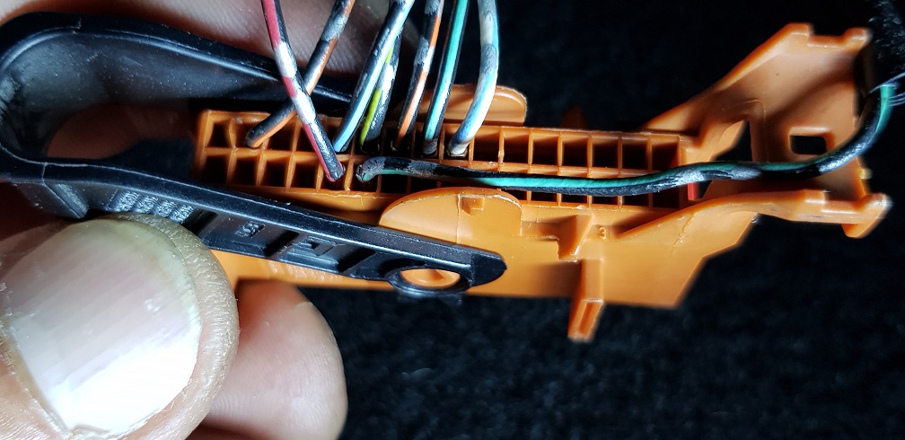

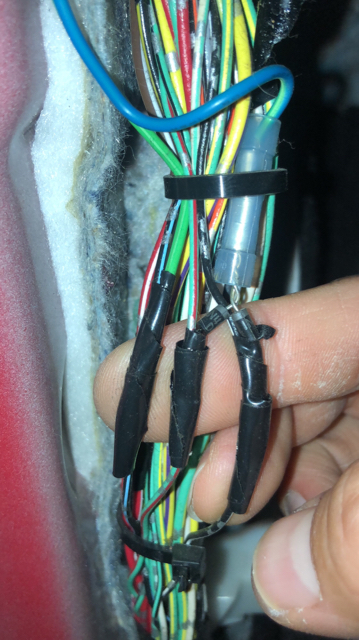

Just pulled the kick panel to see what I could find and saw the blue unlock wire tapped into two wires on the harness..one of them is the green/red thats supposed to be the lock the harness

It looks like instead of using relays they tried to use the factory alarm arm wire to lock and so they had to use the factory disarm wire along with the switch wire to unlock without setting the oem alarm off.
If they had just used a relay and 1k ohm resistor to lock via the green/red wire there would be no need to mess with the oem arm/disarm wires.

So in that picture, the light green/red wire is the lock/unlock on the car harness?
The second wire that the blue Clifford alarm wire is tapped to is the factory alarm disarm? And the green lock alarm wire is what looks to be tapped into the factory alarm to lock? What a mess...
No wonder my factory alarm ALWAYS acted up since the install. I’d have to open and close my doors just right to avoid itself self arming

Yes. Green/red is the doorlock switch wire.

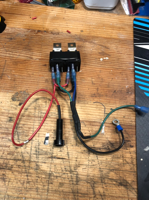

I finished the relays, installed them and works as expected! Finally!!! I should’ve looked into this myself a long time ago.
Now to figure out why the siren stopped working. I get zero voltage at the end of the wire inside the engine bay. I was testing while locking/unlocking so not sure if maybe the chirp it does isn’t enough for my multimeter go pickup since it’s kind of quick..
This was before applying the heat shrink on the fuse wire but anyway that’s how it looks Incase anyone needs this for future reference
Laborchet is offline   Reply With Quote

I'd go with a 10amp in the alarm brain.
Relays look good. You going to wait on the priority unlock?
I installed it like that, I figured I’d try that out first before adding another relay for the priority unlock.
It works great, so good that I’m happy to leave it like that because now it unlocks without any fuss and I don’t even wanna have to hit the button twice to unlock all doors. Also, it’s really tight behind the kick panel for a third relay and wiring, I could make it work but I’m happy like that. Tomorrow gonna tackle the no power for the siren

You just tap in to the wire.
It's green/red in both kick panels, or black/blue at the pjb in connector J-06.

The wires you found are the lock and unlock wires coming from the key cylinder in the door, they'll work fine for what you want to do, but are generally not used with aftermarket security because they also arm/disarm the OEM security.
There isn't a true speed pulse wire, it's just data on the can-bus driving the speedometer, depending on how your trigger works you may be able to use the wiring from a wheel speed sensor.
I actually tested the arming of the mazda hi-spec alarm, giving direct earth , constant or momentry to that J06 AC pin (second from top left) does not activate the alarm regardless the engine is running or the engine is off, the alarm is only armed by the key fob, in fact the alarm does not even arm by using the key directly in the driver door, this is how it was working and continues to work as expected even if i give constant earth to the pin, the amazing thing is even with the constant earth to that locking pin the central locking switch in the driver door works seemlessly with no problem
I think that is what the frequency relay that i bought does, it reads pulses like the ABS pulses and will trigger a relay based on certain pulse that you can fine tune up or down via a wheel on board
Can i tap into the wheel speed sensor from any where in the dash?
Cheers
