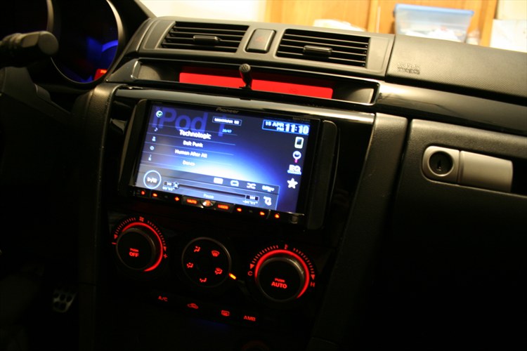

Default Pioneer 7" Touchscreen + Kanatesch Kit Installed
UPDATE: Video of AppRadio in post 21:
http://www.mazdaspeedforum.org/forum/foru...0/#post2495815
As it says in the title, finally got around to installing the Pioneer AVH-X8500BHS. Overall it's a pretty solid deck with only a couple of minor changes from 2012. The biggest change is Android integration. Kanatechs fit & finish is perfect. Full review will happen once I have a chance to play around with the Android apps. Features and a few crappy pics below:
Features:
- 7" detachable touchscreen
- 24 bit DAC with 8 band EQ, time alignment and three 4V preouts
- Android integration for contacts, calendar, Pandora, basic maps, and a few other specialty applications
- HDMI and dual USB inputs
- Full iPod/iPhone audio and video integration
- DVD/SD Card slots with MP4, WMV, DIVX, WAV and MP3 playback
- Adjustable color background and buttons
- Bluetooth audio/phone integration
- HD Radio
- XM and Navigation ready
- Dual zone entertainment for rear seat passengers

Another crappy photo and initial thoughts below:
- Build quality is first rate. Paneling and hardware is solid.
- User interface is responsive and intuitive. Accessing most major menus can be done within 2-3 inputs. The 800x400 resolution screen is bright and crisp – even in direct sunlight. Color balance and saturation look good.
- Sound quality is what you'd expect for this price range. Pioneer offers a simplified time alignment interface called Sonic Center Control with 7 alignment variances per side.
- The graphic EQ has 5 standard and two custom settings (8 band adjustable). Custom #1 can be adjusted independently for each audio source (BT, radio, iPod, DVD, etc). The Advanced Sound Retriever works pretty well on some of my older MP3 tracks. But I don’t notice much of a difference on my more modern iTunes collection.
- Bluetooth works as expected. Get in, start the car, and it syncs within 3-4 seconds. Contact list transfers over seamlessly. Voice control works great for basic call features. Calls over Bluetooth are clear; and I’m told there’s little background noise when speaking to others. Pandora streaming works great. But you’ll need the AppRadio, a compatible phone, and the right Android/IOS cable in order cable to stream artist, title, and the like/dislike features. If you’re in ACC mode with a connected device, and you start the car, it can sometimes cause a hiccup in that the HU cannot find your phone again. I found that waiting 10 seconds or cycling the Bluetooth switch corrects the issue.
- HD Radio is nice but the transition from analog to HD is a bit clunky. Analog plays at a much higher volume over HD stations. It would have been nice if Pioneer leveraged a built-in leveler between the HD and analog signals.
- iPod control is quick and flawless. You can search for content by playlist, song, artist, or genre. Video works great and allows for basic picture adjustment. You’ll need to buy the CD-IU201S cable to play video. Or if you’re running one of the newer iPhone/iPods with the lightning cable, you’ll need the more expensive CD-IH202 adapter.
- DVD and CD player offer standard controls. No noticeable delay in startup or playback.
- SD card works OK. There is no standard menu screen to browse folders. You use the seek buttons to browse forwards or backwards. Pioneer does separate by file type so you can look at audio and video files separately. Lower speed SD cards like CAT 4 don’t play very well. My CAT 10 card did fine.
- The adjustable button/screen color is a nice touch. I was able to match up the deck pretty close to the OEM lighting (red with blue accents). There is also room for one JPEG image that you can set as your screen background.
- Adjustable LCD panel with detachable face. In my opinion, this feature alone is worth the extra $150 over ACH-X5500BHS. Although this causes the screen to protrude a quarter inch.
- Dual USB input for multiple audio/video sources. I found this to be useful as I can run one to my glove box for the iPod, and one to the lower panel for my phone. This unit also features dual zone integration which is great for a second monitor for the backseat passengers. For 2013 Pioneer also added an HDMI input for Android devices.
- Mixtrax was an unexpected surprise but no change from 2012. Provides a 10 second mash-up between two adjacent tracks. I do find it annoying when trying to seek through songs but my daughter finds it amusing. Mixtrax also provides visual accents to whatever is playing at the time. Think of it as a spectrum analyzer with flashing lights.
- AppRadio mode. I am glad Pioneer has taken the leap to support both IOS and Android apps. But don’t expect anything grand here. You’ll get basic connectivity with things like calendar and contacts. There’s a basic maps application with pinch and zoom. A couple music apps. And a couple of specialty apps for fuel consumption and parking. But don’t expect turn by turn directions, YouTube, Netflix, or any other full feature app to run through the HU. Also, you’ll need Pioneer’s proprietary cable (varies by device) in order to run AppRadio mode.
The problem with AppRadio is that Pioneer has to update the firmware anytime Apple or Google update their firmware. So if you’re the type that has to have the latest and greatest OS, don’t expect that AppRadio will automatically get updated with it. In my research, it is taking Pioneer around 2-3 months to catch up from a major OS upgrade.
The full list of apps can be found through this link (sort by IOS or Android): AppRadio | Pioneer Electronics USA
Before taking the plunge, do yourself a favor and make sure your phone is compatible!! The most updated list of IOS/Android devices can be found here (Samsung phones require a proprietary 5-to-11 PIN adapter): http://www.pioneerelectronics.com/PU...o+2+(SPH-DA100)
It’s worth mentioning that both IOS and Android have aftermarket developers that mirror the smartphone screen to the HU. If you’re willing to jailbreak or root your phone, and it’s on the list of compatible devices, AppRadio might be a more compelling solution for you. I will update this review once I have had a chance to experience myself.
All in all this a great HU for the price. Great audio with a plethora of add-on capabilities. The only big changes for 2013 are Android AppRadio and HDMI.

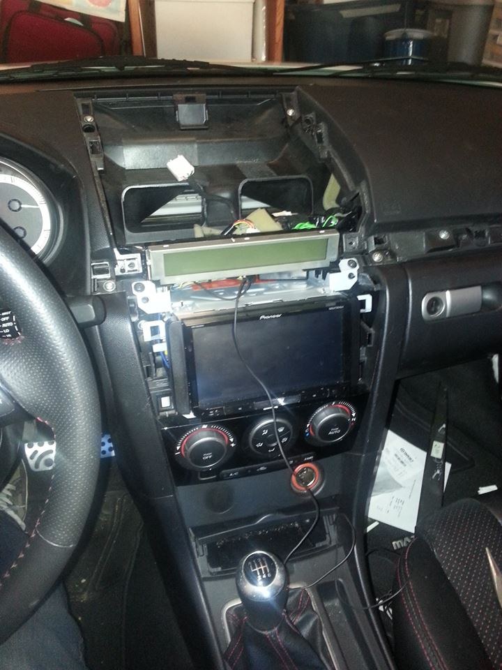

Thanks: 956
Is that the best dash install kit available for gen1? My Gen2 Metra kit looks quite stock.

Kanatesch uses an all-metal backbone behind the the piano black panel. The Gen 1 Metra kits are part plastic and tend to flex/separate over time.
The two photos below show the primary difference. On mine you can see the metal frame wrapping around the side and top of the HU, with an all-metal casing supporting the LCD screen. The second photo shows one of two separations that can occur with the Gen 1 Metra kit. And depending on how much hardware is behind the panel, it could "pop out" completely.

Wow, that's a really crappy design theat Metra has made for the Gen1. I can't imagine how many people get stuck with it. Glad for the revision for Gen2. 2 years later, mines still herra frush.
