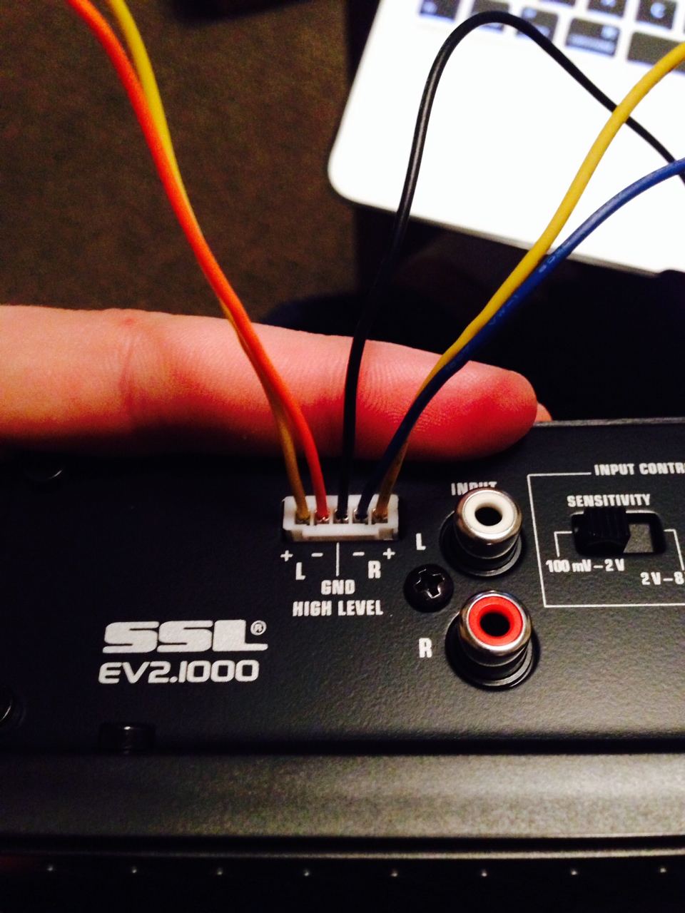

| Not Ranked : 0 score @surfwagon; Here is the high level input. did you hook up the ground wire? and which wires will I splice into the white with blue stripe and gray wires? thanks!

| Not Ranked : 0 score so has anyone else wired the high level input and can you help me out? Maybe I'll just do it with a LOC (I bought one anyway...)

| Not Ranked : 0 score I'm saving 40 bucks doing it this way so go flip a shit I could care less

Easy to install/remove and involves no splicing. Do it.
