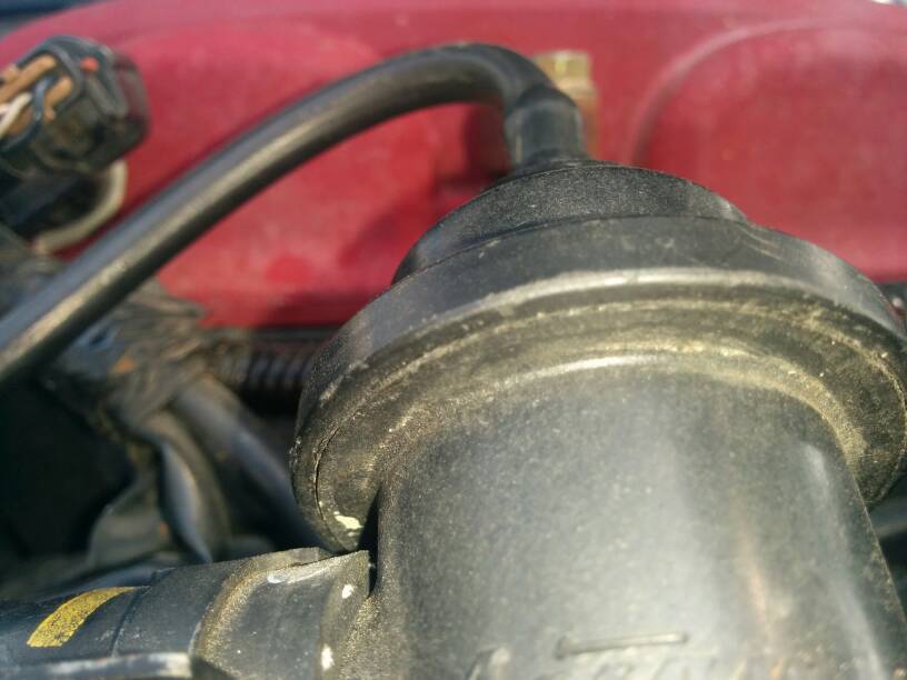

got that pipe replaced! no more shitty tape. and I know, my engine bay needs to be cleaned up a bit
I'm still leaking boost but not from there and the car is running a lot better. hopefully this saturday a friend and I will locate the source of the leak. Also going to re-wire my a/f gauge since that's not reading properly.

Are you still running the OEM throttle body inlet pipe from the IC? The sensor on the backside of that rubber piping likes to rip, causing a boost leak. BEGi makes a legit replacement TBI.
Yeah I am. I was looking at a Flyin Miata replacement. Should be about $250 with a BPV

If the stock BPV is working, no reason to run an aftermarket. Save your coin, get the BEGi TBI. I like FM, but they charge way too much for shit. Completely unnecessary.

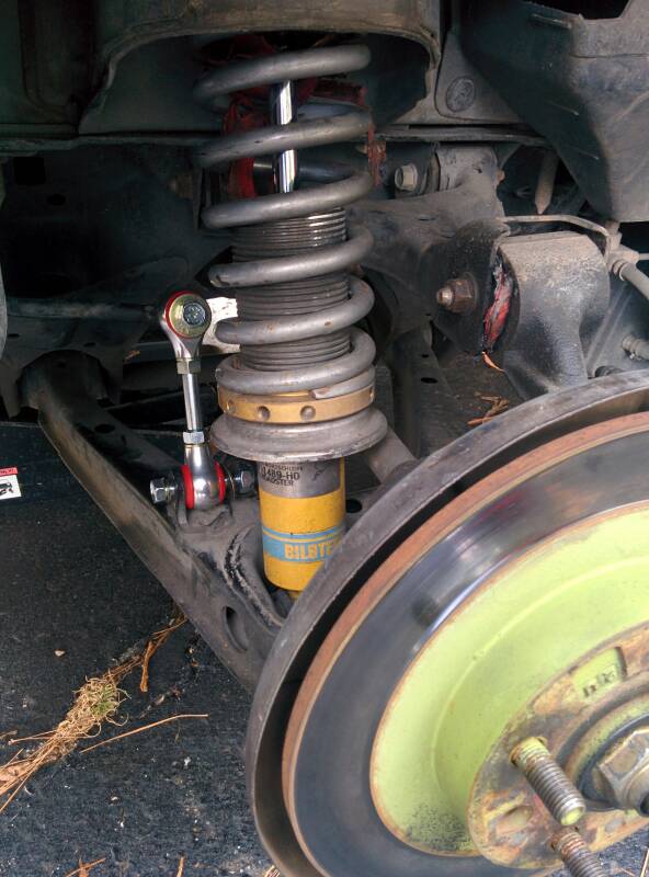

yay more car pics. Tried to install my rear end links that my friend gave me and I guess something snapped inside. Gotta wait until I can get a saw and cut the bolts off now or get a rear sway bar. Probably gonna do the latter since I need one anyways. Had some problems with boost earlier today. Set at 11 and I hit 13 getting on the bypass in 4th. WOT in 4th again and I hit 11lbs and slowly declining. Went down to 10 then I let off. Think this is the culprit. so I ordered a forge bypass valve. Hopefully that helps.

Okay, good to know. I have this downpipe and cat Flyin' Miata : Engine/Drivetrain : Upgrades for Mazdaspeed : Downpipe/catalytic converter for Mazdaspeed MX-5 and the rest of the exhaust as well. So I'd be good to run 12lbs and make 200ish whp?
The OEM TBI won't allow you to run 12psi, but yeah, I would monitor AFR if you don't have a TPS resistor soldered in line. You are already running lean from 3k-ish (full spool) to 5k RPM when the ECU finally switches to open loop, and gives you fuel. Toyota 321cc injectors are a good band aid for this too.
With that DP, you will get boost creep in colder weather <50 degrees, unless your wastegate inlet was ported.
Okay right on. I'll probably order that begi TBI soon. I know I'm running rich right now because I have fuel coming out of my exhaust and I'm throwing the engine code PO420. My AFR gauge is not reading right currently... Going to have my friend help me rewire it this weekend so I'll know just how rich I am running.
