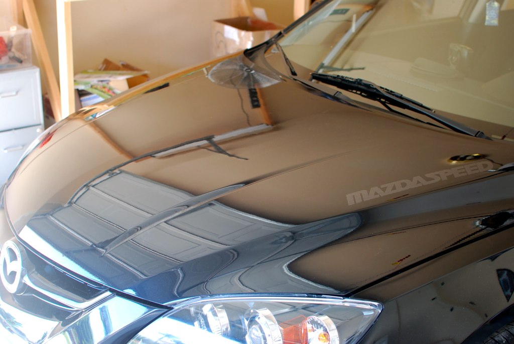

I have the hood painted to match the other body panels. On with the pics...
Mazdaspeed Logo showing the original Carbon Fiber Weave. At certain angles and lighting conditions, you can actually see the CF weaves under the paint.

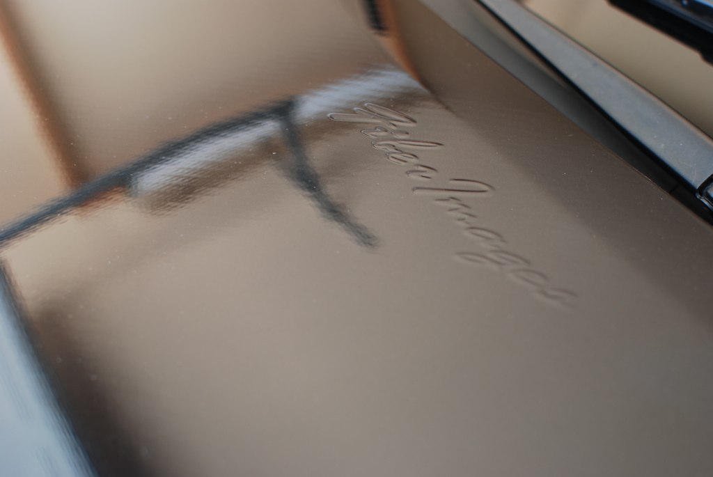

There is a Fiber Images logo located Top Middle of the Hood, don't really like to idea of advertising the brand fro free.

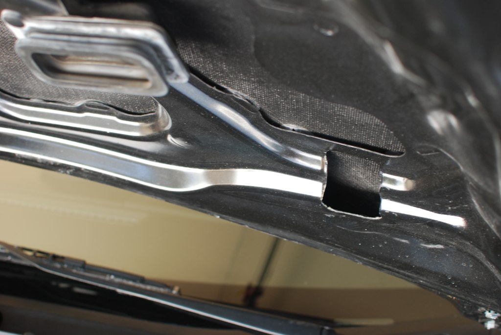

Underside of hood with stock ducting. Body shop claims that the insulator don't fit.
A real ghetto cutout toward the back of the hood on both sides.

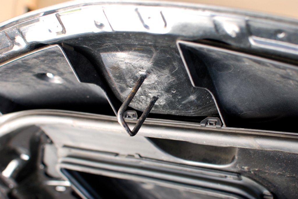

Latch looks solid
I believe the skeleton of the hood (the inner) is fiberglass and only the top cover is made out of carbon fiber. The hood is definitely not as light as I have expected, but light and flexible enough that you will notice.
The overall Fitment is alright. You will definitely see bigger gaps all around, but the gaps are more or less even on both sides. I am seeing some issues with the hood not sitting flush with the fenders. I think sliding the hood forward a little may help. To adjust the hood back and forth, you will have to take off the front bumper and both fenders to get to the hood latch bolts. A royal pain in the you-know-where.

Very nice, good to see you painted to match the rest of the car and not go the rice way

I like what you did with the paint job... Looks cool.
The body shop that installed the hood lied to you about the insulator stuff not fitting. I have mine on... That "ghetto" hole in the back is where the insulator slides into place. The rest of the holes for the insulator panels need to be drilled out if you choose to install them. The under side of the hood is an exact reproduction of our OEM hood, so everything fits....

Your a f'n retard..... you can still see the carbonfiber pattern wanting to come out through the paint..... you know why?!?!?!
CAUSE IT'S CARBONFIBER AND IT WANTS TO B SEEN!!!!

Why did you decide to go without pins?

No need for pins with this hood. I have had mine for over 2 years. Mine fits perfectly but PLEASE put the stock insulator on it... you WILL need it. Also it wouldnt hurt to pull the rubber seal off from the back of the engine bay to let out some of the rediculous engine bay temps before it starts to get to your new investment.

.... You need to get some heat protection on that thing asap! Don't be like me and not put any and then 3 months later you see cracks go through the entire clear coat from heat damage. I'm thinking about sanding it and painting it black just so the cracks don't show up. It is starting to look pretty bad.
I went back to the body shop and have them put the insulators back on.
