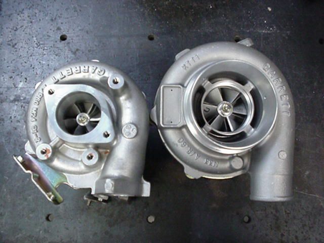

STEED SPEED T3
GT3071 .63 Upgrade Spring 2012

- New Turbo

Upgrading to a GT30 72.6mm 56 Trim 0.60AR
Turbo is well suited for 2.0L Engines with a 300 - 500 HP Target. I have looked into how that will change the boost threshold and it Will make the car slightly "Late" in boost compared to the current turbo which is a GT28RS.
All that with the Upgraded Transmission, Huge Clutch and a car that is only 2280 Lbs... Awesome Summer Driving..
Currently the turbo Builds as of 2750 RPM and anything over 3000 is an immediate lag less climb into high boost. My math is saying that it will be 3050 RPM before it will build 1 psi, and 3500 ish to get the same lag less climb.
