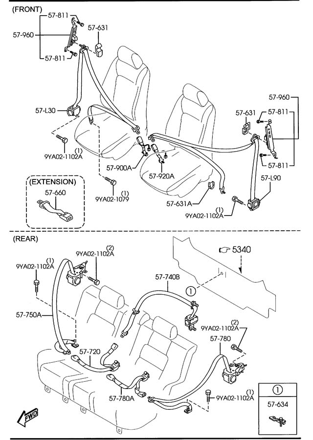

Honestly, you may just have to replace the whole seat belt retracting assembly. Here is a picture of the assembly, maybe this will help:

Anyone simply replaced the seat belt and retracting mechanism? I assume its a simple R&R? My driver's side front belt is not retracting anymore.
