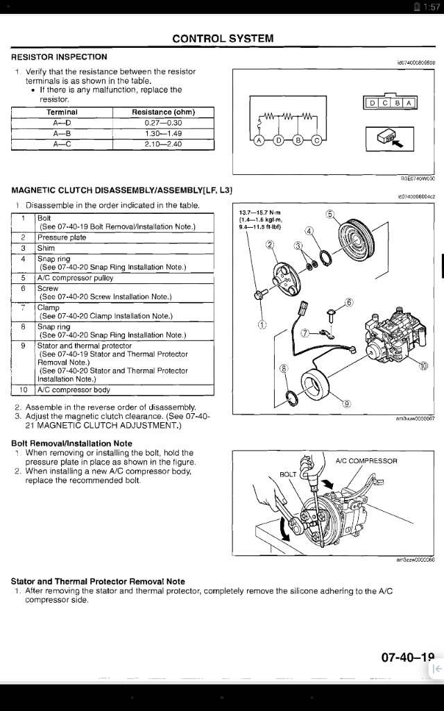

 Old 05-28-2014, 02:32 PM   #50
thlillyr's Avatar
Posts: 1   (View Stats)
thlillyr is an unknown quantity at this point
My 04 2.3 Mazda 3 blew up last night. Coming home big cloud of smoke and terrible rattle squealing noise. I pressed the ac off button and the noise Mostly went away and i made it home. Found this forum last night and took it apart this morning. This is what i found. Is there more bad here then just the bearing?
Is the clutch still gonna work or is it as trashed as it looks. Also this bering is totaly trashed and will not come out with a hammer. Whats the trick?
thlillyr is offline   Reply With Quote

This thread is coming in handy to me and since I didn't notice a diagram of the dis-assembly of the a/c clutch unit I thought I would contribute.
*****This is for the 2009 MS3 105mm clutch unit.*****
