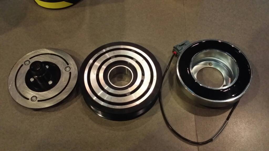

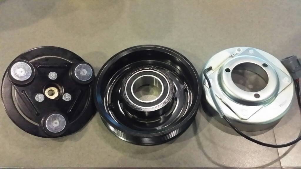

This is a great tutorial! The bearing in my '08 speed 3 was toast. Sadly I bent the pulley when replacing the bearing. I emailed North America A/C Distribution through amazon and within 30 minutes they had the correct clutch kit uploaded to Amazon for sale ($80) and shipped one out to me the next morning. Hopefully this is helpful to someone:
124mm 6 groove pulley
Brand: CoolTech
Manufacturer Part Number: 476CKturbo
The kit does not come with bolts, shims, or C-clip. The kit includes the pressure plate (2), A/C compressor pulley (5), and stator and thermal protector (9) - numbers reference exploded parts diagram Nel Mazdaspeed posted.
Thanks again for the original tutorial and all the additions people have added over the years.

Can anyone verify that this looks like the correct clutch assembly? It looks right to me but I haven't taken mine apart, and don't want to if I'm not sure that this will work.
SnailTune in progress
