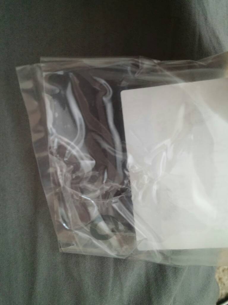

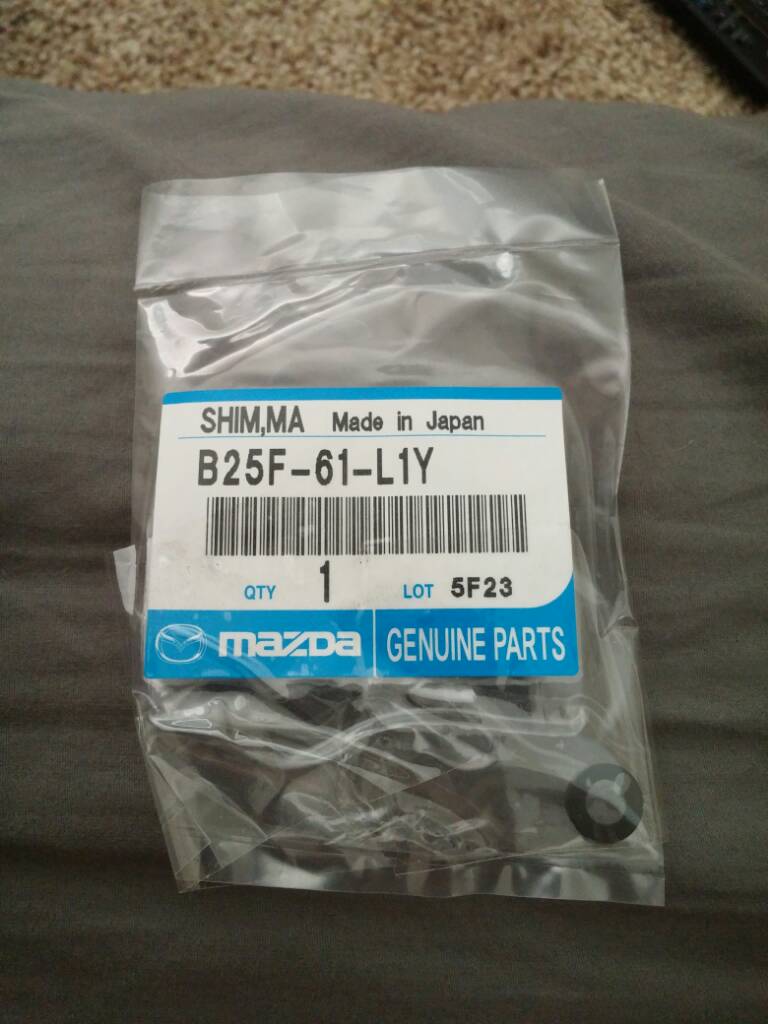

Hey guys quick question for anyone who has ordered the shims from a dealer; it seems to me that the shims come in a pack of 4,but when I got mine there was only one in the bag, and the bag had a hole in it and was taped shut. This clearly looks like the dealership trying to screw me over but before I go explosive ape shit on them I thought I would check to see if this is normal.
Sent from my LG-D851 using Tapatalk
The bag says qty:1 on it..
Yes but the ordering form says they come in a 4 pack, and the bag has a hole in it. If there was just one originally, why would there be a hole in the bag?

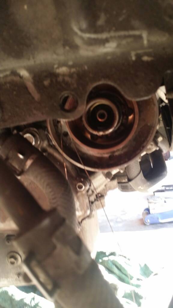

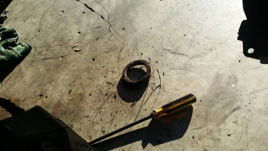

Originally Posted by thrisnospork View Post
Based off of what I've read in this thread you can't tell if the bearing is bad without pulling it out. I would just replace it since you have the pulley out already so you don't have to worry about it later. As far as removing it I think you'll be fine if you carefully pry it out with a flathead.
I tried hitting it from the back with a flat head and hammer, but couldn't get it to come out. Then I tried putting all my weight on it with a crowbar, but it still wouldn't come out. I even got desperate and put it under a jack stand, with the column on the bearing, then lowered my car onto the jack stand and hoped that would make it come out, and it still didn't. Man, those little tabs holding it in are strong!
I don't think trying to pry it out with a screwdriver would actually work. Any other way to get it out without grinding those tabs off, or trying to find a place with a hydraulic press that could press it out for me and put the new one in?
I've attached pics of what it looks like after I had a go at it. If I try to grind the tabs off (not even sure how I'd do that), would the new bearing still stay in the pulley?
I've yet to do this myself so I apologize for giving you bad advice lol. It looks like you should be able to stick a socket through the front that's big enough to cover the bearing but small enough to fit through the pulley and hammer it out. Good luck!
No problem. I know we're all doing this to try to help others.
As for the socket method you suggested, if half the weight of my car resting on it didn't get it out, I don't think a hammer/socker combo would do it now matter how hard I try to hit it
Pyronaut is offline   Reply With Quote
Just to clarify, you are trying to push it from the front to get it out the back side of the pulley right? Unfortunately I can't give any advice on how to take it out. I was able to push the inner race of my bearing out with my thumb, and used a dremel to cut through the outer race. I just used a screw driver and a hammer to knock it out after that.
Yeah I would hope so, haha. I'm pushing it out towards the side with the little tabs that stick out over the bearing. Basically from the closed side of the pulley towards the open side.
In rpaniagua's photos it looks like he might have cut or ground them off, but I'm not sure. So you managed to get it out piece by piece then? I wonder if I can get the inner ring out first, perhaps I could bend the outer part to be able to remove it, and then maybe hack away at the tabs until they're all gone so I get can the new pulley back in.

I kissed the tabs with the dremel as well. Good luck trying to get it out. The new bearing went in nice with a couple taps around it with a hammer, and slid right onto my compressor like a glove

Hello everyone - I ended up purchasing the same shims from Mazda (B25F-61-L1Y) came with 4 shims of varying thickness. When I install one of the shims with the one previously installed, the ac clutch spins, stutters, spins, etc. With only one shim the clutch is always spinning whether or not the AC is on or off (which isn't good). Combination of other shims results in similar results (AC clutch not spinning completely. Curious if anyone can offer some knowledge. Any help is greatly appreciated!

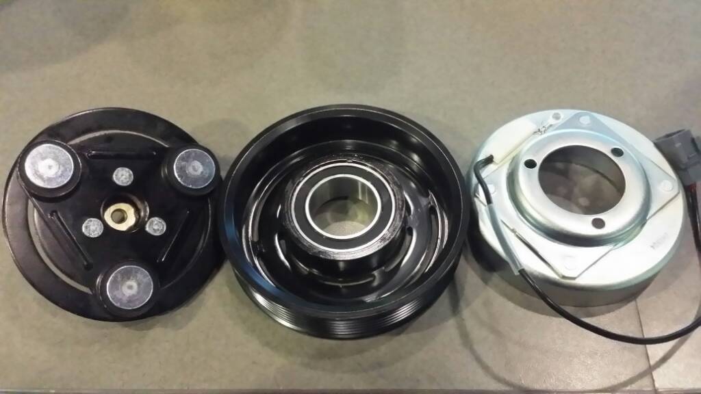

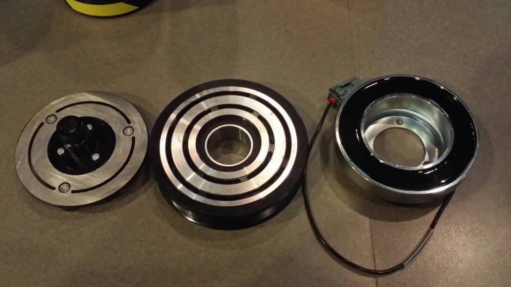

Curious if you figured this out yet? I replaced the bearing using the procedure in the op when my bearing went bad, and that worked well. But when I recharged the system (due to me pulling the wrong snap-ring out during disassembly and losing all the charge in my system...oops) my clutch was not engaging. Pulled everything back off and I had a similar looking magnet coil to some shown in the previous pictures. So I ordered this from ebay:
NEW 2007 08 Mazdaspeed 3 & 6 TURBO ONLY AC Compressor CLUTCH KIT 124MM 6 Groove | eBay
This came with everything I needed, clutch, pulley, coil, and even hardware including shims for $40.
Everything went on and fit well, but when I started the car the clutch was spinning all the time. I then loosened the retaining bolt, and I could get it to not spin if I loosened it to a point, but I'm concerned that it's too loose and will fall off. So I'm assuming my spacing with the shims is not correct.
That being said, this kit for $40 is a really good deal for anyone needing replacements.

Default wiring stator
Anybody know where I can get just the stator? The piece on the far right?
Here's mine now, the one I installed a couple weeks ago.
And here's the wire that fell out.
How did you wire up the stator? My compressor is still mounted, and I can't seem to figure out how to get to the wiring harness of the stator. I removed the 3 screws, but not sure how to get to the connections.
