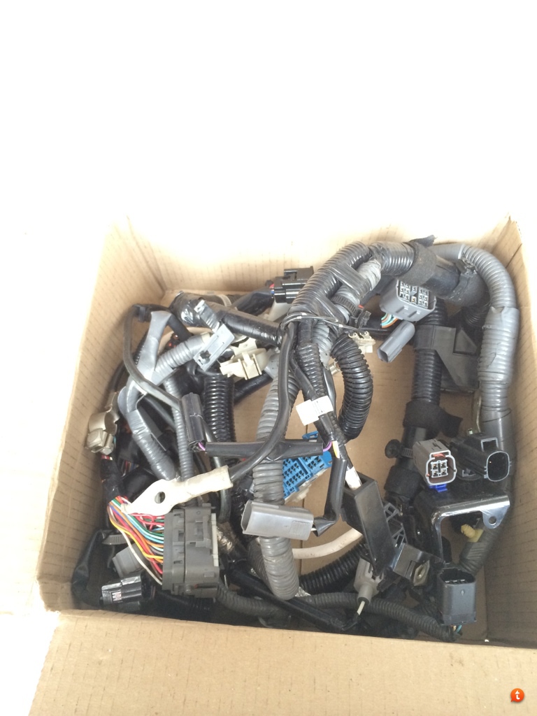

A little background on the situation: Did a BT swap last weekend and when we started it up my AFRs were stuck at 14.85. Previously before the swap, my AFRs were moving around as they should when the k04 was in the car. Fast forward to today: I just swapped the primary o2 sensor with a new one from rockauto (NGK NTK 24393) and it's still having the same issue; AFRs stuck at 14.85. I've reflashed a few different maps and still the same thing. The wires on the new o2 are not twisted and the clips are plugged in. The secondary o2 is currently not in the DP due to messed up threads, so we plugged the bung; this shouldn't be causing my current issue at least I don't think? Not really sure what else there's left to check. I'm hoping it's something super simple, but who knows what it could be. Any ideas on what might be causing the issue? Needless to say I'm very disappointed in this outcome as I can't even enjoy the hard work my friends and I put into the car. This shit is big time lame...
FreekTuned
