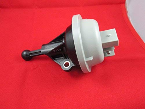

The part that goes down that the sensor rides on, is that the actuator that holds the vtcs open? (Where the arm is)

The pale green doohickey with the plastic plunger arm is the VTCS actuator (the thing that moves the arm of the VTCS flapper).

https://images-na.ssl-images-amazon....N1tPL._AC_.jpg
this is the actuator but after a second look, i think the bad screw just hold the limit switch feedback that tell the ecm if the vtcs are open or closed. you could even drill a third screw in the middle if you cannot get the other one out, it doesn't take much clamping force to keep it there....
