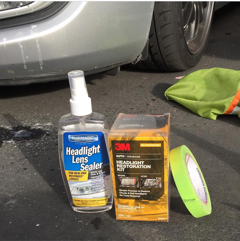

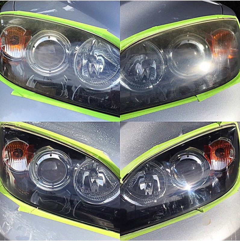

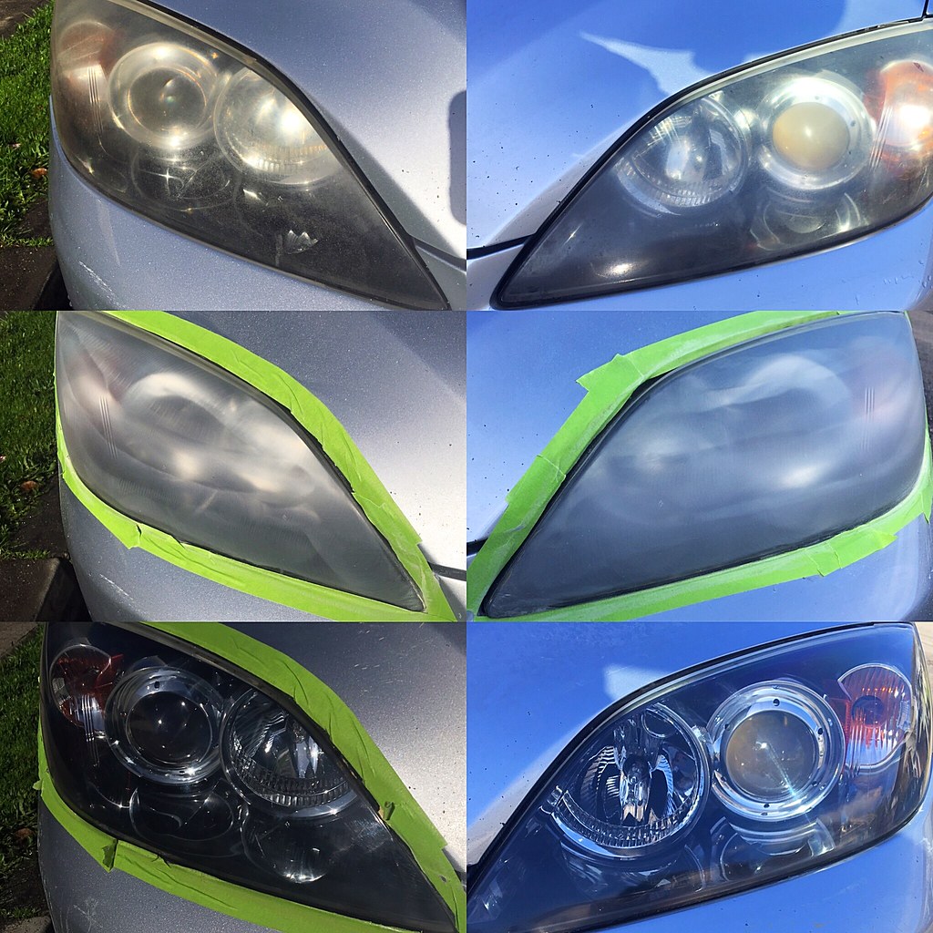

I know the instructions are pretty straight forward. Just wanted to share my results. The distribution of light is much better and the cut off is back to OE standard. It took about an hour for both cars.
My car with the kit "by hand"
My gf's car using the "3M drill kit"

Is the by hand better? Or were the lens on the other car just worse condition to start.
Her car was way worse and I used the drill kit. It came out damn near perfect even though my drill ran out of battery towards the end. I will say that I prefer the by hand kit because I could be more precise during the sanding portion.
