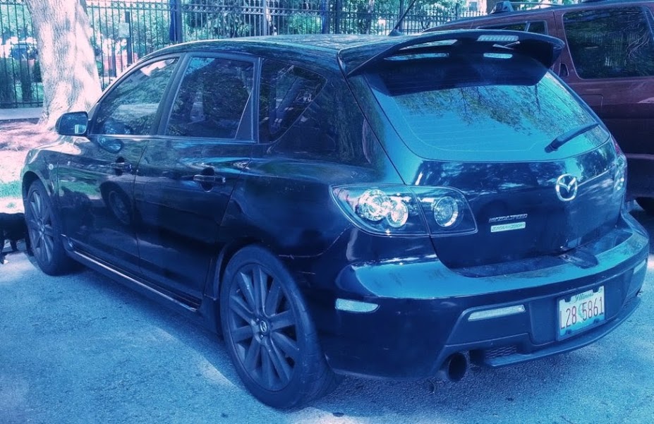

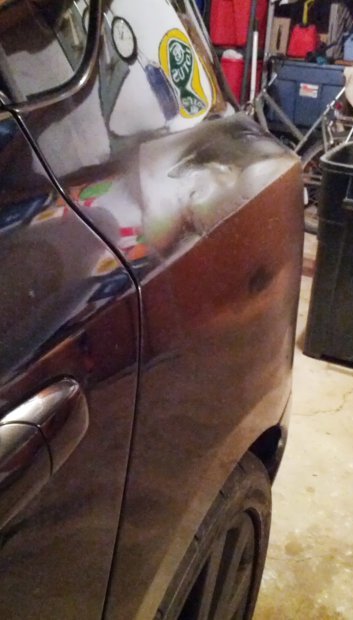

EDIT: Long story short, here's the before and after pictures of my whole 18 month adventure into body work. Read on for all the details.

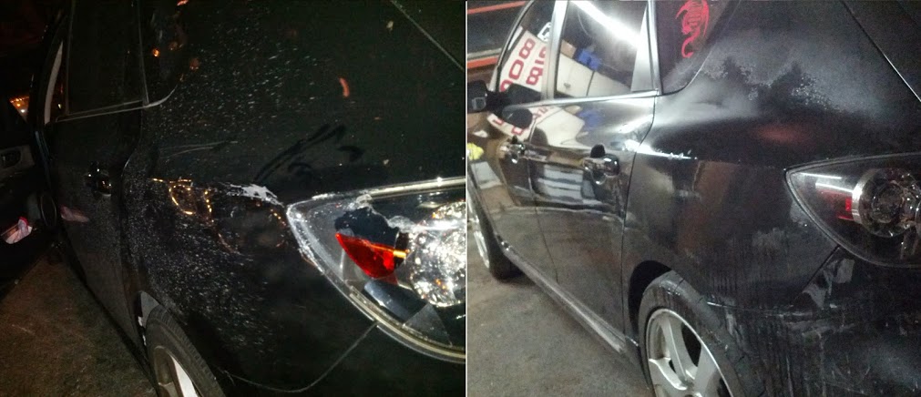

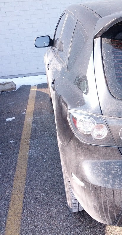

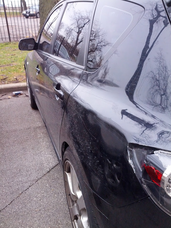

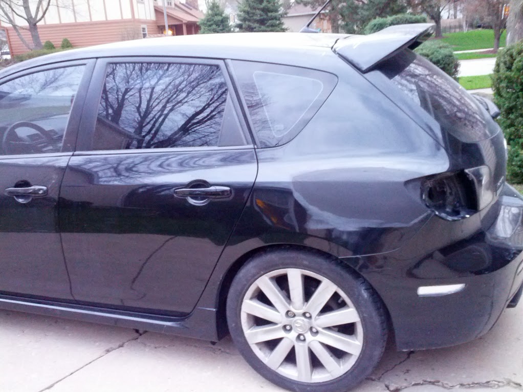

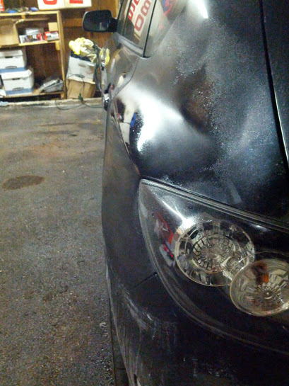

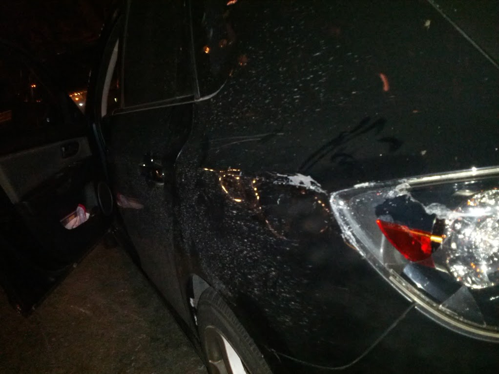

So this happened when I left my car on the street a few months back:
Yup. I think a truck backed into it or something. The building I was in front of didn't capture anything on their surveillance cameras and I had absolutely nothing to go off of for an insurance claim. I didn't want to claim it under collision since I'm still accident-free and my collision deductible is $500, and they wouldn't likely have filed it under my comprehensive. I figure for the price of bondo and primer, I may as well try and fix this myself (with instruction/assistance from my father) and see how mediocre I can make it look. I always have the option to take it to a shop later if I miraculously fall into a large sum of expendable income. I may have it professionally painted either way. I replaced the still functional tail light with a new one I ordered from Mazda Motorsports Development within a month. I love that racer discount!

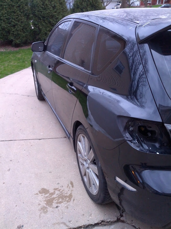

I also sanded and primed it, and painted it with some black metallic nail polish as a temporary fix so that it wouldn't rust before it got warm enough to work on it. So it's looked like this for the last 5 months:
primed; painted with nail polish.

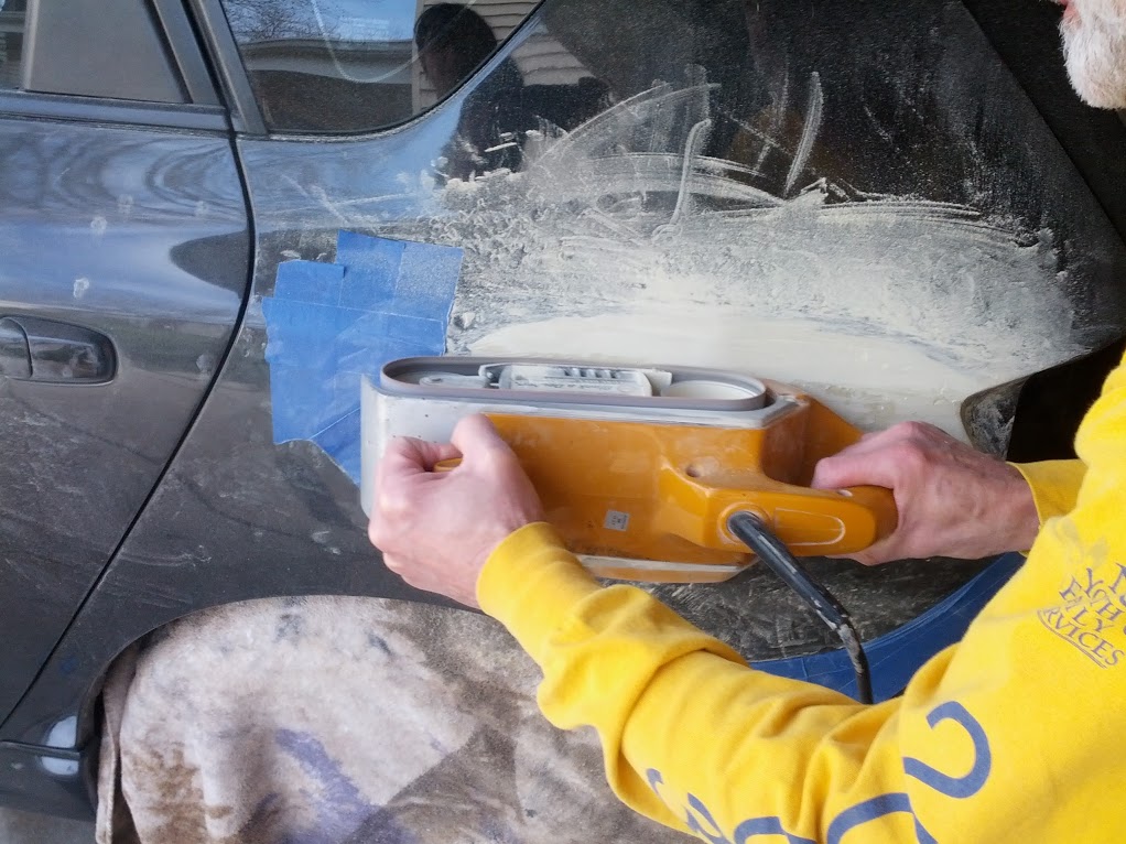

So this is the story of my first attempt at body work for your entertainment and/or consideration. If you know how to do body work, feel free to tell me how wrong I was, but whatever I post here is already done so it won't do much good now!

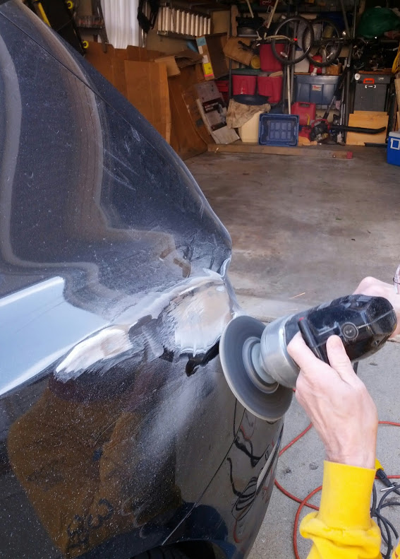

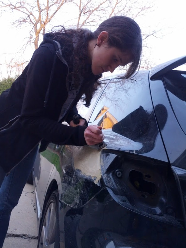

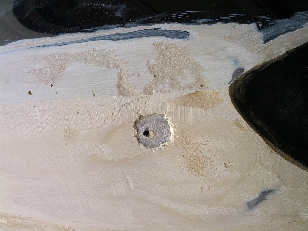

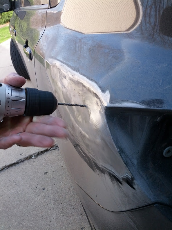

Yesterday we got started with the real gut-wrenching stuff. For me, this is where paying any amount of money for body work quickly makes itself worth it. It was about as difficult and desirable for me to do as it would be to anesthetize my own theoretical child and perform surgery with kitchen utensils.

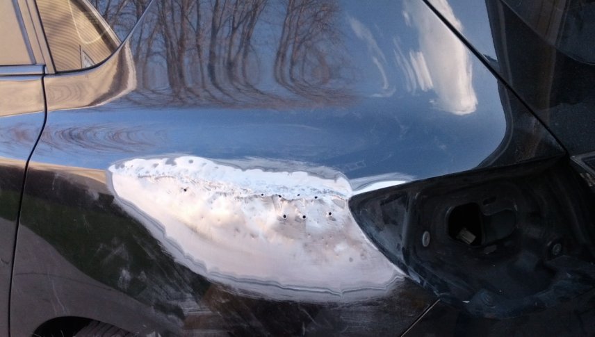

Sanding off the paint:

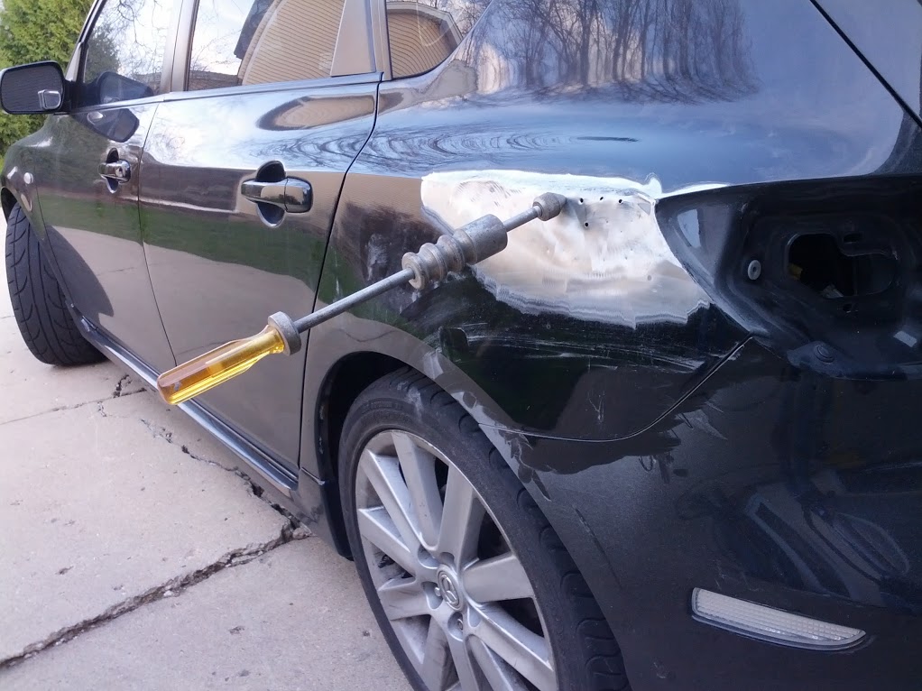

The original body line had been pushed above where it belonged, so we had to move (beat/pull) it back down without creasing the metal. We had to get it low enough that we'd be able to sculpt the original body line back in without the old metal protruding at any point.
Using the slide hammer and mallet simultaneously, we were able to get it close and low enough... Here's what we were able to shape the metal to before applying bondo:

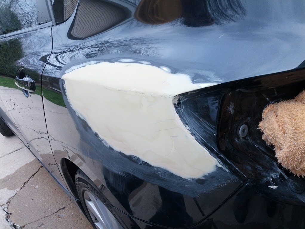

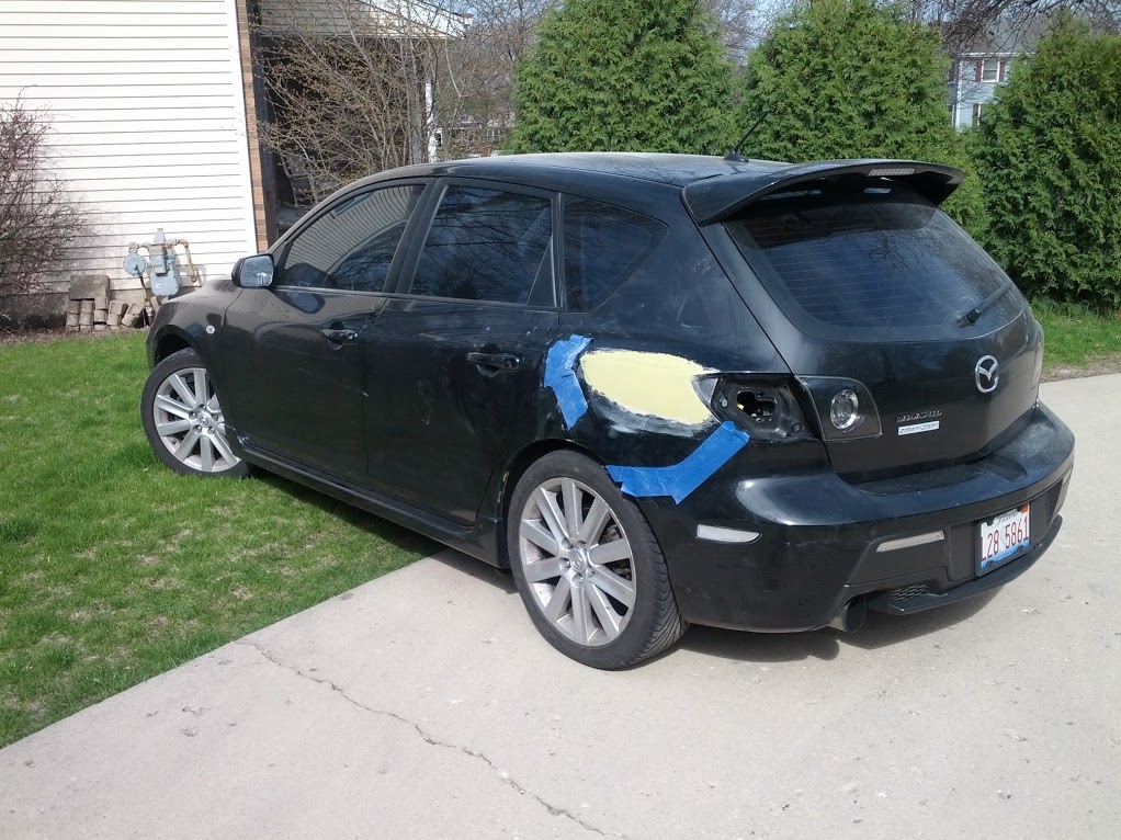

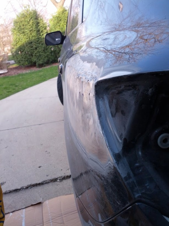

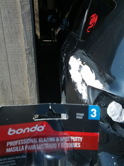

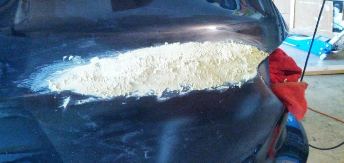

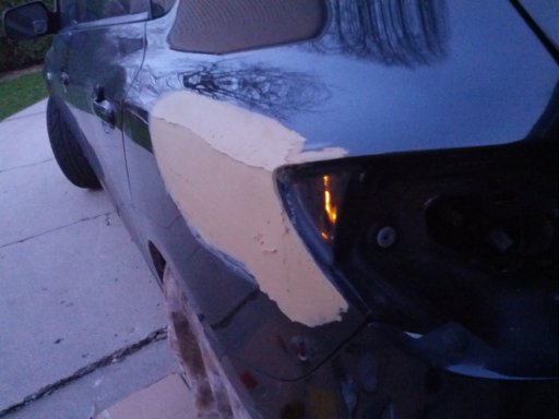

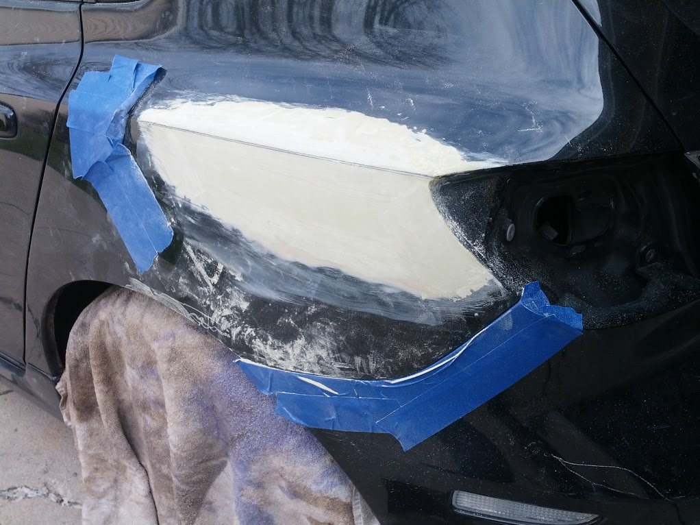

We applied 2 coats of bondo last night and filed it down to an approximation of where it was going to need to be:

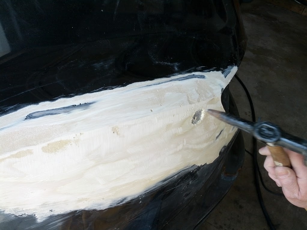

This morning we went back out and continued with the filling/shaping when my dad decided that there was a small bit of metal that was going to end up being too high. Using the small end of the mallet, he hit it back in so it would not protrude at later stages. As he was doing this, the metal under the bondo flexed and cracked several inches around the site. We chipped away all the cracked bondo and reapplied another few layers over it- testing for strength and flexion after applying this time. Thankfully it seems much stronger now (otherwise the paint will just crack and eventually chip off if there is any impact with the quarter panel at all).

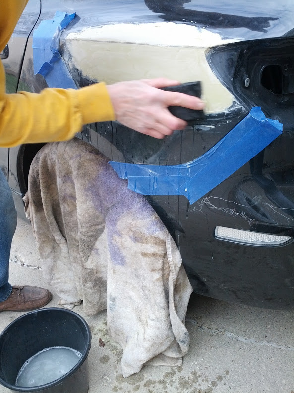

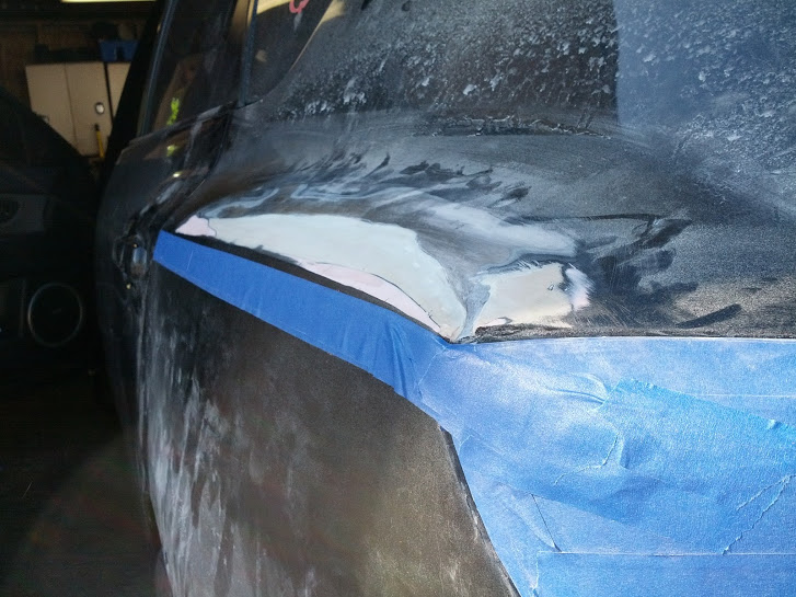

So we applied bondo. And filed. And sanded. And applied more bondo. And sanded some more.
Hell, even @MATT DAMOND; got in on the action.

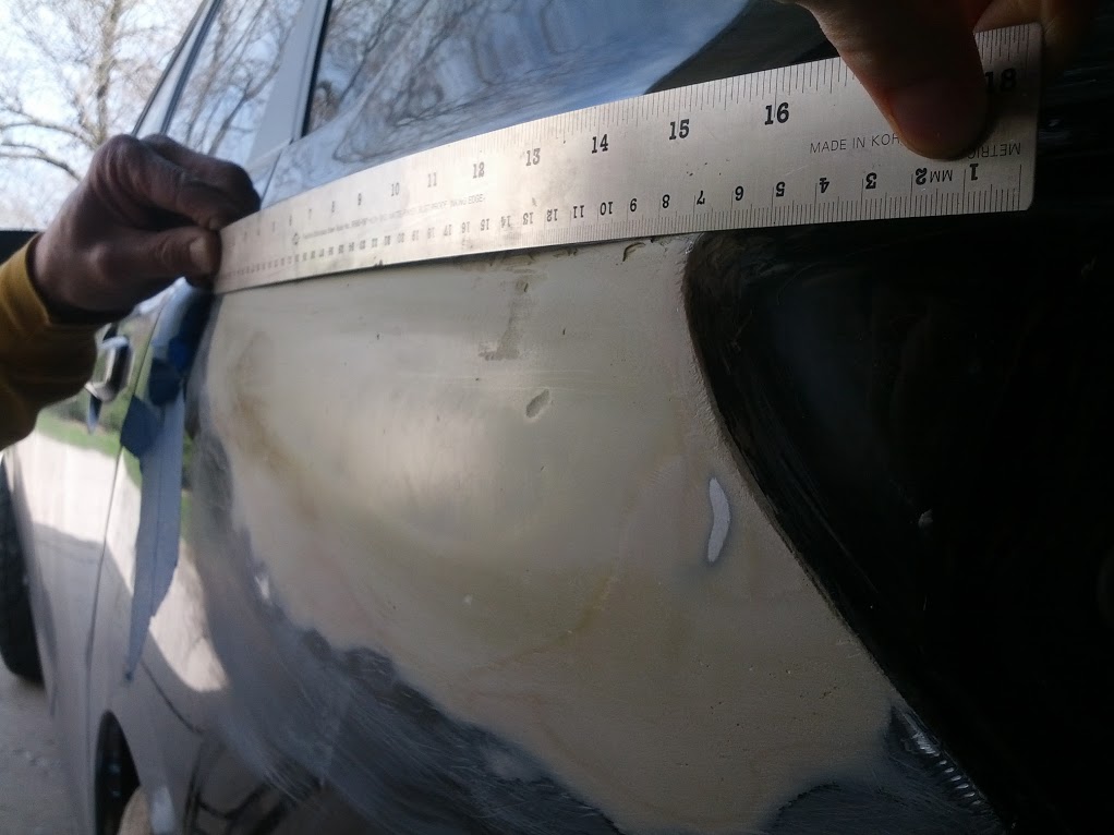

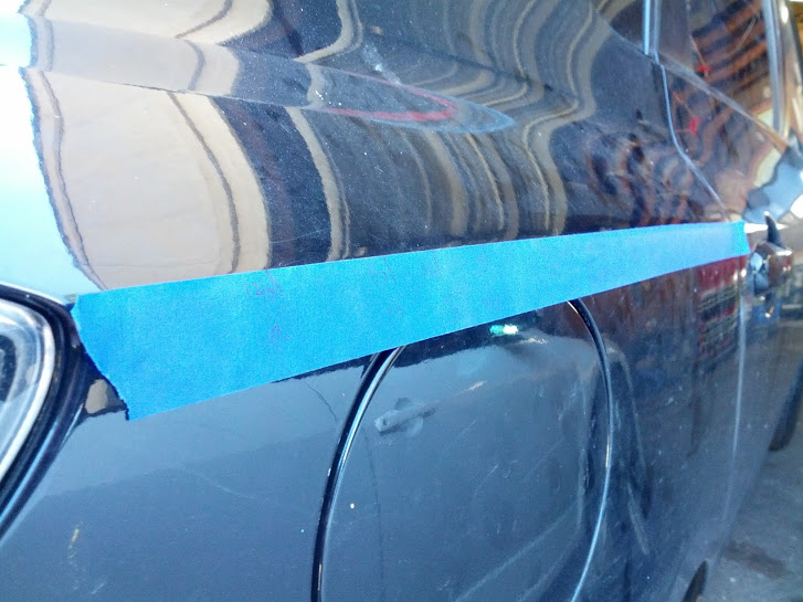

When we started getting close to the proper shape, I found a ruler and stenciled where the body line is going to need to be. This is certainly going to be one of the most challenging parts. I'm probably some sort of OCD perfectionist, so I imagine I'll get it pretty close to where it needs to be, even if it takes me 4 months.
Last coat of bondo drying in the sun:

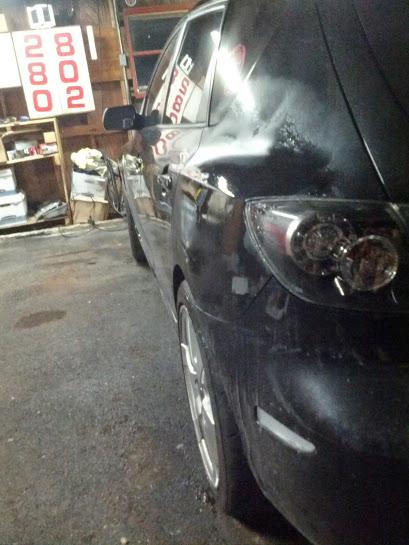

We started wet sanding after the last coat of bondo we applied today:

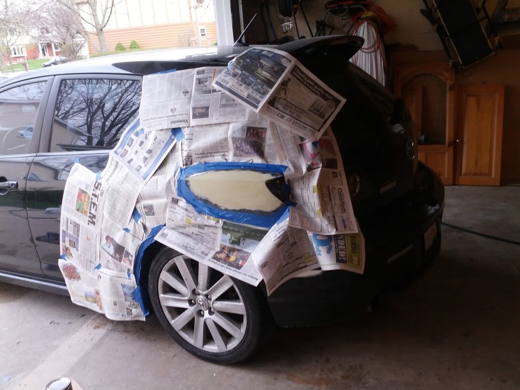

Then we got tired and hungry, and it was starting to get dark so we left off today with a shape that's not quite there, but it's starting to look promising!

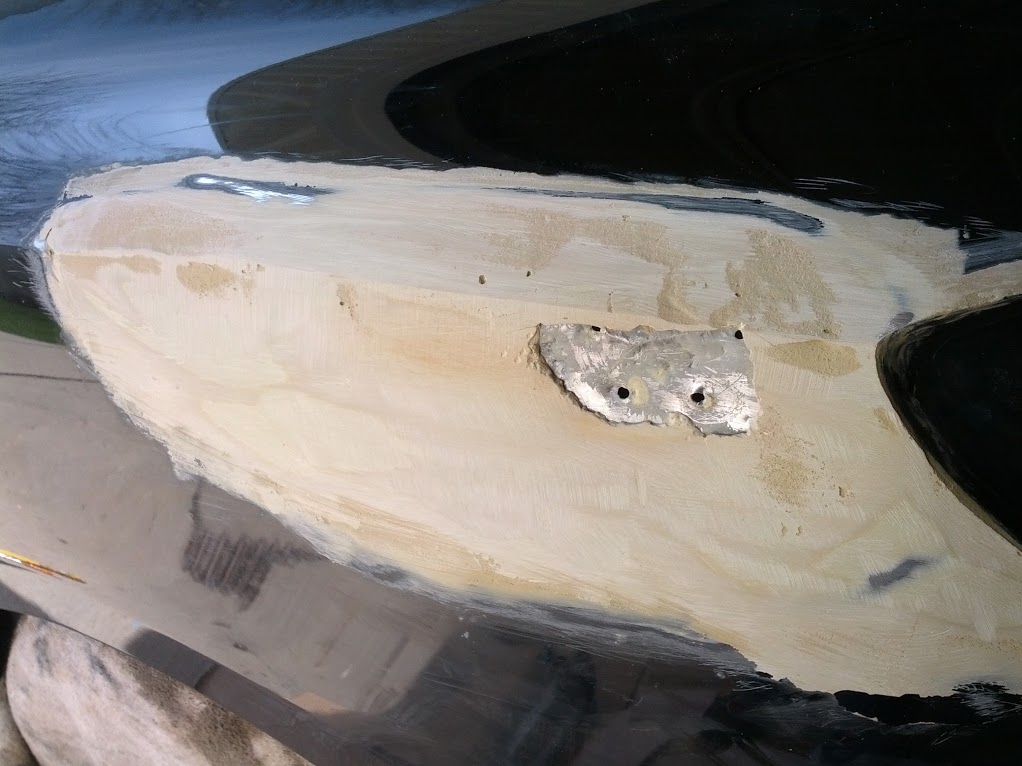

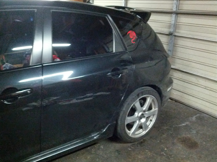

Last thing we did for the night- we applied a thick coat of primer to fill the small gaps, accentuate the peaks/valleys, and to protect it until the next time we can work on it. Tomorrow morning we'll spray it with some cheap Duplicolor metallic black paint to help protect it- just to hold it over until I have a chance to either paint it professionally or pay someone to do it.
Here's what it's going to look like until next time (minus the metallic paint).
While it's 2000x better than it was, the body line needs to be straightened out and given a lot more definition, and we still need to build some height above the tail light. But for a day and a half of work and my first time with body work, I'll take it! For now...

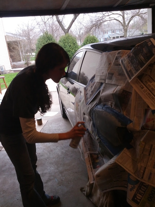

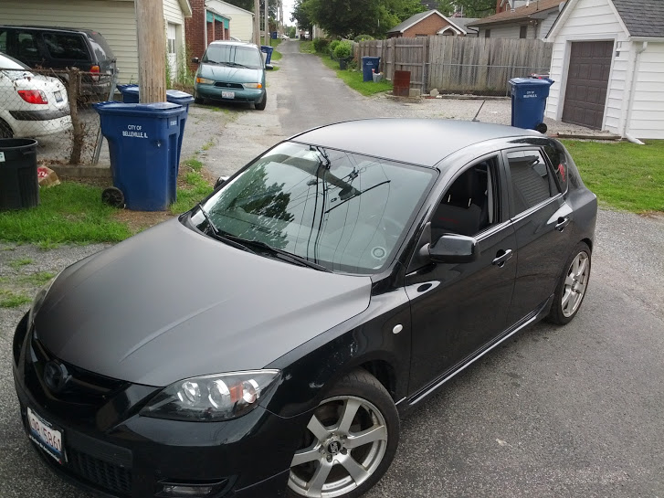

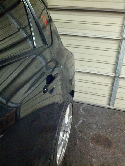

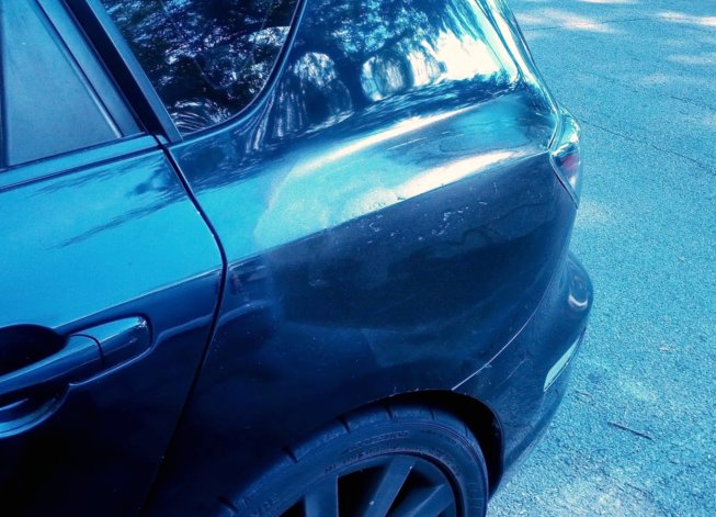

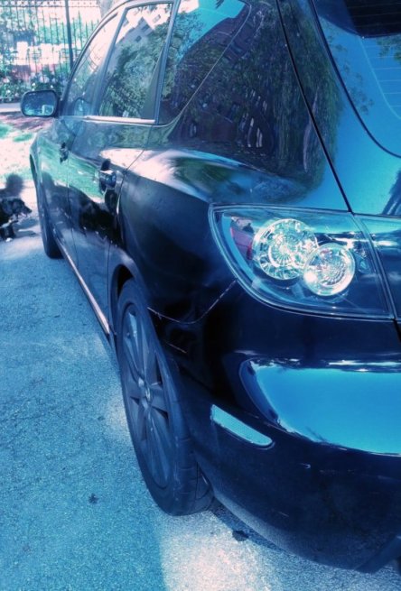

Cheap, quick, temporary spray can paint job to hold me over until we get to go with round #2 . Obviously I'll need to wet sand the edges off the job once its settled. Hopefully we'll get back to it within the next month though...
Again, not anywhere near perfect, but it's SO much better than it was before. I'm quite pleased with the progress.

Saw this thread when it was first made and debated making a comment, butt, what the hell.
The methodology is circa 1980. Yeah, been a long time since the punch a hole and stick in a screw/slidehammer era. Basically, what you have done is damaged the e-coat every time you punched a hole and are now looking forward to rust at each and every location. Particularly those of you in the northern climes. And to compound the problem, the moisture thrown up in the wheelwells will be absorbed by the bondo, causing it to loosen and fall off.
As was mentioned, a stud gun is the more appropriate method of pulling. Along with replacing the protective coating.
JMHO
YMMV
Actually, probably more like circa late 1960s-1970s. That's when my dad learned to do this. And he appreciates the stud welder feedback. If we/he ever have to do this again, we'll go with that route. As you said- what's done is done and I'll be watching for those things, but still hoping for the best. I guess we'll see how it goes.
Thanks for the warnings and feedback! This is my first time at it, so I appreciate being able to learn from this experience so it goes better next time!

You might wait until you're reasonably sure everything is as hot and dry as it can get this summer. The apply something like Rustmort (which is a rust converter) to the wheel well area from underneath. Then heavily seal it with some undercoating. Keep your fingers crossed that no rocks/debris punch through to bare metal.

Default Round #2
UPDATE: Round #2 .
My dad and I finally had a chance to build some needed thickness on the body putty yesterday. Unfortunately this meant messing with the line that was already pretty darn good. The first application didn't go very well. It was very hot and humid out and the bondo was curing unexpectedly fast (even when we mixed less hardener into it).
How NOT to apply bondo:
We sanded away at that until it was smoother, and everything that was going to chip off had done so, and then applied another layer. That one went a bit better so my dad started re-sculpting the shape and body line with the belt sander while I went to other side of my car to try and pull a small door ding I've been meaning to get to for some time now.
After several attempts and a 0% success rate, I gave up on the door ding and went back to look at the progress on the body line. Unfortunately, while the line was there, it was much less defined than it had previously been, and was bordering on being too narrow again. I guess it turns out that having a second set of eyes (more importantly- from a different angle) while shaping the body is somewhat of a necessity for anyone who doesn't do this every day. Despite the approaching dusk, he thankfully agreed to help me apply and shape one more coat of body putty.
With my coaching, the shaping of that layer went much better! We didn't have as much time for micro-adjustments as we did the first time, but this time I still have a decent amount of extra depth to take off for further sculpting. That means I can now go out and wet-sand it on my own time (I still street-park it) without having to borrow a garage or power sander. I'm looking forward to being able to make progress on it much more efficiently now. After I get the bondo is shaped relatively perfectly, I'll move onto applying glazing and spot putty to fill all those little chunks/holes/imperfections, and then [real, multi-stage] paint!
Here's where it's at now. A few things that are better, and a few worse than before, but a lot more promising overall!

Round #5 ?
I might just have it. Maybe. If all the bondo keeps holding.
I've run into a few problems along these last few passes, and have created a few for myself, driven by the OCD perfectionist in me. Learning when to say when is always the toughest struggle with these things. Anyway, after having to chip away more bondo again (twice), and re-create the line (again), I might just call it a wrap. Or rather, ready to be wrapped. I'm vinyl wrapping the whole car when I'm happy with the bondo work, to avoid any mismatched paint situation. After what I just did, I don't think I'll have too much trouble getting the wrap to look good. I'll link to a new thread once it's started/complete.
Anyway, here's some pics:
To get the body line right, I took measurements from the good side, up from the outermost point where the bumper connects to the fender/ vs. the distance back from the door of each measurement. I then mirrored these onto the bondo and taped if off about 1/4" about that line, so the sanding I did would allow the line to form naturally.
I was quite a ways off:
More Sanding.
I used this stuff to fill in all the little divets and imperfections as I neared completion.
OH. And this sanding block made ALL the difference in getting the upper, concave portion of the curve to be completely smooth and flowing! It was nearly impossible to do with a flat sanding block.
And finally, 4 days of bondoing, sanding, primering, sanding, bondoing, sanding, and primering later, I arrived here:
BEFORE/AFTER:
All in all, I'd say it's respectable.
VINYL WRAP TO COME!!!
