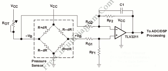

Okay, so i can open the datasheet at work.
The sensor is a wheatstone bridge... basically 2 voltage dividers, one with a variable resistor that changes with pressure. The difference voltage (usually less than 20mV) is amplified through some op amp gain stages and conditioned a bit i bet. That's why there's a pull up resistor on the signal line.
The amplification stages (op amps) run off the supply voltage, 5V according to the datasheet. And their maximum output is dependent solely on the supply voltage. There are two main types of single supply op amps, one's that can swing to only the low rail (ground) and about 1 diode drop below the high rail (like 4.5V), and then there are some that can swing completely to both rails. IIRC the ones that need to be able to sink an appreciable amount of current (like this one if they're saying you can use up to 16V as a pull up on the open collector output) usually don't swing all the way to the high rail, but i could be wrong. I'd have to check my electronics book at home.
Usually they will just flat line at a certain level.
Marcus... is the over drive part of the datasheet your talking about in the technical data section? Where it says, " Max. overpressure = 180 bar"? Cause in my mind that means the max amount of pressure the sensor can see before it becomes damaged or un calibrated. The other pressure is "Rupture pressure = 300 bar", which i interpret as physical rupture of the device.
On the characteristic curve graph... it does show the dotted line to 4.8V, and translates to upper area for signal range... but i'm not sure if this is evidence enough to say it'll read that high.
I'd like to see some SB logs with some readings over 4.5 V.
Also, judging from the way the AP will just clip the reported pressure, makes me think there is a hard voltage limit to the out put of these sensors.
I think the easiest thing to do at this time is just pick up the higher reading sensor, and put our energy into correlating some voltages to pressures between the two.

If anyone has a spare sensor taking it apart is not too tough. There is a pressure transducer in the tip (variable resistor essentially) and a potted PCB inside the casing.
In heavy duty applications all sensors must be able to take above battery voltage even if they are rated for 5V and not break. This is a safety and reliability requirement and I am not sure if the same one exists in passenger vehicles. It seems that it may be the case.
Edit: Here is what it likely looks like inside. The diamond like resistor setup is the wheatstone bridge.
Edit 2: Better diagram.

On the other hand, the effort is probably better spent at adapting a new sensor and translating the voltage/pressure curves correctly to the control system so it can make use of them.
