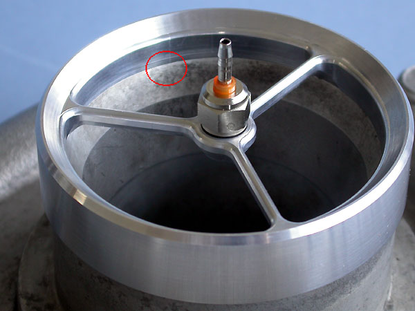

I'm working on a pre-turbo methanol injection setup for my little stock turbo that I should have done within the next couple of months. The general consensus about spraying pre-turbo is that it increases the efficiency of the turbo so that's it's good for additional boost and further reduced BATs.
Most of the controversy seems to revolve around compressor wheel erosion, but stock turbos are so inexpensive, I'm not at all worried about the potential for having to replace one eventually. I've already got a spare ready to go. Also, if done properly, with the nozzle on axis with the shaft, and directly in front of the wheel, erosion is negligible to nearly non-existent.
I'll be swapping my manifold-mounted D05 nozzle for a D03 and using an AquaMist .3mm nozzle, which is equivalent to an D02 nozzle, before the turbo. Total spray volume should be the same, just injection location will be different. If it works well enough, I may even ditch the stock intercooler entirely. I'm thinking that I may be able to daily drive with 22 to 24 psi on the stock turbo with this setup. SST turbo guys should be able to push even higher.
The nozzle holder looks like this:
Here's my favorite article on pre-turbo injection.
Here's the place making my nozzle holder for me.
Here are the dimensions of the stock turbo inlet.
What do you guys think?

Looks rad adam, haha radam. Lemme know how well it works. Also where/how do you plan to route the tubing into the TIP?

A double ended nipple, one outside and one inside to attach to the sprayer nozzle maybe?

Would work i guess. It would be nice to have zero "free parts" that could come loose and lodge in the compressor. Like maybe running a single tube out through a compression fitting (to serve as an air lock). That way you don't have to tie wrap or hose clamp (free parts) the tube onto the inside nipple.
I may simply pierce the 90* silicone coupler on my custom TIP, and silicone it up. The AquaMist tubing is just over 1/8", so it's not a huge hole. It's either that or pierce the stainless tubing and silicone it up. Something simple and effective.
I've thought about that too, but I want to keep flow obstructions to a minimum.

How do you attach the jet holder to the turbo, and run the line to the jet?

The nozzle holder will sit on the actual turbo inlet and be held in place with a 2-1/8" coupler. I'll probably cut the coupler flush with the end of the nozzle holder. I may use some rubber cement, or something similar for extra security.
The outside diameter of the 2-1/8" coupler is 2-1/2", so I'll use a 2-1/2" to 3" 90* coupler attached to a stainless 45* bend to complete my custom TIP. Of course, I'll have a 1-1/8" tube welded to the 3" bend for the BPV recirc.
As far as the tubing, it's small, 4mm tubing, so I think I'll just pierce the 90* coupler, run the hose through, and silicone it up. It's simple and secure.
Originally Posted by AFcadet View Post
22 to 24 psi on stock turbo???
I was running 21 psi for like 6 months...and after I blew my motor I checked the stock turbo and there is a good amount of shaft play. Its just a short matter of time before the turbo was gonna go. Im really thinking its from running that high of boost. Those VW articles on the K04 was sayin anything higher then 18 psi and youll start heating up the turbo to much and starts to deform the shaft.
After seeing the shaft play in my turbo that was ran at 21 psi...I beleive it.
I'm going to monitor EGTs, and hopefully the meth will keep it low enough to keep the turbine/shaft from melting or drooping. If it works, great, if not, I have a spare turbo.
If I do a PG or PTP rebuild, I may get all the components cryo and WPC coated to aid longevity. At that point, I may be better off going to a Garrett turbo though. At this point, I'm just interested in seeing what the absolute power limit of a totally stock turbo is.
KoukiS14 is offline   Reply With Quote
I cannot wait to see this setup... are you using a stock turbo inlet pipe, or a modified one? The TIPs that are made of silicone like the Cobb and CPE inlets probably will flex too much to just glue the line in place, although maybe rubber cement will work well. I'd actually suggest you glue something like part #806-359 on this page: Howerton Engineering Aquamist Parts into the intake. The reason being that if you ever want to swap the jet, you will have a hell of a time getting the hose off the jet and its a lot easier to slip it out of a fitting like that. And trust me, you're going to be playing with different sized jets.
