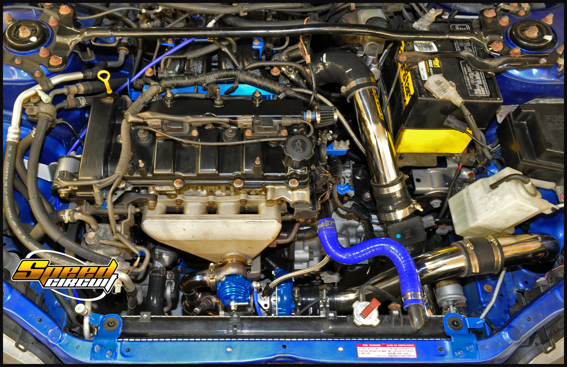

You can get a Vent to atmosphere BOV but it would be better to recirculate. You are not going to hear anything on a stock car since it uses a bypass valve, not BOV.
Also that turkey sound is compressor surge. Its a problem that effects all MSP's. Even with an aftermarket intake and BOV you still might get it. I relocated my MAF and moved the BOV closer to the TB and it still does once in a while.

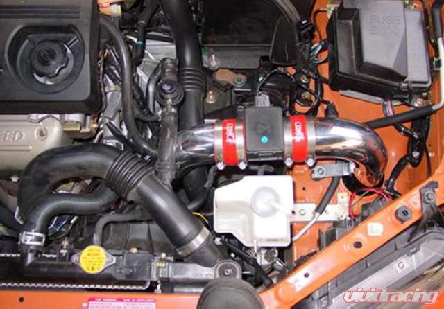

the final word
YOU CANNOT VTA WITH A BOV WHILE HAVING THE MAF IN THE STOCK LOCATION.
you must relocate to fully vent.
you could do hybrid..vent and rec, but that's just ghey.
now, if you don't have hardpipes or a FMIC, forget VTA cuz you wont
this is what you would need to relocate and VTA
oh and google man...google that shit..took me 10 seconds to find the answer...this car is from 2003..believe me, everyhting that coulv'e been asked..has been asked.
