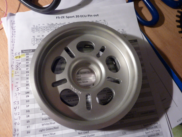

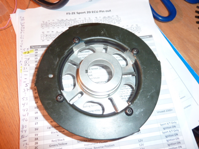

Problem 1 was the trigger wheel for the crank sensor. JDM uses only 4 tooth while USDM uses 36 tooth. So I had to press out an original trigger wheel from a crank pulley, and modify it to fit a medieval pulley. Here are the results:

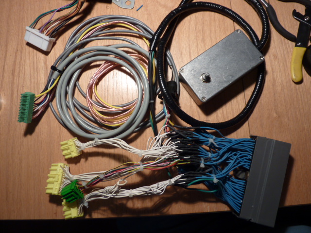

Next up was mating the USDM wiring harness to the JDM ECU that I just picked up. So I went out and got one of those AEM Adapter harnesses, I also found PCM test harnesses from Ford and cut those up also. I wired in the harnesse for the shift improver and for the J&S Safeguard and this is what came out of it all:
