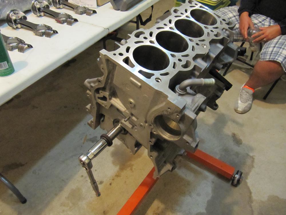

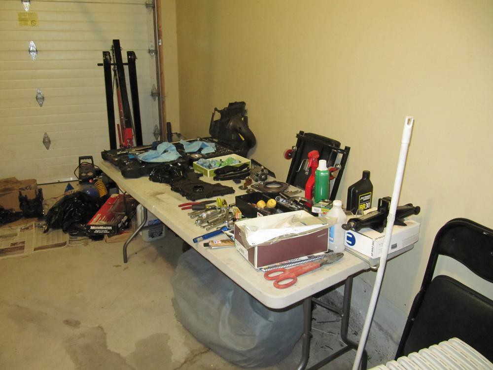

Prepare your workstation and put the block onto the engine stand.
Lay everything out neatly so you know where it goes. By the end of the assembly, your shit will be everywhere but at least you tried, right?

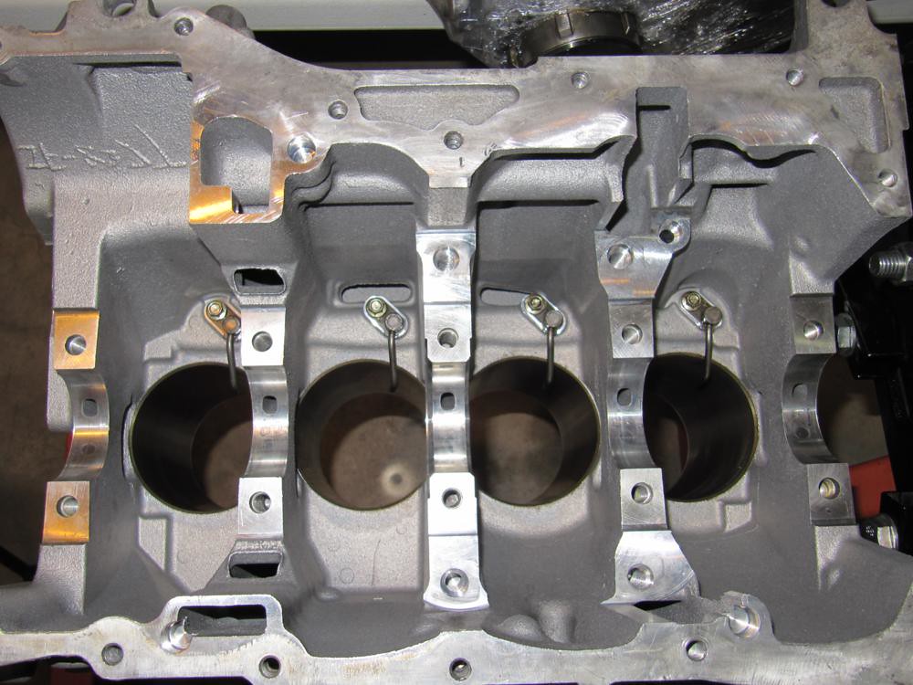

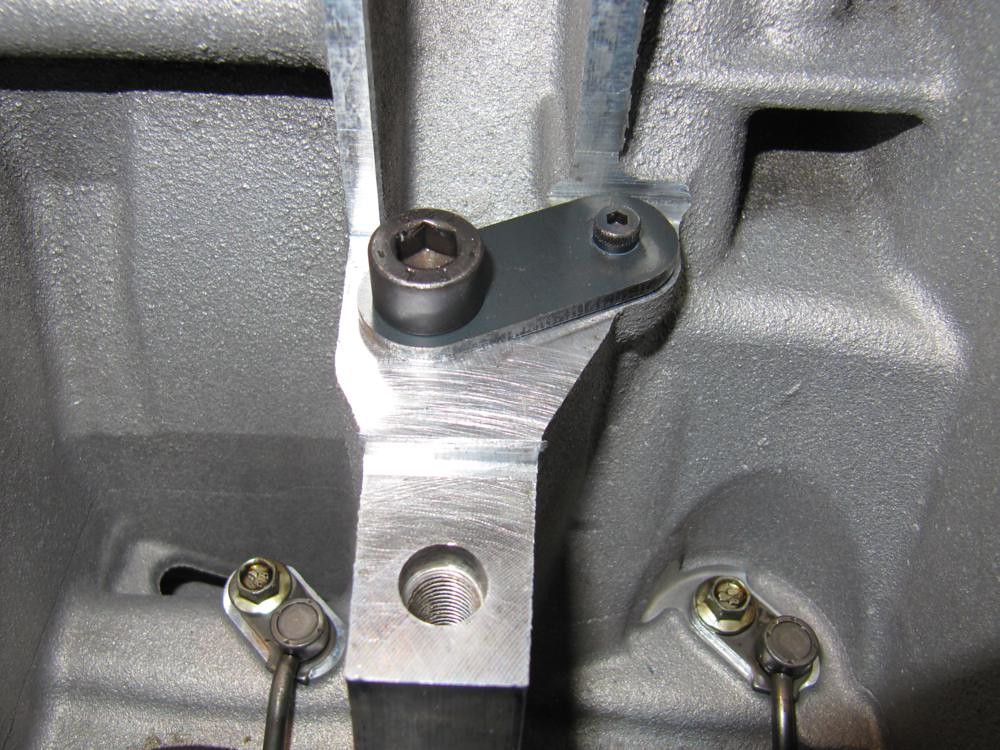

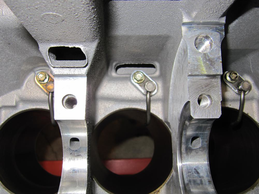

Grab the oil squirters and attach them to the block. With the Wiseco and Carillo setup, I had to slightly bend the squirter further to the center so the piston skirt wouldn't make contact. Don't bend them too much as you may weaken the metal.
Prep balance shaft delete kit and install it. I put some threadlock onto the bolts for peace of mind.

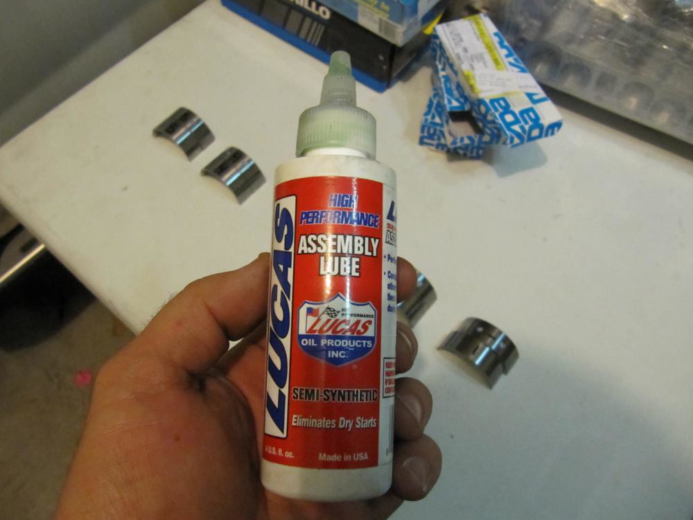

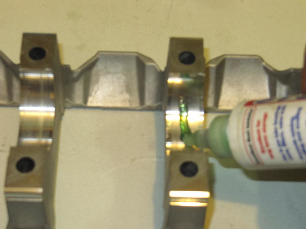

Grab some assembly lube and with your finger, spread it onto the bearing journal on the block.

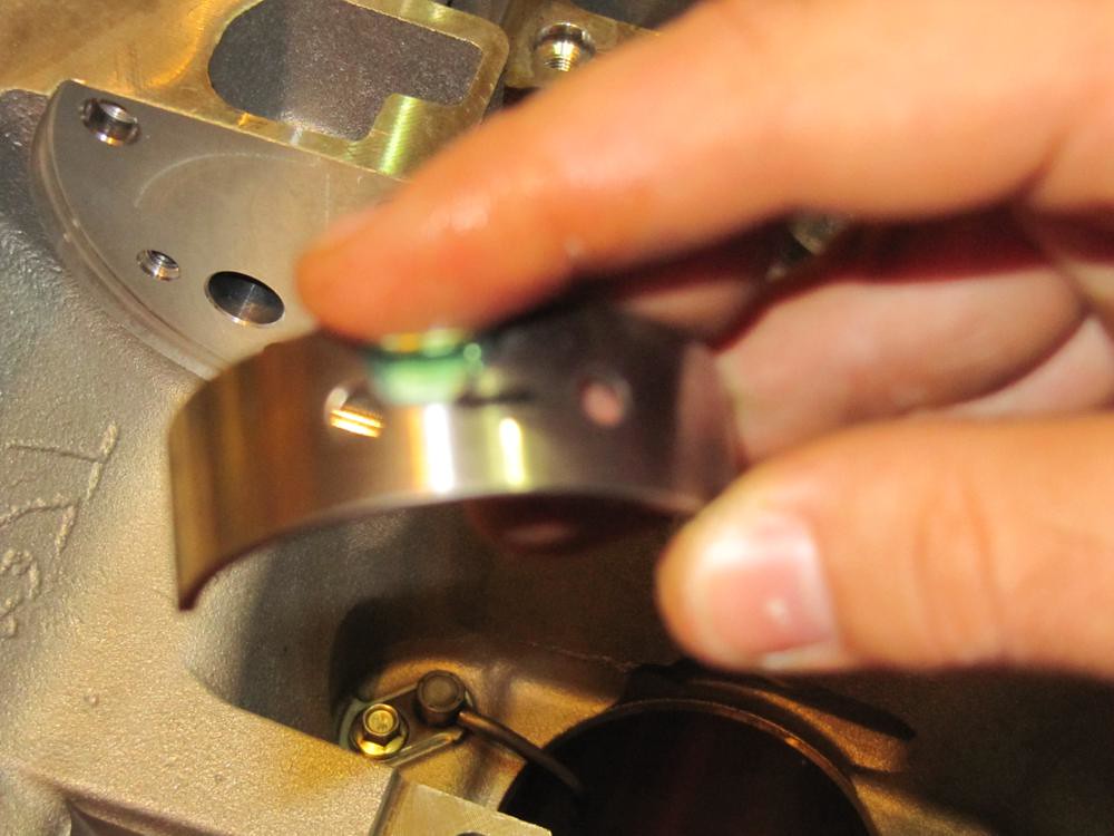

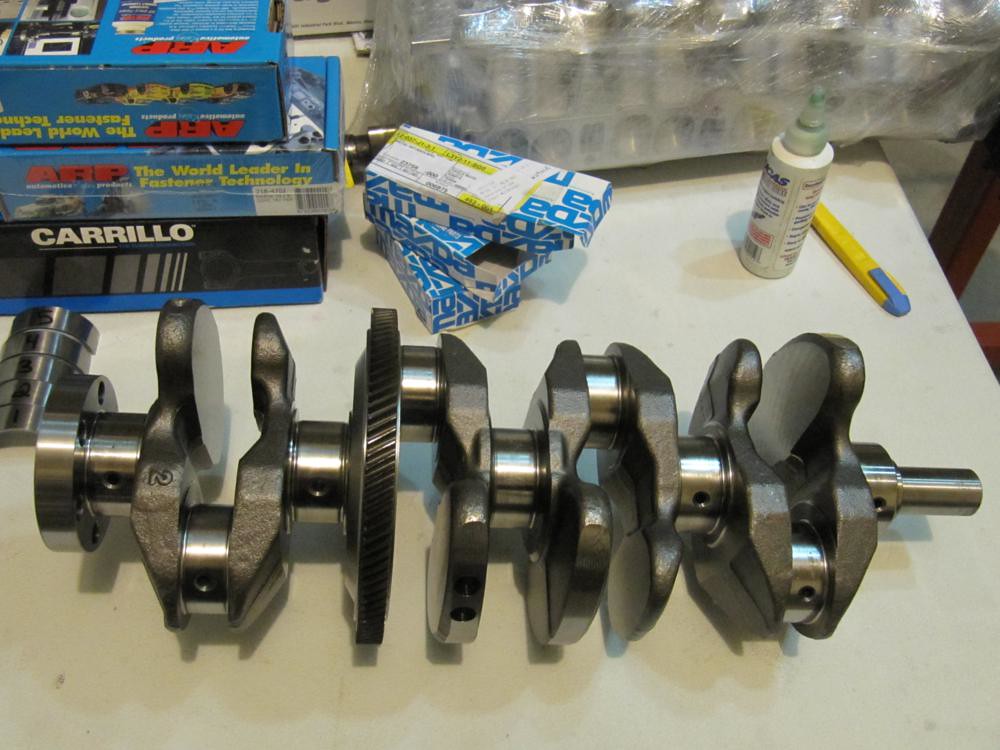

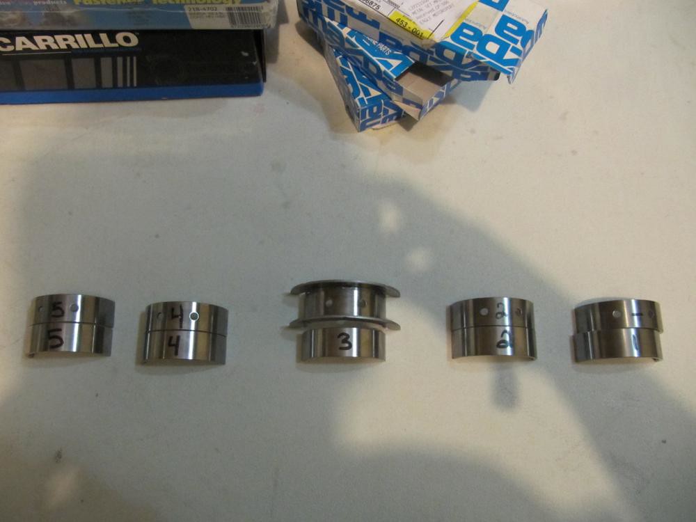

Lay out the main bearings in order. My engine builder (Competition Automotive) numbered them from 1 to 5. Bearing number 1 goes at the front of the engine (timing chain side). The bearings come in two pieces; ones with oil passages and ones without. The halves with oil passages are positioned on the block side and the halves without get positioned on the girdle side.
Also notice that the half with the oil passages on bearing 3 is different. This is the thrust bearing and gets mounted on the block side (as mentioned earlier).
Grab the bearing halves with the oil passages, apply assembly lube on the inside of the bearing with your finger then position them on the block. Make sure they are properly centered in the journal.

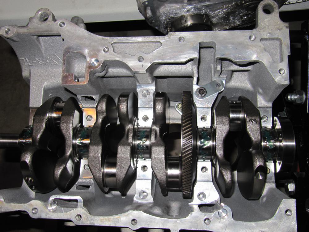

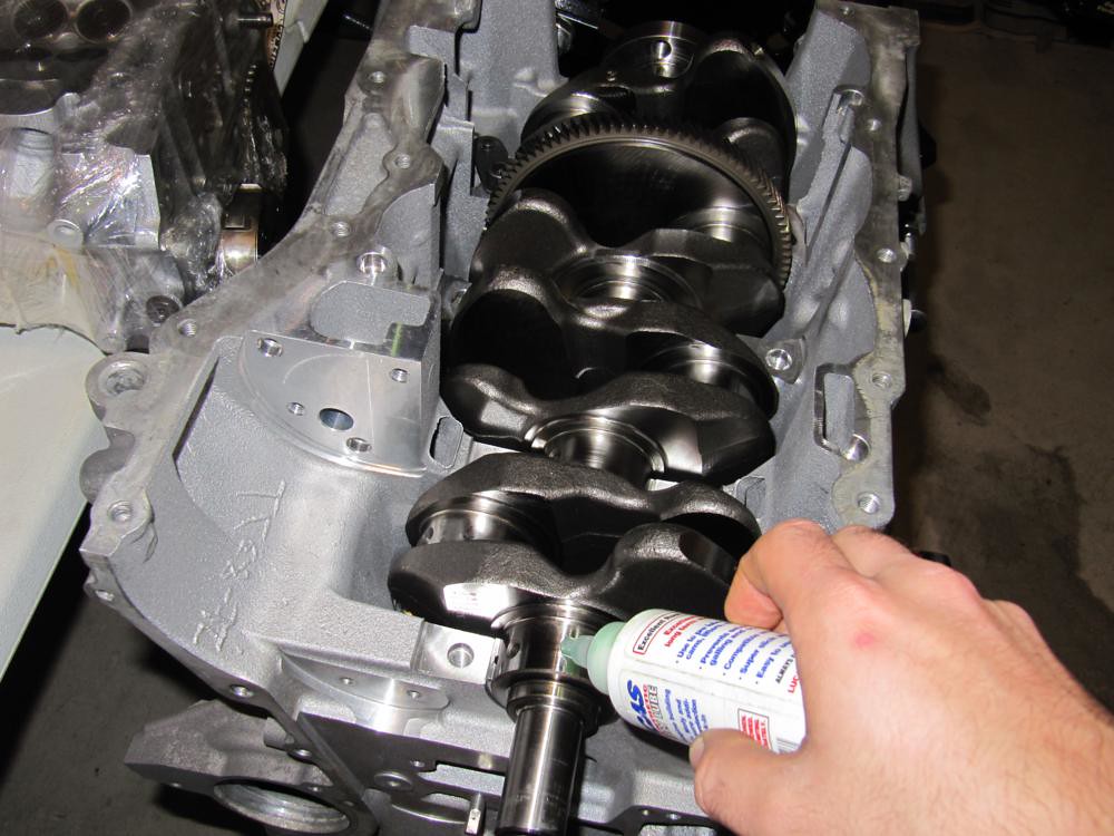

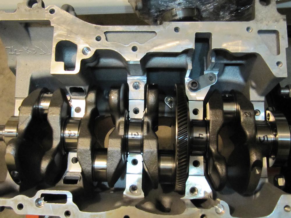

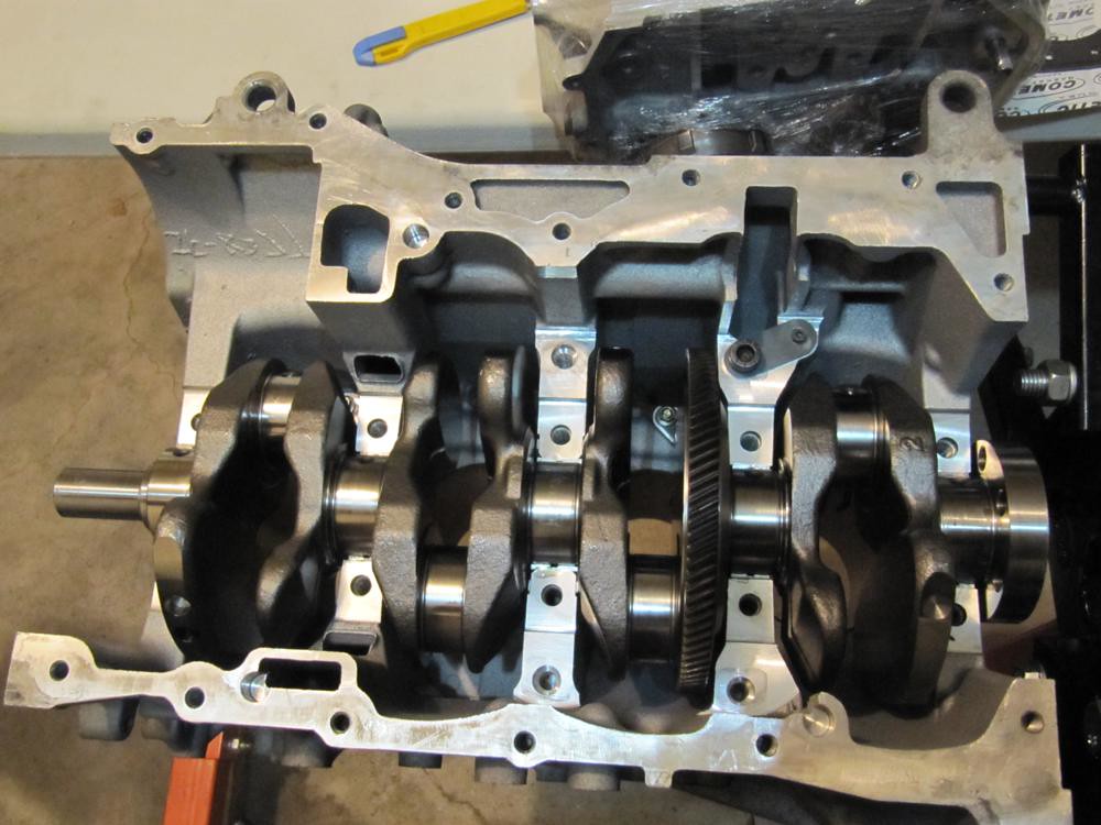

Next, grab the crank and drop it in (slowly!).
Apply assembly lube onto the main bearing portion of the crank in preparation for the other bearing halves.
Position the bottom halves of the bearings onto the crank in numbered order.

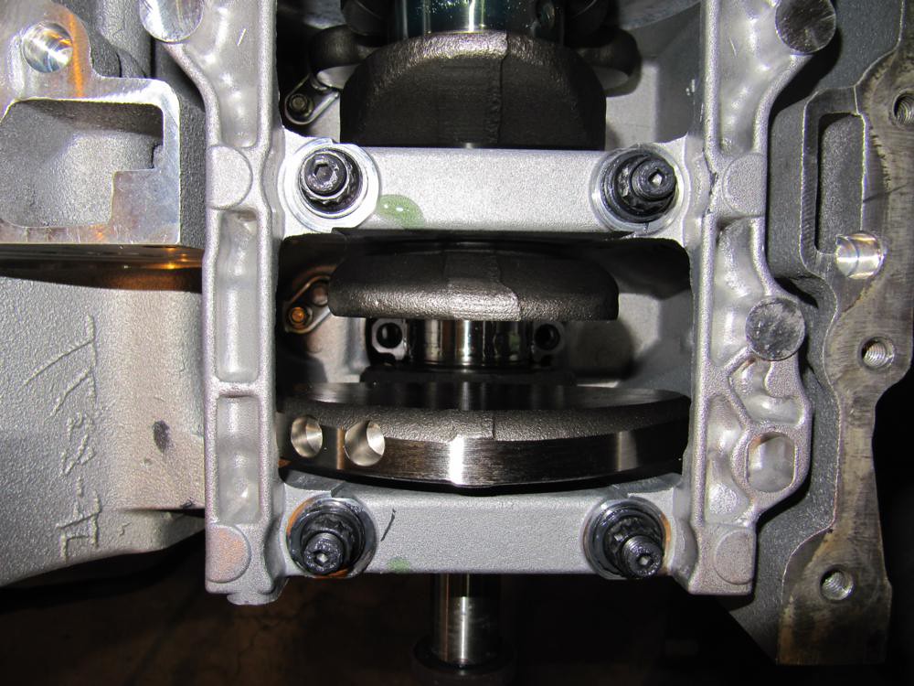

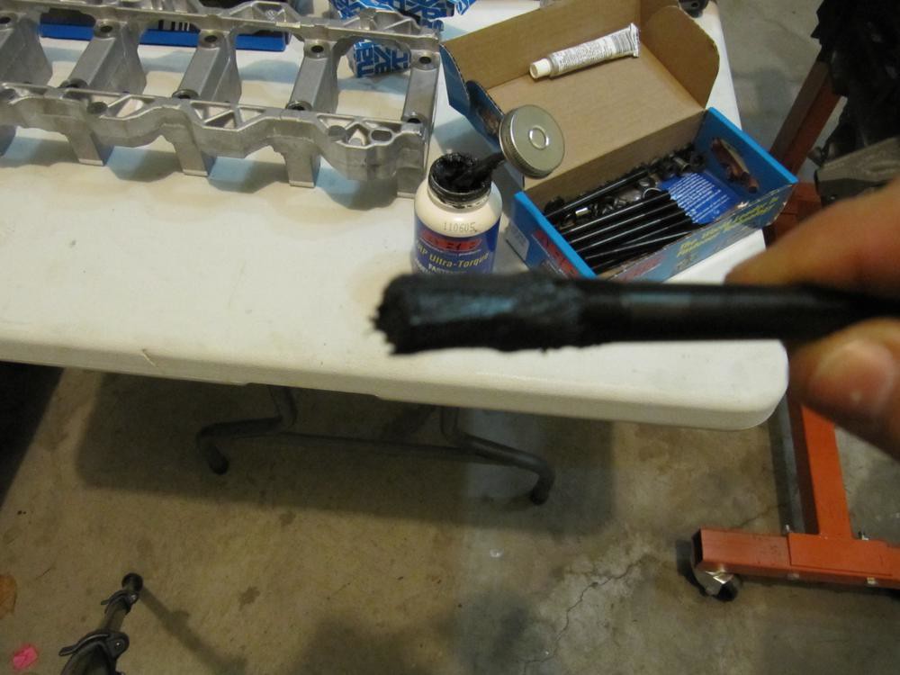

Grab your ARP MAIN studs and apply a generous amount of ARP Ultra-Torque lube onto the threaded portion without the hex shape on the end. Thread the studs into the block.
There are 10 main studs total. I found that it took a while to thread these things in without some assistance so I grabbed the proper hex head, put it on a screw driver handle and went to town. Be sure that you thread the studs all the way down until they stop. DO NOT ADD TORQUE TO THE STUDS ONCE THEY BOTTOM OUT AND DO NOT USE POWER TOOLS. If you do either, you should be slapped.

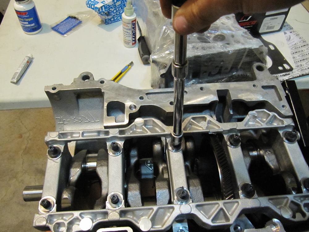

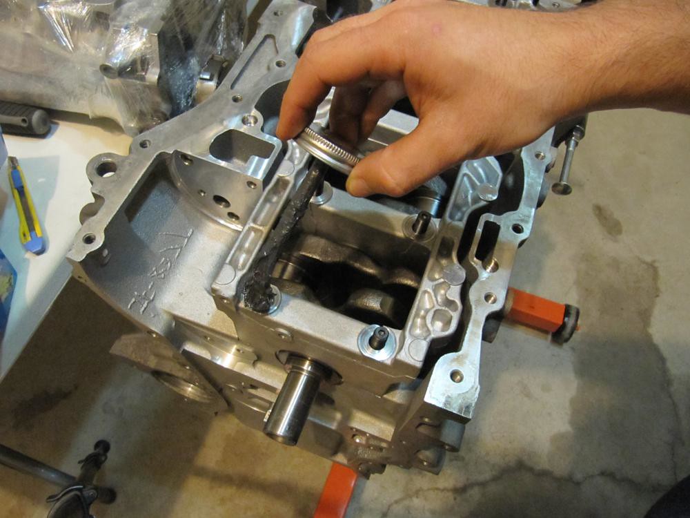

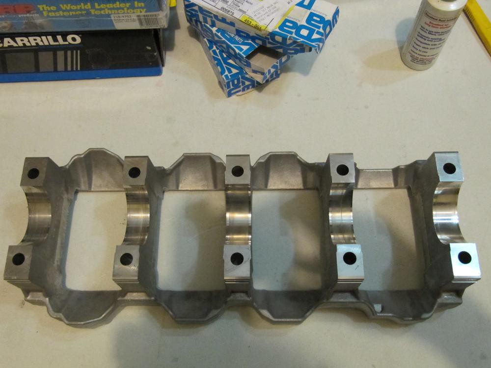

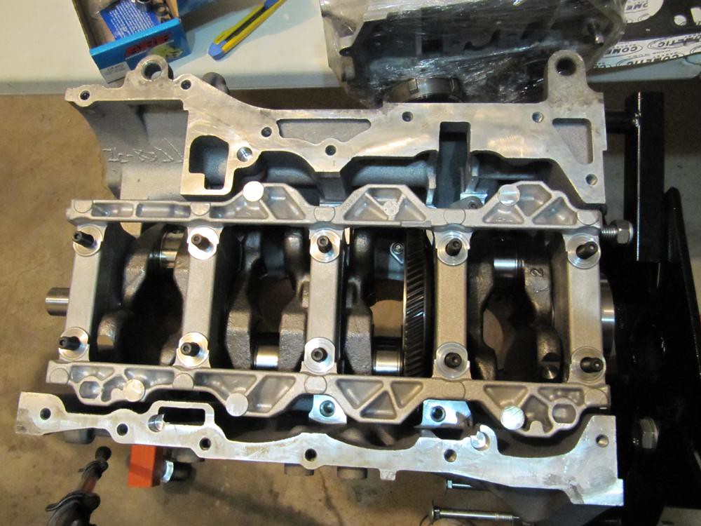

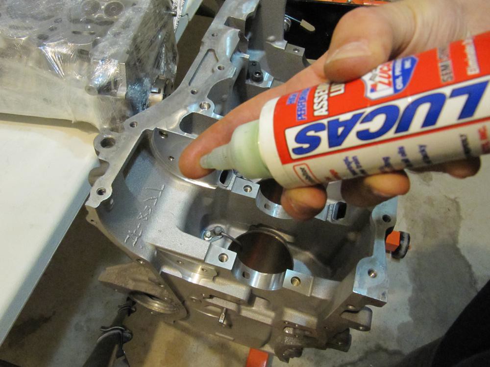

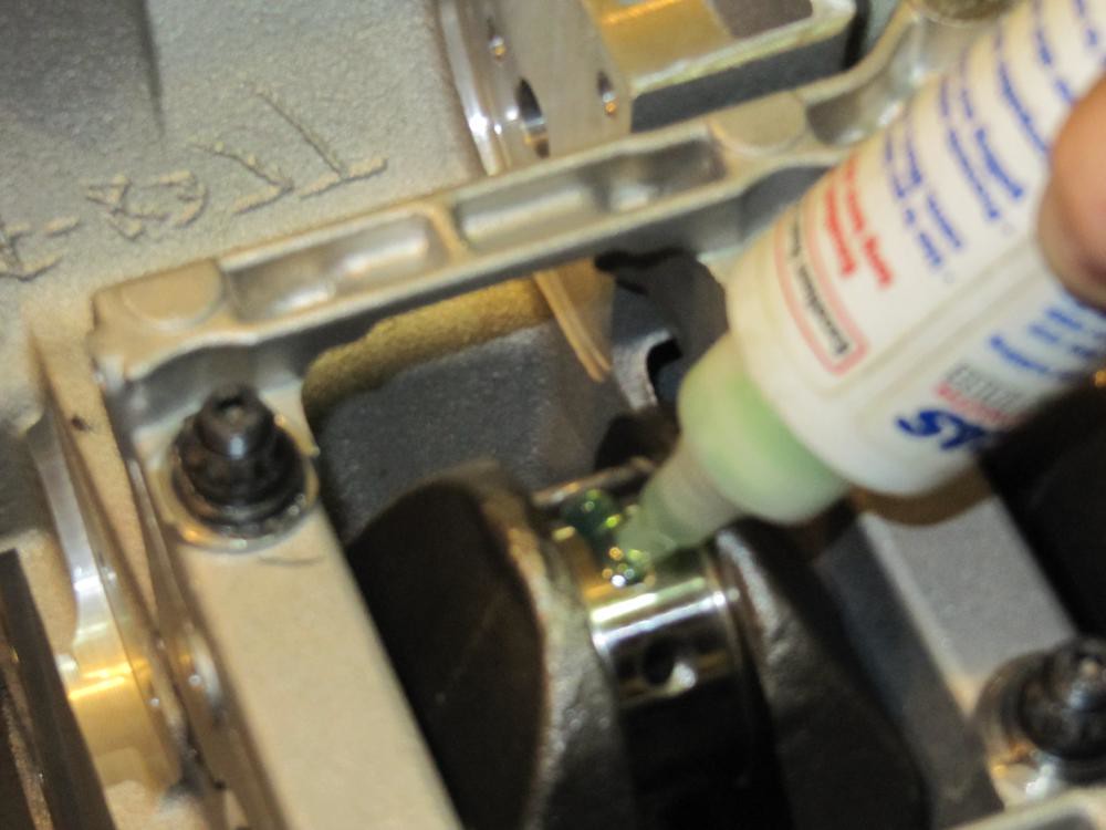

Apply assembly lube to the girdle journals. Don't be stingy but don't go nuts (this applies to using the lube on any necessary surface on the motor).

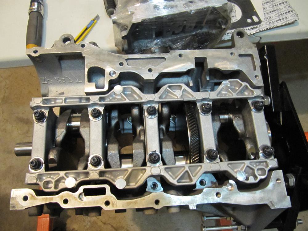

Gingerly align the girdle onto the studs and drop it in. The girdle only fits in one way without resistance. If you fail at putting together a puzzle, don't assemble a motor.
Grab the ARP Ultra-Torque lube and apply it liberally to the stud tops. Then, insert the washers and nuts accordingly. Hand tighten them down.

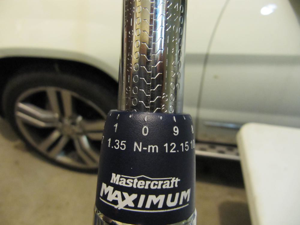

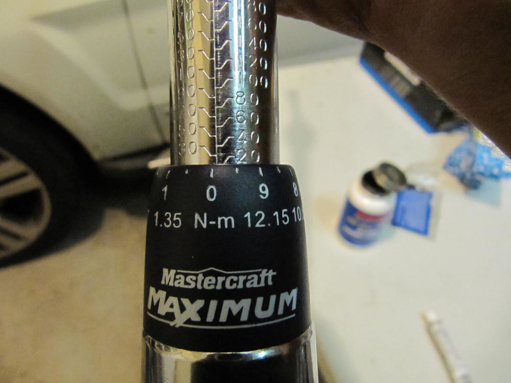

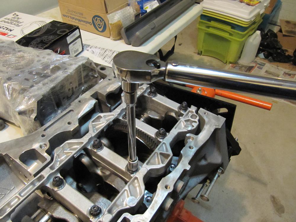

ARP recommends tightening the girdle down in 3 passes to a maximum of 60ft-lbs.
Ensure you tighten them in the proper order (pictured below) in 20ft-lbs increments.
The crank is now securely fastened. Rotate the block upright for the next phase of the build. Also, grab your old crank pulley bolt and thread it into the crank; it'll become quite useful.

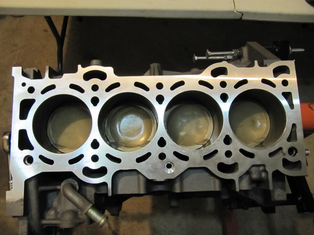

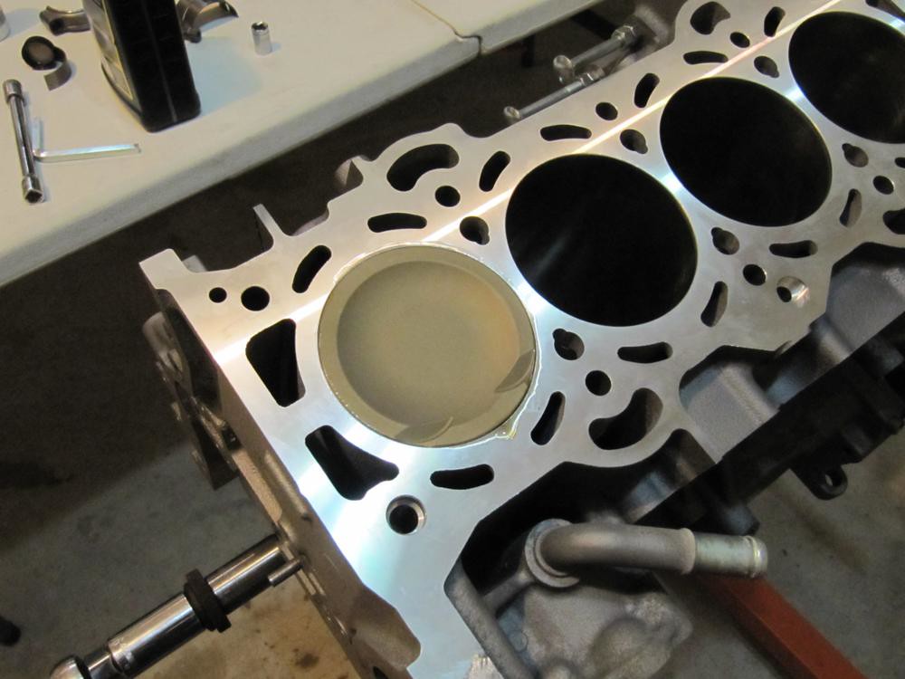

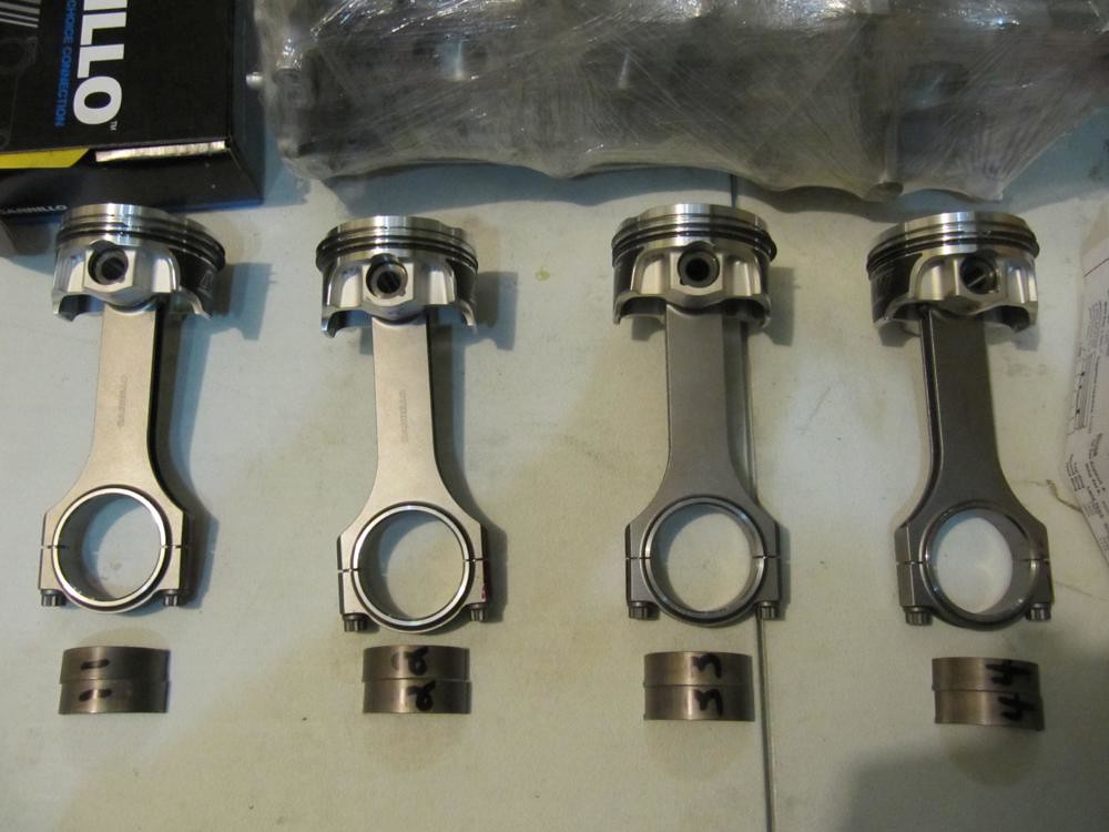

Lay your piston/rod (with rings) assemblies and corresponding rod bearings onto a flat surface. I had Competition Automotive assemble the piston to the rod for a small fee. On the second motor (pictured here), the also put the rings on. Unfortunately, I don't have pictures of the ring install from the first motor so I'm going to skip this step.
Grab piston/rod number 1, remove the rod cap, apply lube to the inner AND outer portion of the bearing halve for rod 1 and press it in. It'll require the tiniest bit of force for it to seat properly. Note the notch on the upper right-hand corner of the rod and the corresponding notch in the bearing; they only seat one way.

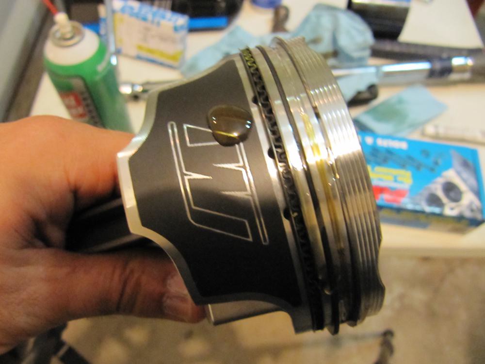

Apply some motor oil to the outside of the piston. Don't be stingy but don't go nuts; apply enough.

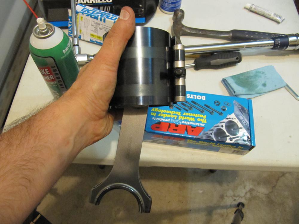

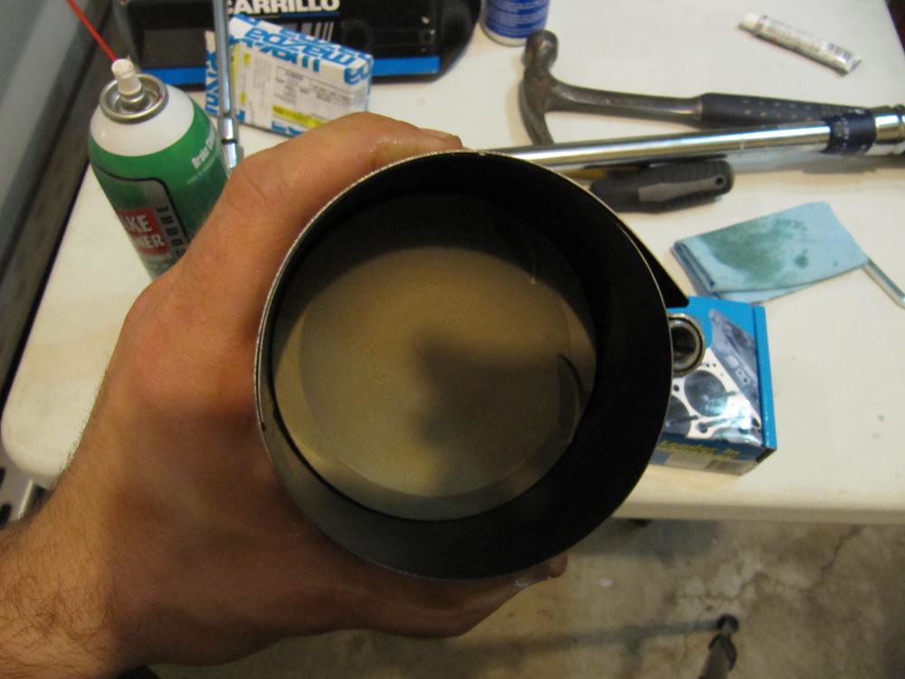

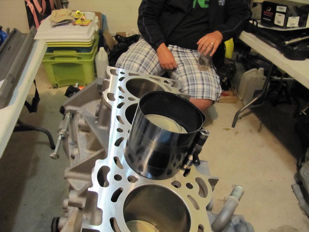

Then, position the piston/rod combo into your ring compressor tool. Ensure the piston top is parallel to the top of the ring compressor and that the piston skirt hangs out juuuust a little; it'll help with alignment.

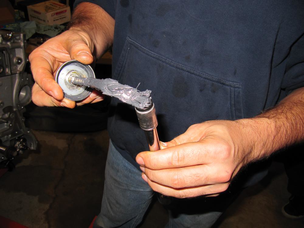

Stuff a shop towel down the cylinder bore to prevent the rod from nicking the crank when it drops in. Lube the inside of the cylinder wall with some motor oil then position the piston/rod combo with ring compressor on top. Ensure the ring compressor tool is perfectly centered AND that the valve reliefs on the piston tops are facing the PCV/water pump side of the engine.
While holding the compressor tool with one hand, use the rubber handle of a hammer to gently tap the piston/rod down the cylinder bore. Competition Automotive said I could do it in one shot but I was too much of a wuss to do it that way; I went with the multiple-gentle-tap method. (not pictured unfortunately).
IF you feel any sort of resistance while trying to tap the piston/rod down the bore, chances are one of the rings is resting on top of the block surface which is preventing the whole assembly from going in. Remove the piston/rod, reposition it in the ring compressor and try again.
Once the piston/rod slides down the bore, flip the block upside-down, remove the shop towel and gently align the rod with the corresponding position on the crank.
Note the super badass drill holes on the counterweight of the crank. This is done to balance the crank to within .1 grams. These holes are more exaggerated than the crank in OEM trim.
Apply lube to the exposed portion of the crank.

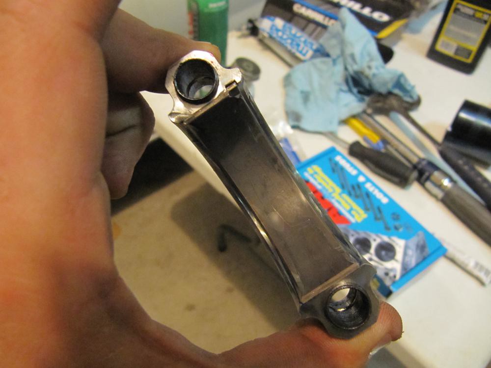

Apply lube to the innner AND outer sides of the corresponding bearing and press it into the corresponding rod cap (remember to align the notches in the bearing and cap). Mate the rod cap with the rod and tighten the rod cap bolts to spec. (not pictured; forgot. Bah)
Generally, you are required to tighten the rod cap bolts to a specific "stretch" up to a certain amount of torque (in ft-lbs). I went with just under the maxiumum torque setting since I didn't have the tools to measure stretch.
Cylinder 1 is done. Rotate the entire assembly with the crank pulley bolt to ensure there is no binding.
Repeat the same steps for cylinders 2-4. Once they're all in, rotate the entire assembly again and get blown away at the awesomeness of an assembled short block. Note the positioning of the intake valve reliefs of the piston tops; they are facing the PCV/water pump side of the engine.

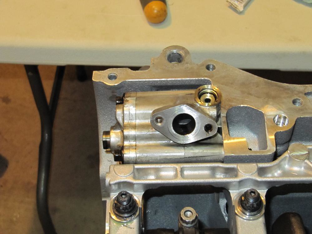

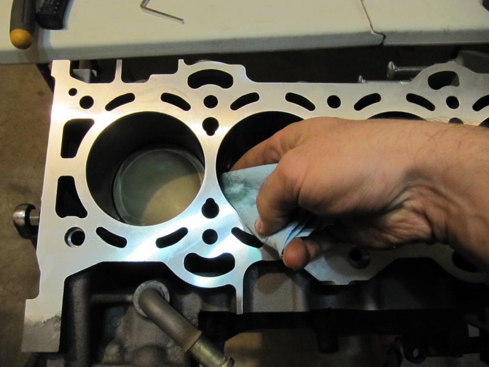

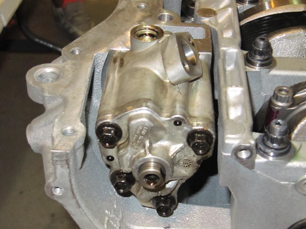

Flip the block upside-down again and fasten the oil pump to the block. Don't forget to attach the black plastic pick-up tube as well. The only thing left on the bottom of the block is the oil pan.
Flip the block right side up when done.

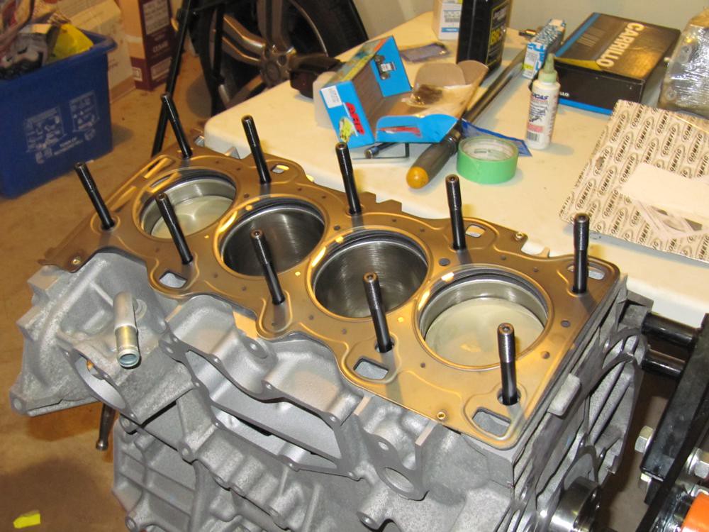

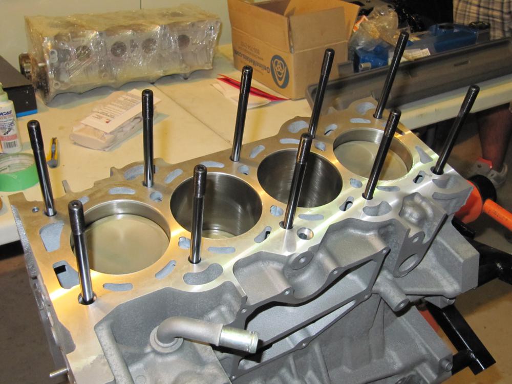

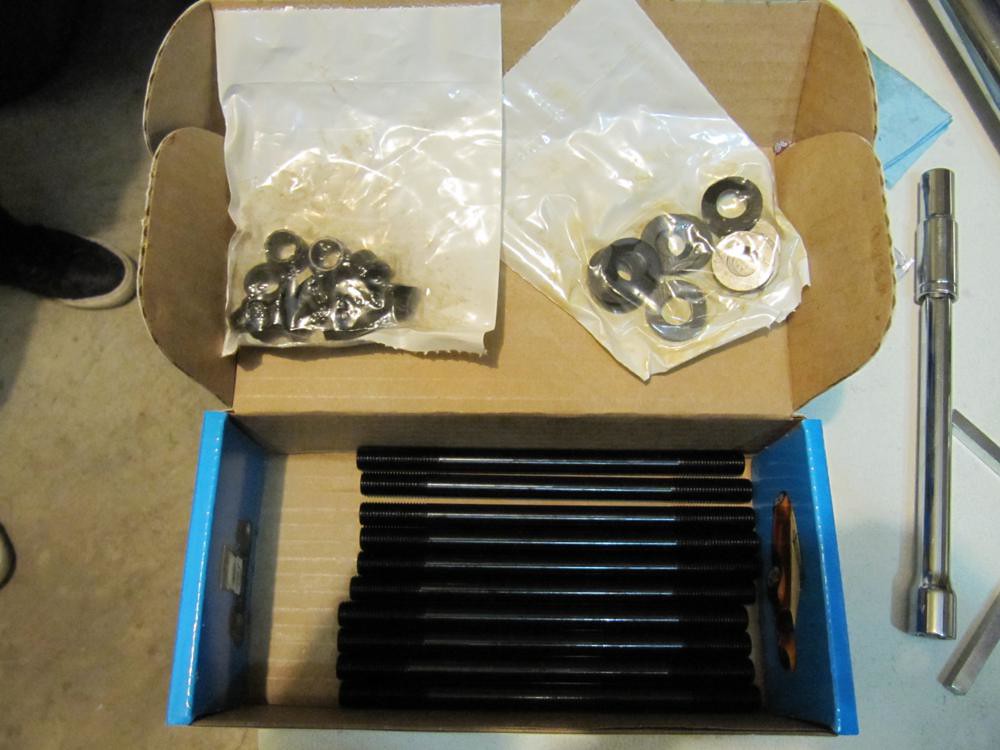

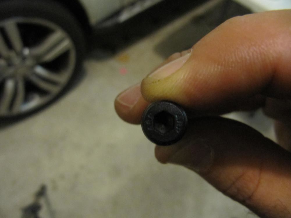

Next up are the ARP Head Studs (they are longer than the mains). Use the same approach as the mains. Apply ARP Ultra-Torque Lube to the threaded portion of the stud on the side without the hex and thread it in by hand.
Again, tighten the studs by hand until they bottom out. Do not go any further. Apply ARP Ultra-Torque Lube onto the exposed threads of the studs.

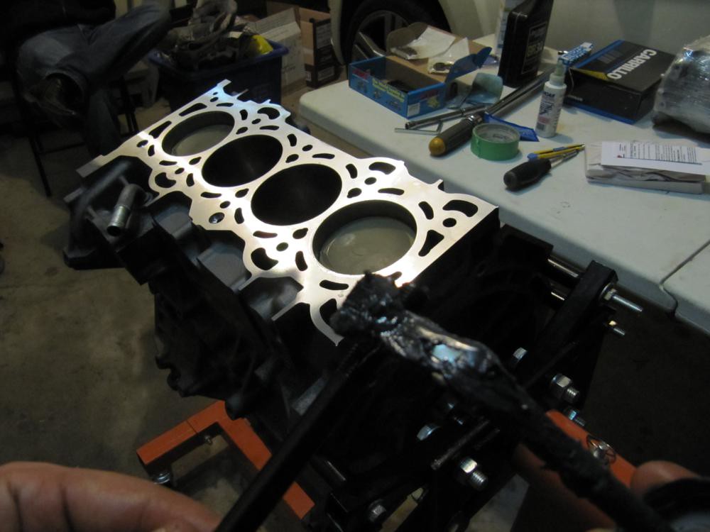

Slide on the head gasket.

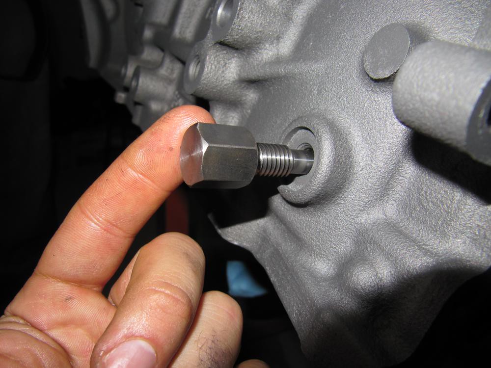

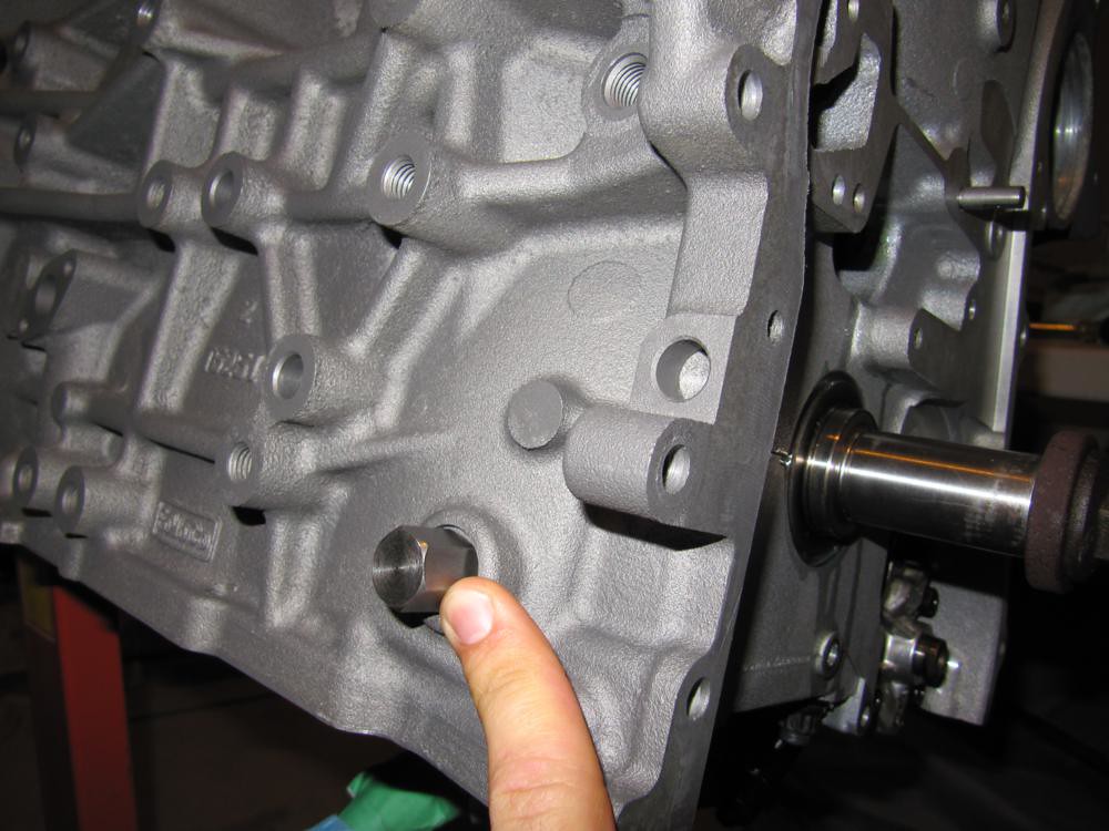

Insert the TDC crank tool into the proper blind plug hold in the side of the block adjacent to cylinder 1. Rotate the crank until the counterweight makes contact with the tool. Visually inspect the position of cylinder 1 to ensure you're at TDC.

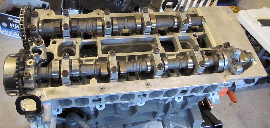

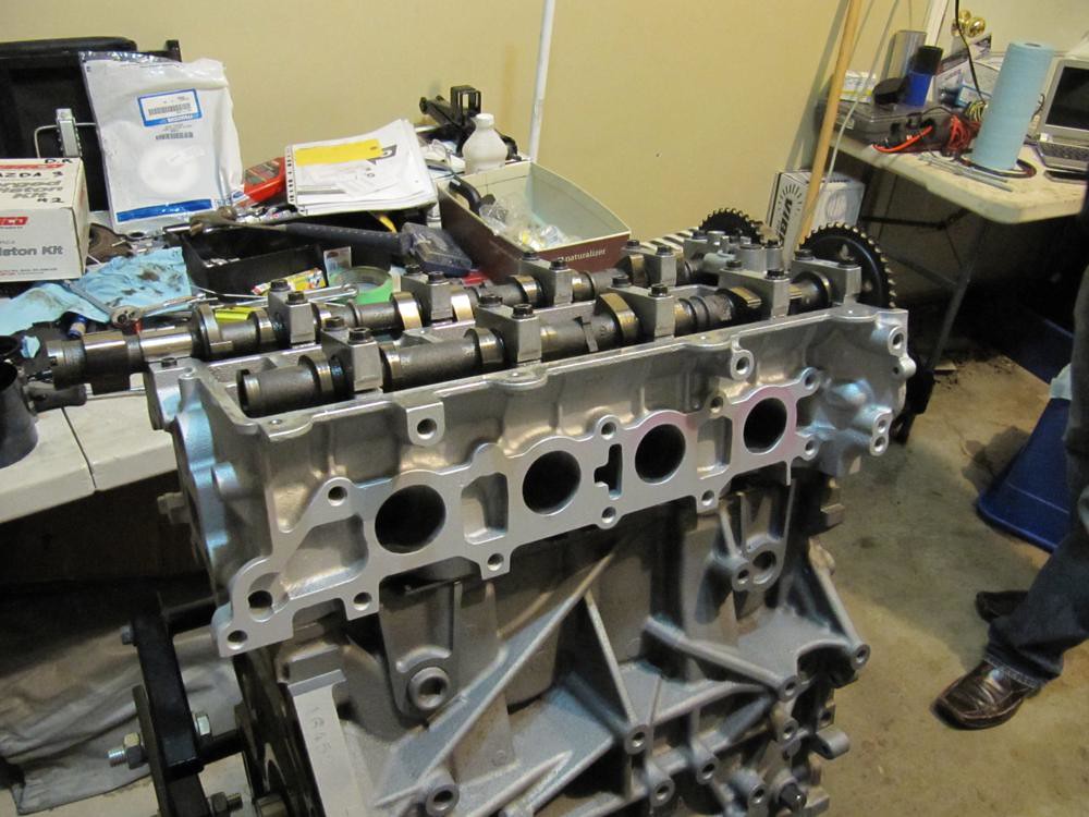

Slowly lower the head onto the shortblock. In this picture the cams are on the head but they are not tightened down. You could just as easily remove the cams BEFORE putting the head on the block (they will have to be removed for the next step anyways).
Remove the cams and caps and set them aside...

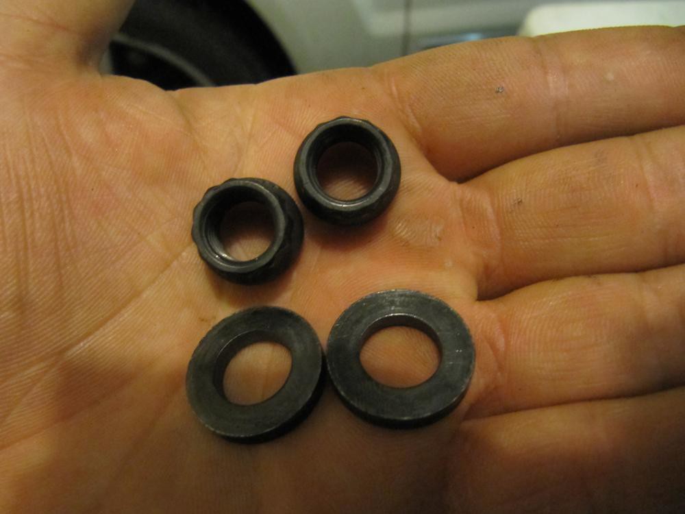

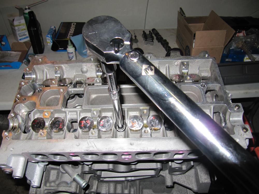

Place one (supplied) washer onto each head stud. Apply lube to the nut head, the threads and the socket to make it easier to fasten. If you don't lube the socket, it'll be a PITA since the nut will keep falling out. Thanks to DJ for that suggestion.
Hand tighten the nuts into the studs then torque them in 3 passes to 60ft-lbs using the order below. Other have tightened the head studs to 80-90ft-lbs to prevent the head from lifting at high boost. I've been running 25PSI through my setup using ARPs recommendation and haven't had an issue so far.

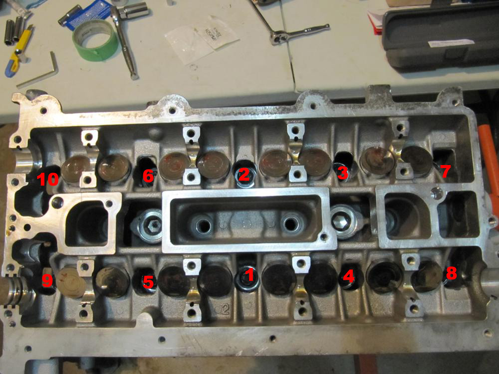

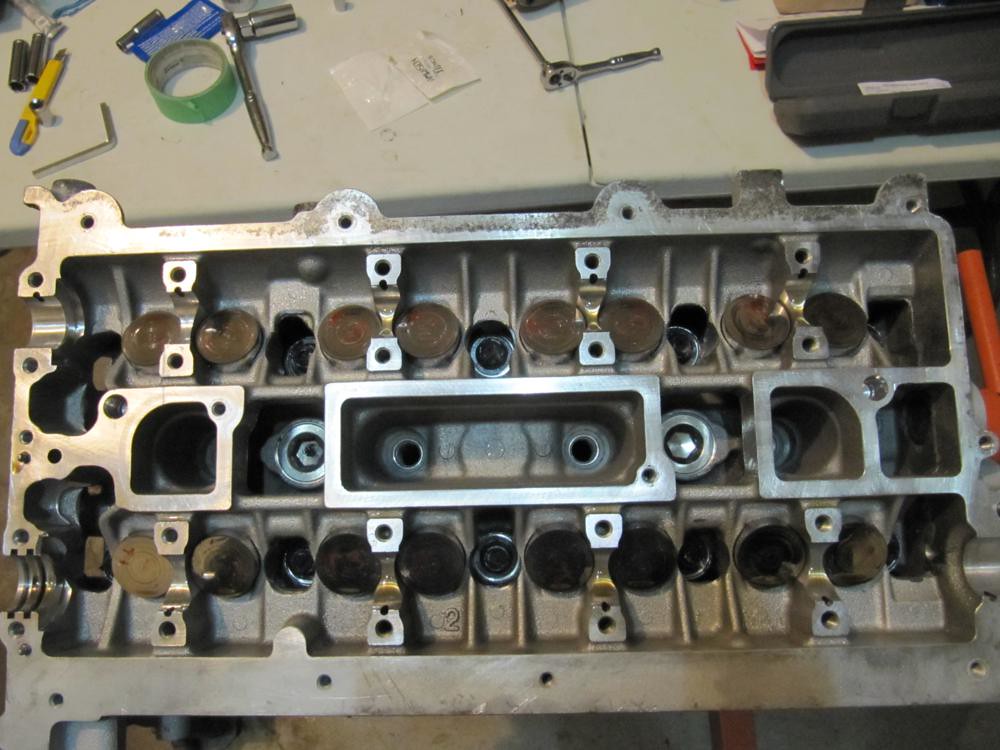

If you haven't dropped in the valve buckets, do so now. Make sure they were labelled before the engine was disassebled (Intake 1, Intake 2 etc... and Exhaust 1, Exhaust 2 etc...) as you have to put them back in the exact order for proper valve lash. If you forgot which goes where, god help you.

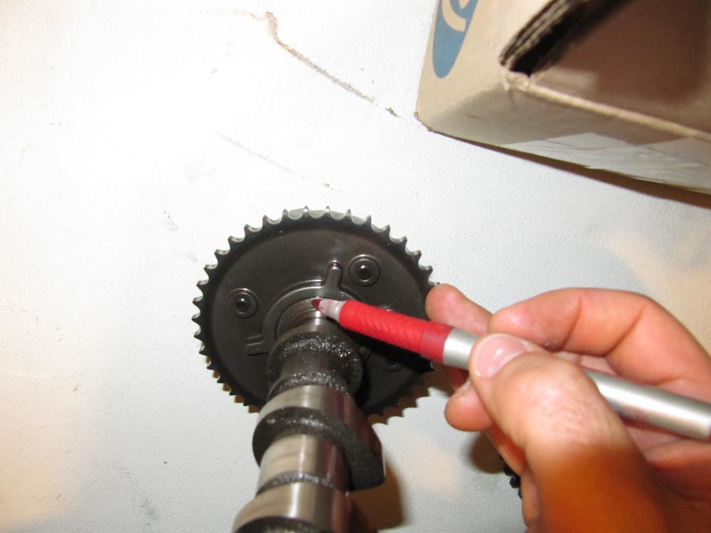

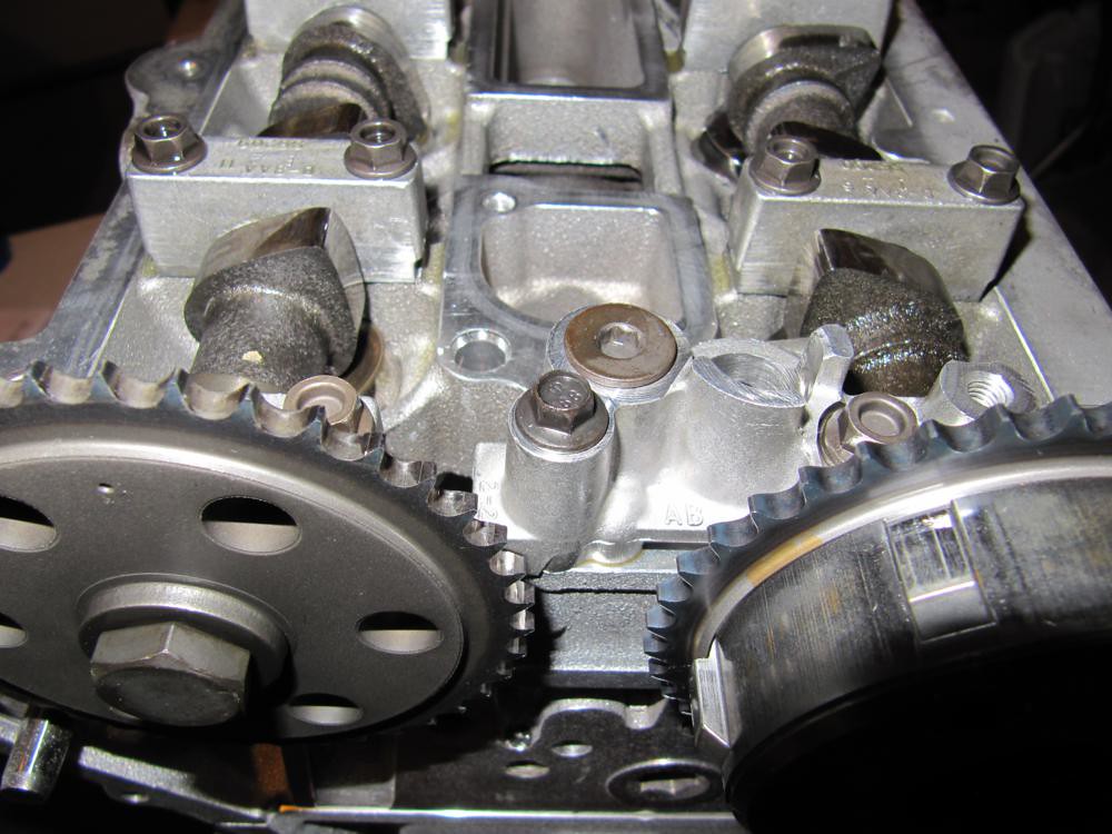

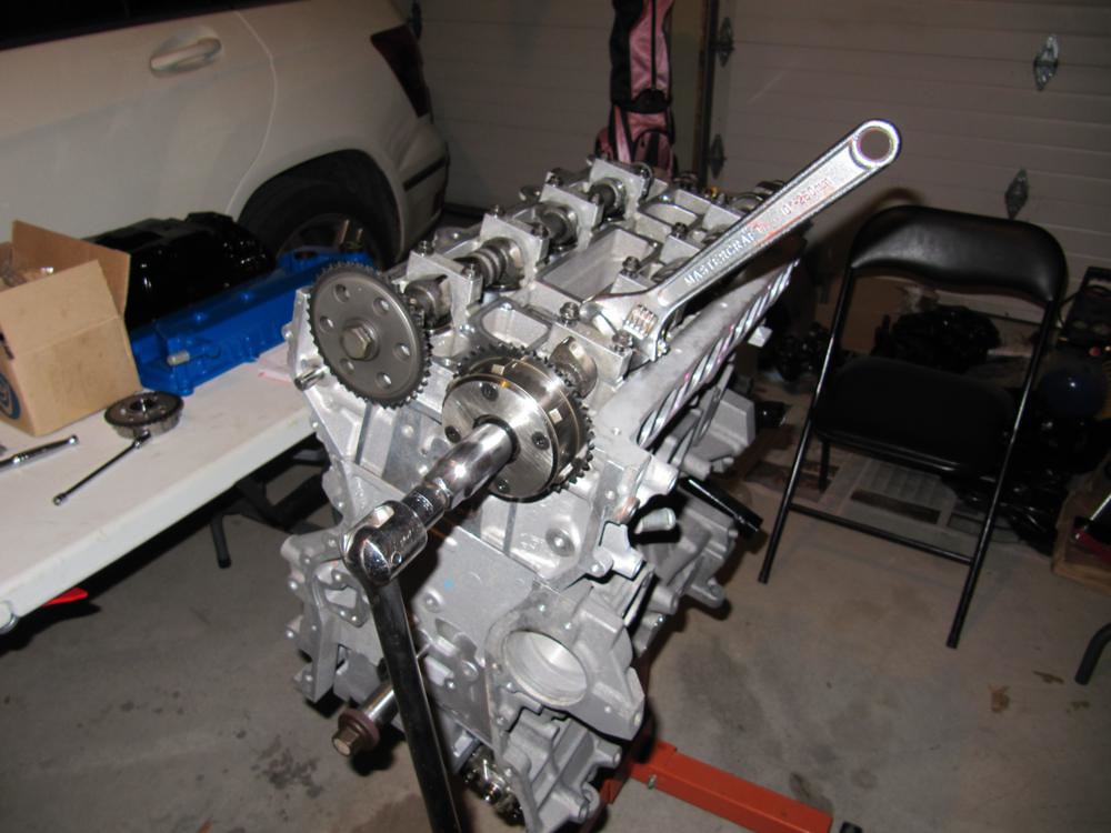

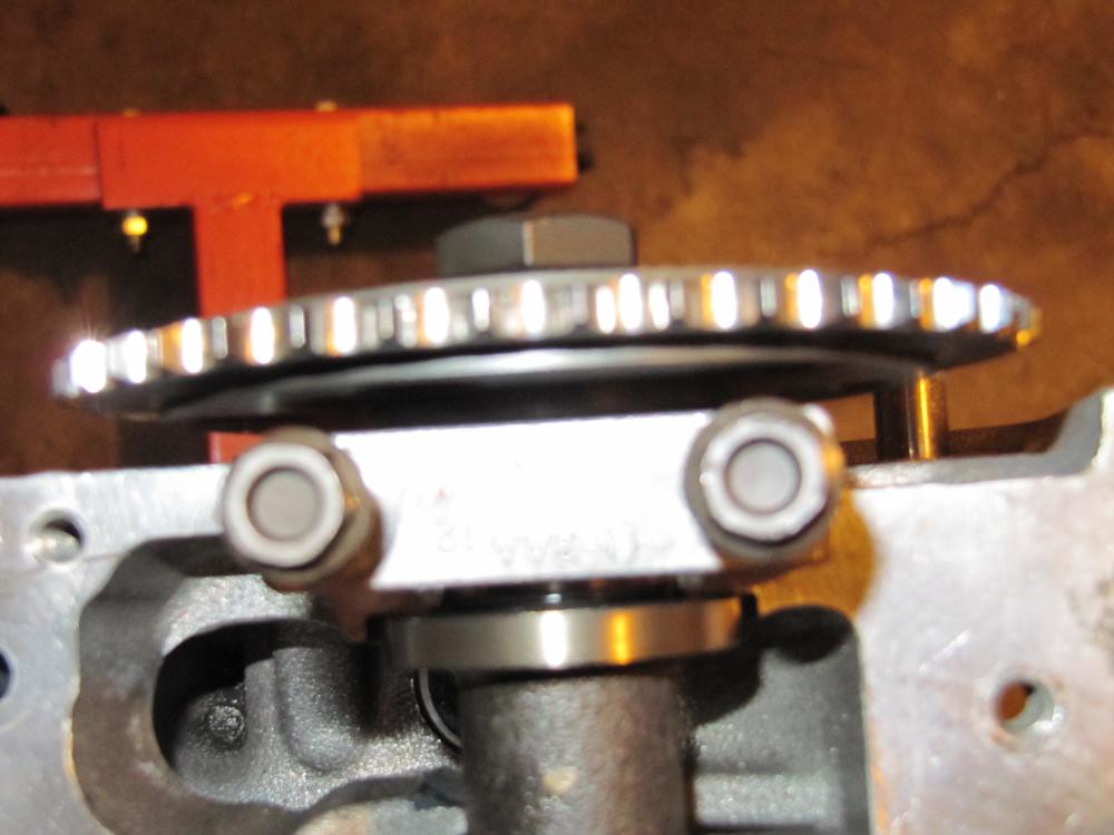

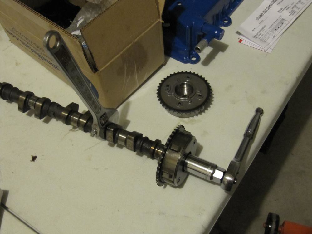

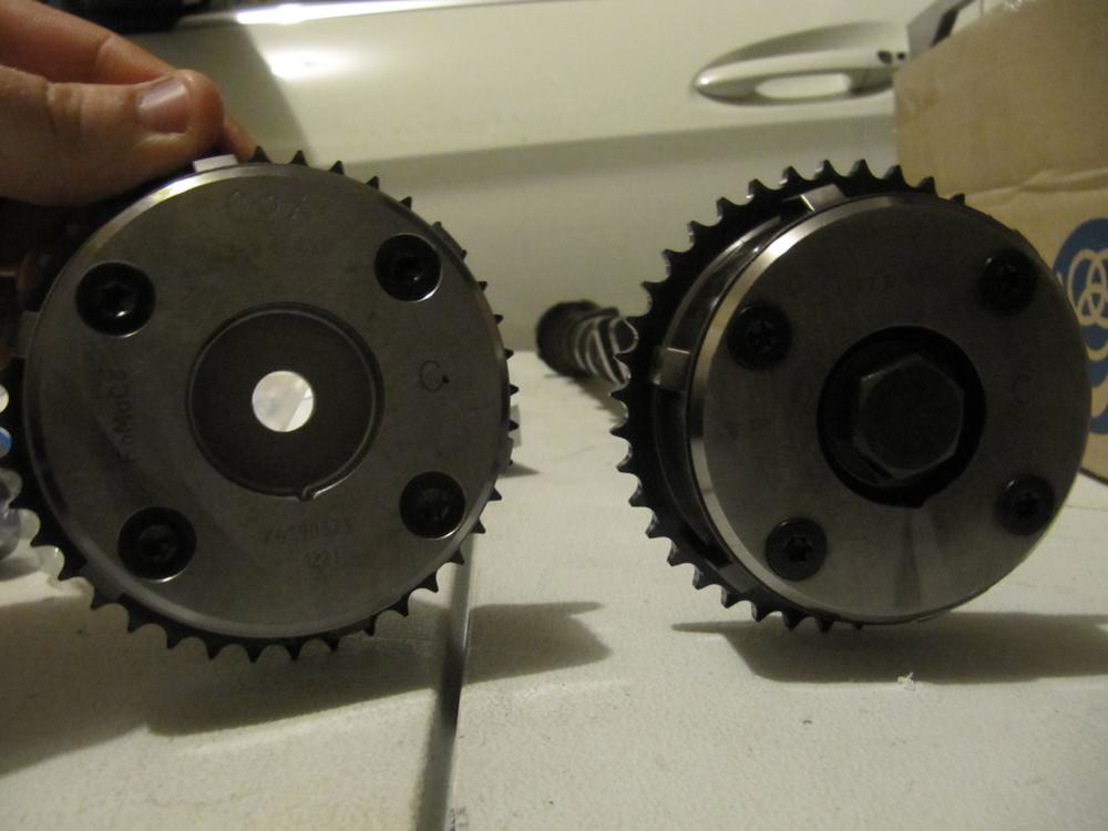

If you ordered a DCR VVT upgrade, you can swap it in now. Start off by drawing two lines that extend from the cam and onto the back of the VVT sprocket where the two mate. This will act as a reference for the new VVT since it the new one has to be oriented EXACTLY (!!!) like the original.
Use an adjustable wrench or open end wrench to secure the cam with one hand (on the hex portion of the cam) and a ratchet on the other. It shouldn't take too much effort to get it loose. There's a friction washer in there; replace it with a new one.
There's a chance that the crank may have turned since you last secured it to the TDC SST. Go back and make sure that cylinder 1 is at TDC.
If, like me, you don't have a table vise, throw the intake cam on the head. Securing the cam to the head will act as a third hand for the steps that follow. Ensure the orientation of the intake cam lobes look like the following and throw on the SST onto the back of the cam prior to torquing the cam caps onto the head. (Ignore the fact that the exhaust cam is on the head for the moment; I didn't have a picture without).
IF you torque down the intake cam without ensuring that a) cylinder 1 is at TDC and b) the cam lobes are aligned as pictured, there's a very high chance the valves will make contact with the pistons and you'll end up bending the valves.
Slide on the DCR VVT (properly aligned - remember those markings you made?), secure the cam with a wrench then tighten the cam bolt to 50ft-lbs using a torque wrench. After you have tightened it, make sure the VVT didn't rotate relative to the markings on the sprocket/cam.
Next, install and secure the exhaust cam onto the head (see previous photos for proper cam lobe orientation). Loosen the bolt securing the exhaust sprocket to the cam. Do not remove the sprocket, though. Just let it freewheel for now. Make sure you tighten the cam caps while the cam is aligned with the SST.

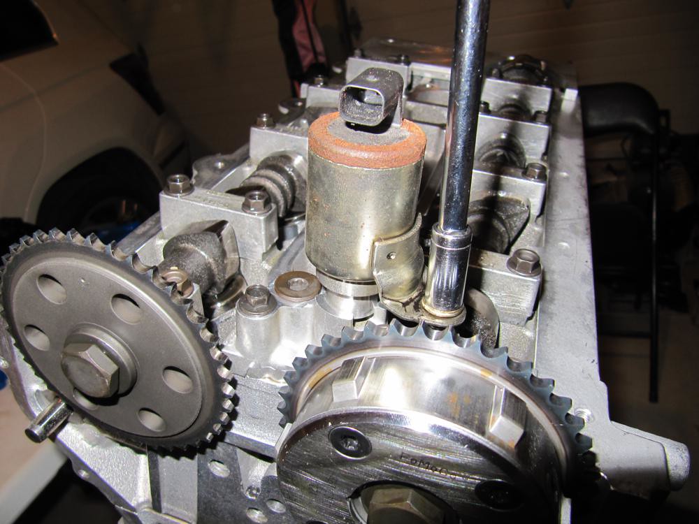

Install the VVT actuator onto the head.

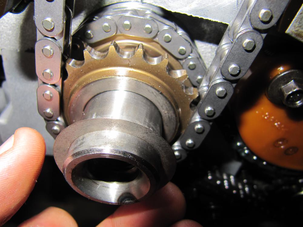

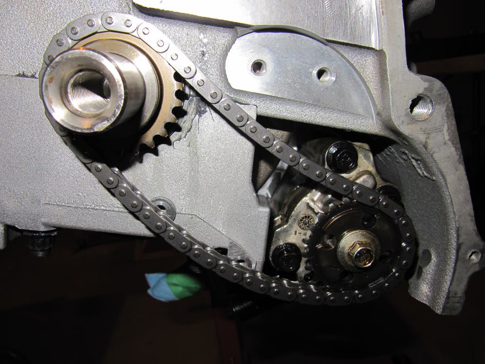

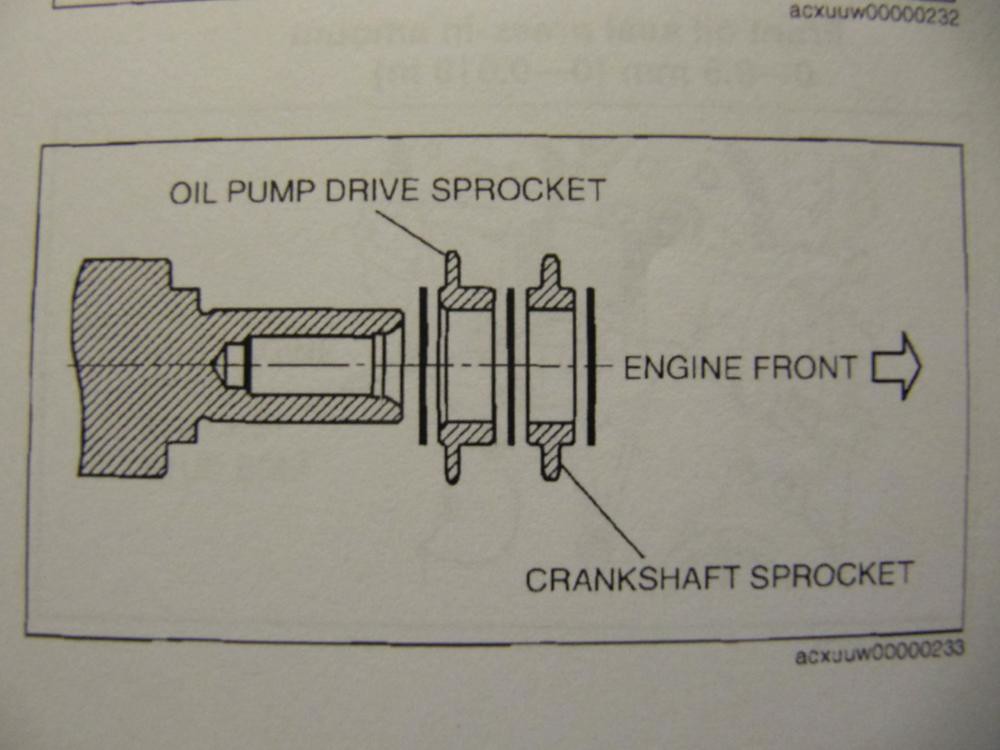

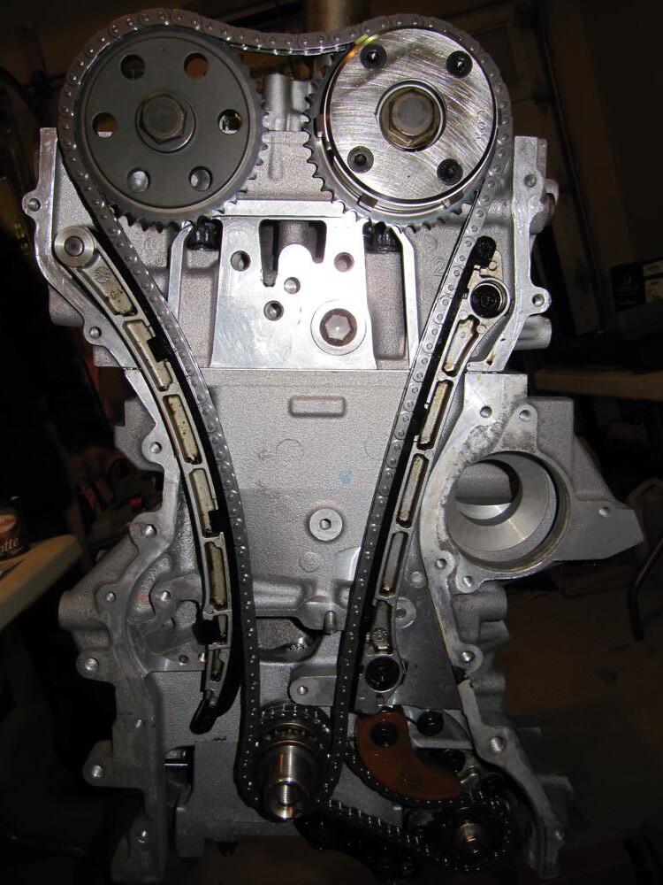

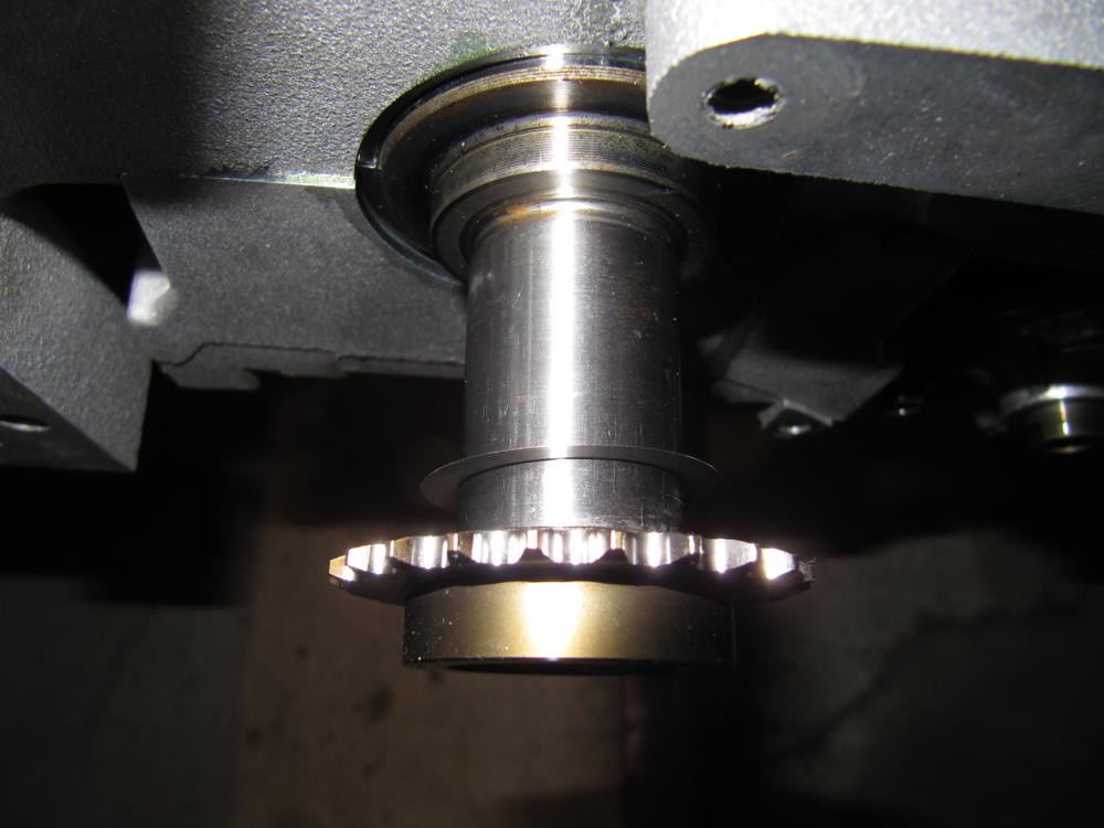

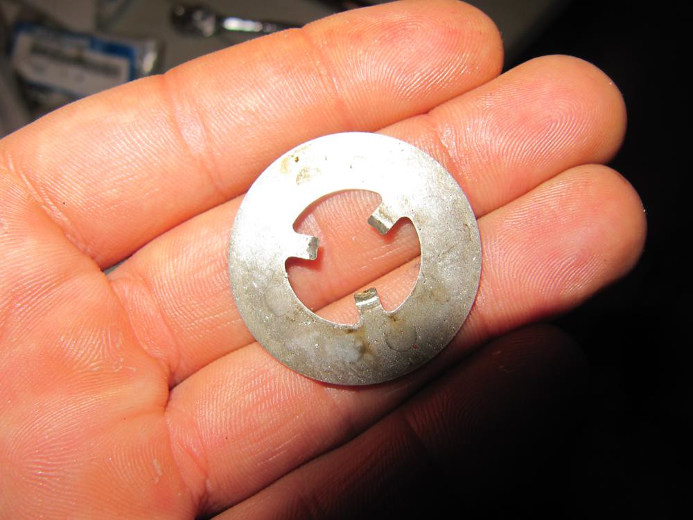

Slide one (new) friction washer onto the front of the crank then the oil pump sprocket. Ensure you're putting on the oil pump sprocket and not the timing chain sprocket; they are different.
Dangle the oil pump chain onto the crank sprocket then install the keyed oil pump sprocket onto the oil pump. There's a SST for this but I just jammed a screwdriver through the keyed sprocket and tightened the bolt; torque specs aren't that high. See the manual for the proper torque.

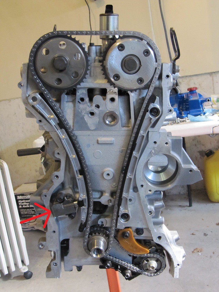

Install the oil pump chain guide (black piece on the bottom) and the tensioner (orange thingy). Be sure to add some assembly lube where the chain meets the guide. Its straight forward hence the automotive terms like "black piece" and "orange thingy"...

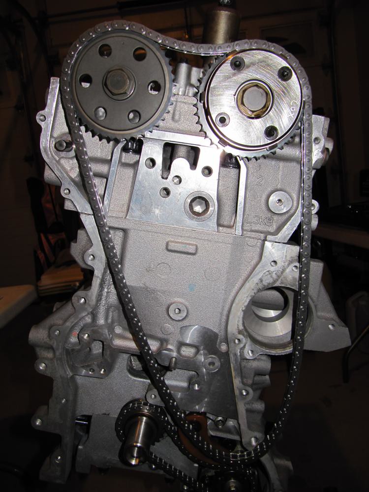

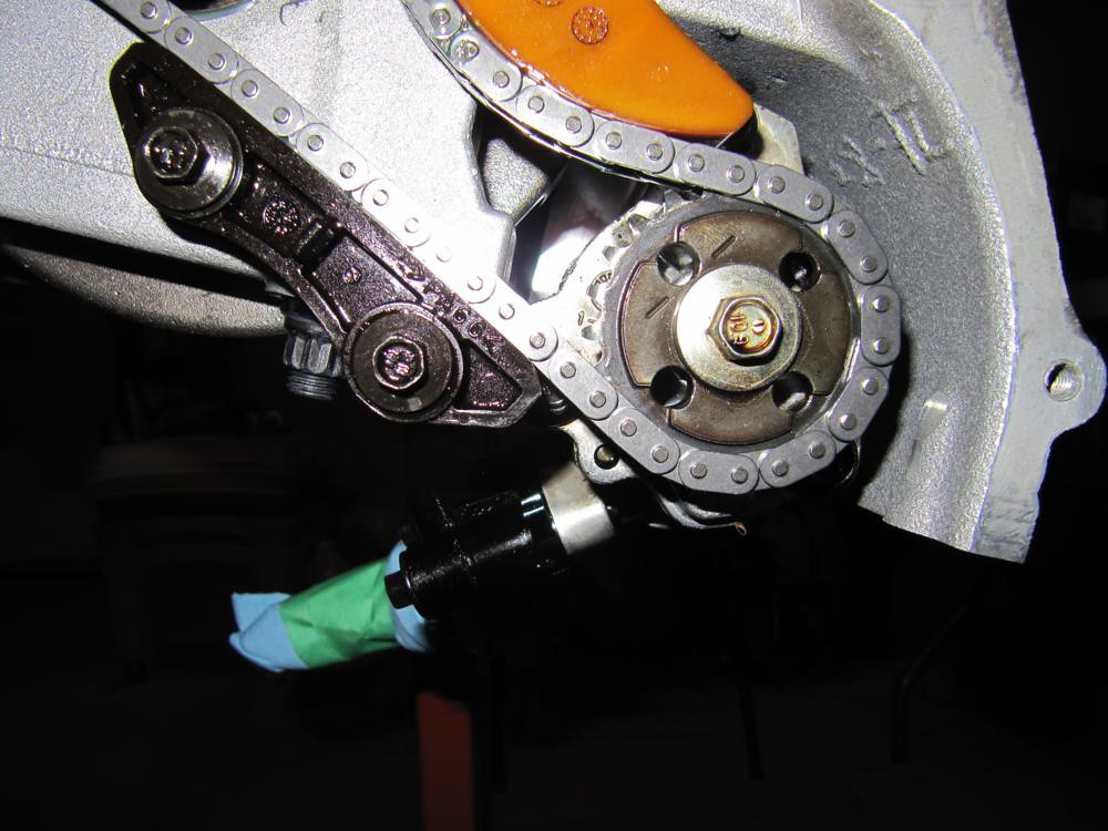

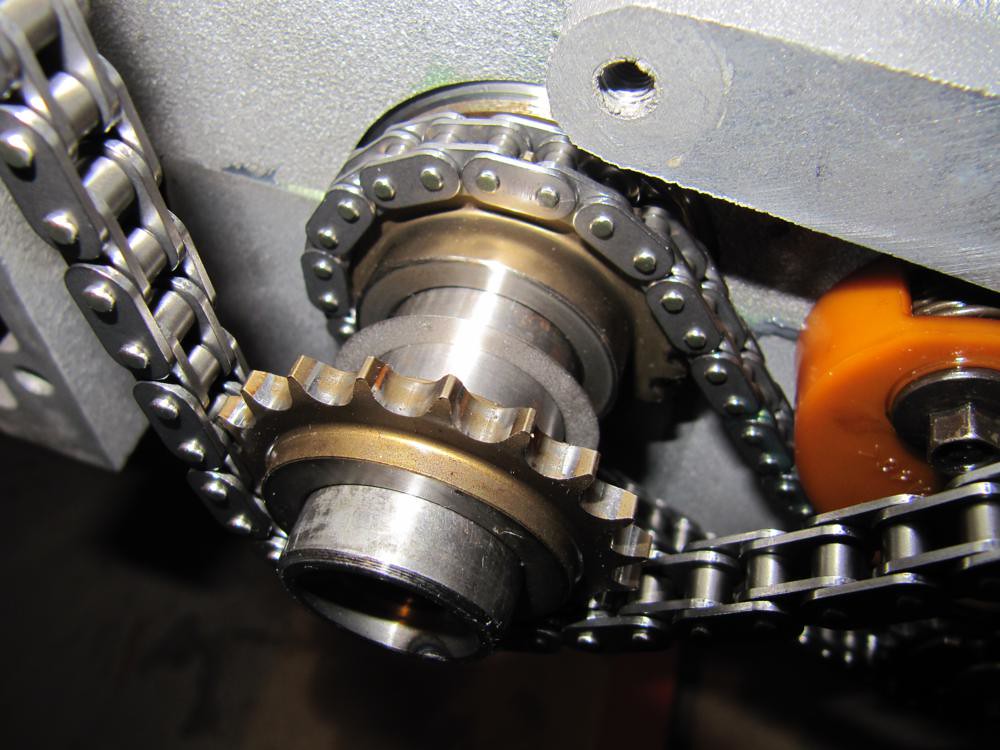

Dangle the timing chain on the intake/exhaust sprockets.
Slide another friction washer onto the front of the crank then insert the timing chain sprocket with the timing chain attached. You should be able to get it on after a few F bombs.
Slide on the last friction washer.
Attach the timing chain guide (on the right) then the tensioner arm on the left (add some assembly lube onto the surface where the chain meets the guide). The guide on the right is secured by two bolts and the tensioner arm on the left just slides onto the dowel pin on the head.

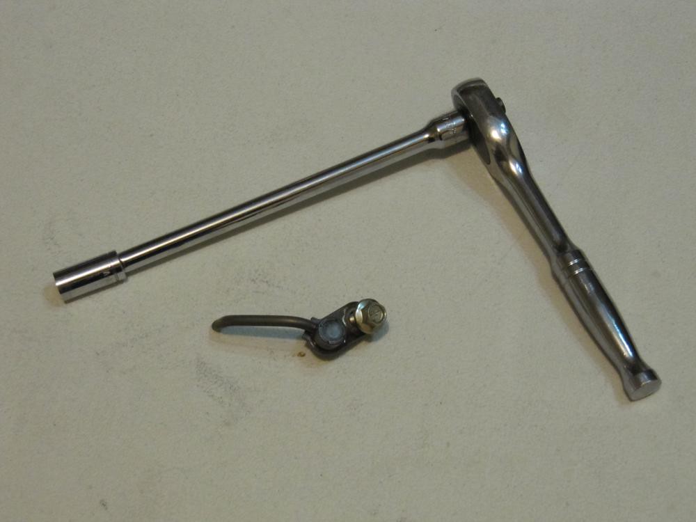

Compress the timing chain tensioner and jam it with a paper clip on the locking mechanism (not pictured; shoot). Install the tensioner onto the block then remove the paper clip. The tensioner should push out onto the tensioner arm and make the timing chain taut.

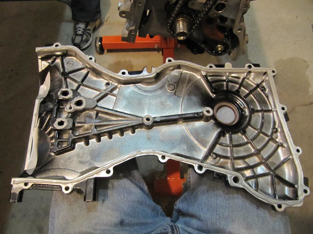

Insert a new front seal onto the timing chain cover, spread a bead of Permatex sealant around the perimeter of the cover as well as the interior bolt holes then install it on the block. See the instruction manual for proper front seal depth and bolt size placement.
Well, I sure as hell didn't mark the valve buckets. With my old MR2 that used shims in the buckets I would always just change sizes till the clearance measured with a feeler gauge was within spec. I was of the impression the buckets on this head being hydraulically lifted didn't need any adjustment but now I am sort of frowning wondering what's going on.
How do you adjust valve clearance on these heads? (if you even have to?)
What are the tolerances here and how do you make sure "valve lash" is within spec if one is starting a new head with say new valve buckets?

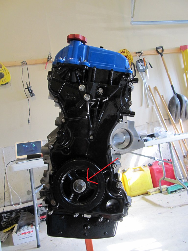

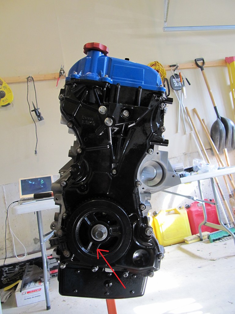

Slide on the crank pulley onto the crankshaft. If you followed the steps up until now, the final friction washer should already be installed.
One of the spokes on the crank pulley has a hole in it. Align that spoke so that it is pointing downward. Directly behind the crank pulley hole now should be a threaded hole for a 6mm (I think) bolt on the timing cover. Grab a 6mm bolt and pass it through the crank pulley hole and thread it into the timing cover. No need to torque the bolt too tight; you might end up snapping it. All you need it for is to hold the crank pulley in position for the next few steps.
Thread in the crank pulley bolt by hand until it stops.
*Ignore the fact that the picture has the oil pan and valvecover mounted. We're not there yet.*
This part is very important now.

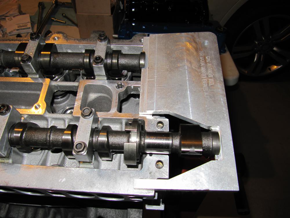

Go back and make sure that a) the cam SST is still in place b) the front cam lobes are properly aligned (the first sets of lobes on each cam point upward and toward each other) and c) cylinder 1 is still at TDC.

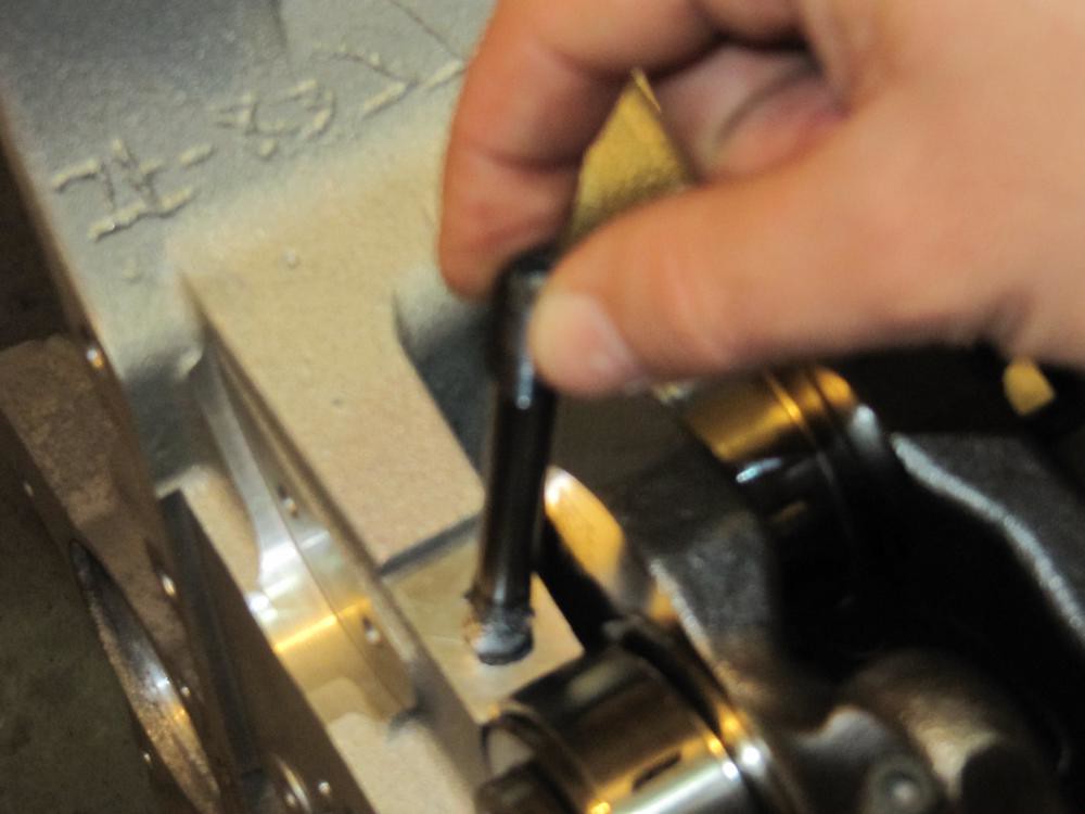

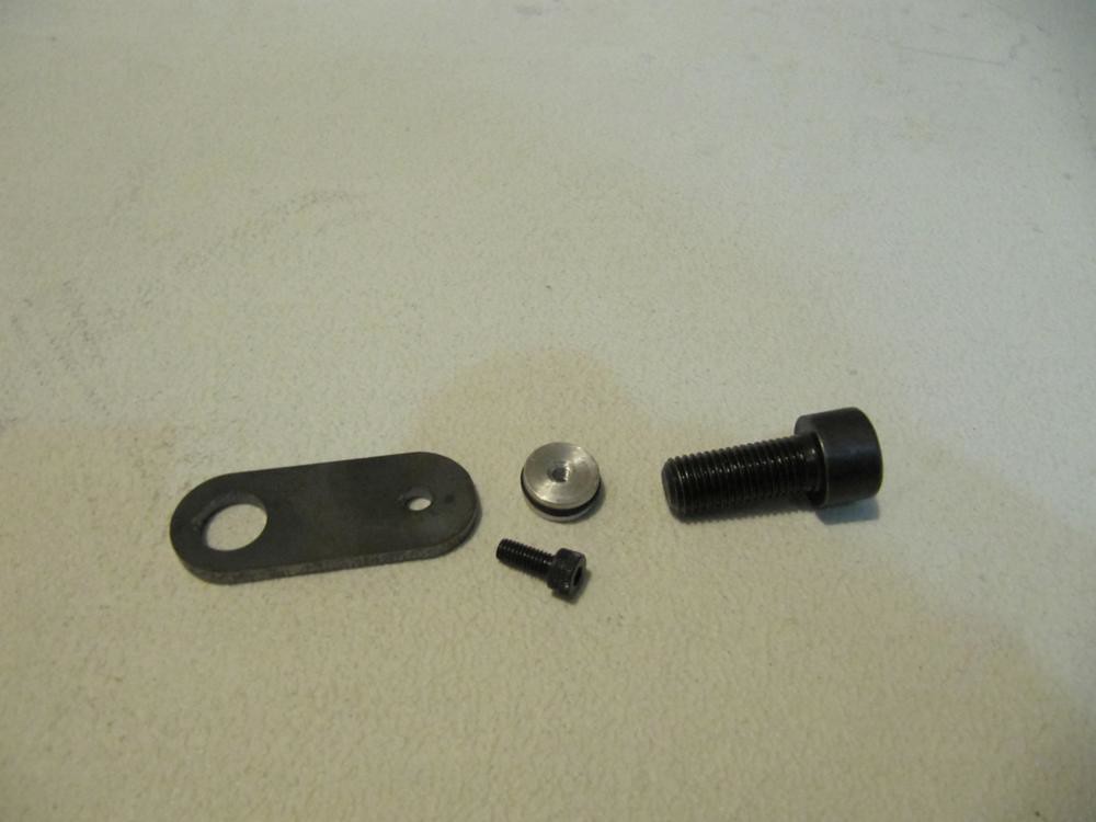

Note: You may want to swap out the TDC pin in the side of the block with a beefier M10 bolt or install the flywheel and jam it. There is a chance that if you tighten the crank pulley bolt just using the TDC pin, you may break it causing the pistons to hit the valves.

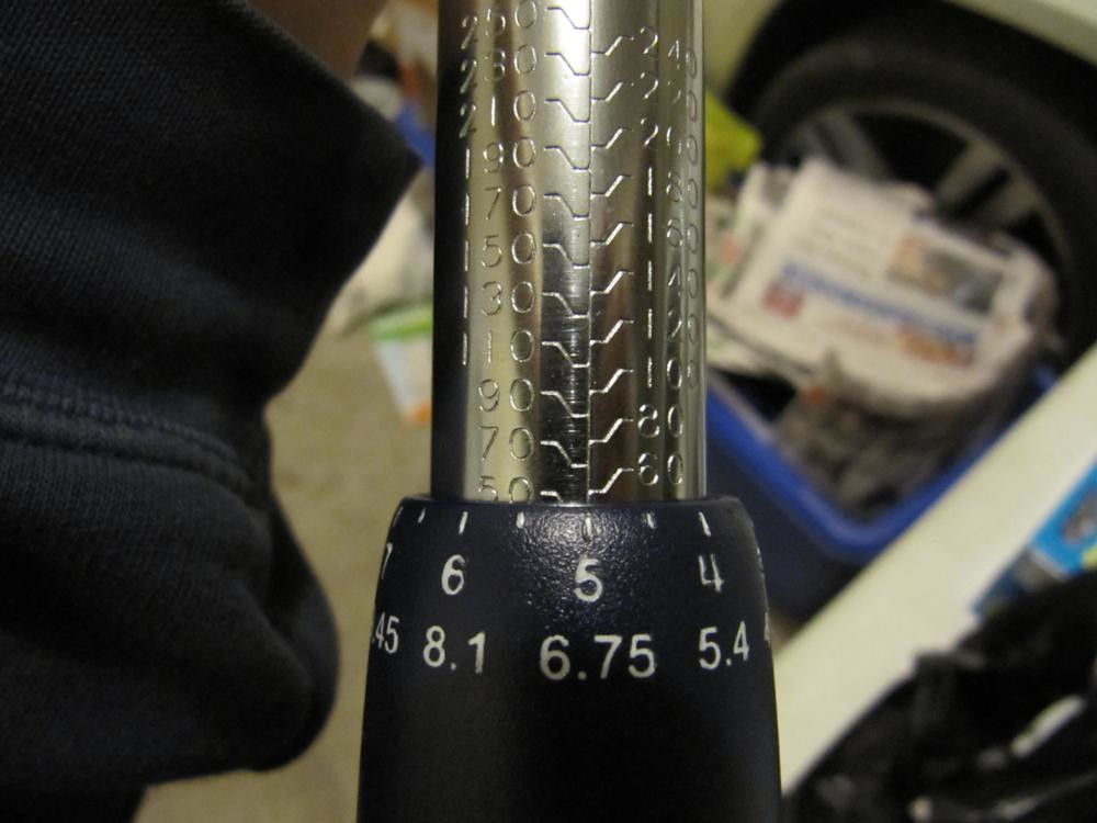

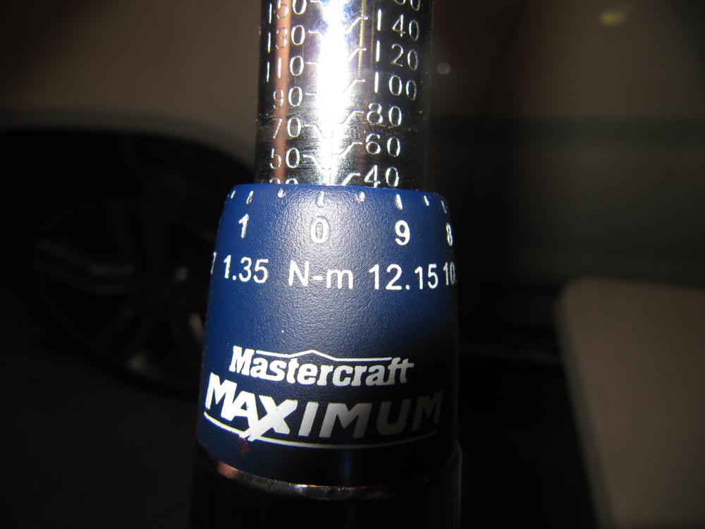

Once you have verified everything is in place, its time to torque the crank pulley bolt. Grab your torque wrench and set it to 90ft-lbs. Torque the crank pulley bolt until the torque wrench clicks.
Next. With a permanent marker, scribe a straight line through the edge of the crank pulley bolt, crank pulley washer and crank pulley.
*Go to the kitchen, eat your wheaties and a shit ton of Popeye's spinach*
Grab a biiiigggg effing breaker bar with a pipe extension and tighten the pulley bolt an additional 90 degrees (if you don't at least have a breaker bar for this step, go buy one). Use the markings on the crank pulley bolt and crank pulley to indicate where you are at. Once the marking on the crank pulley bolt is 90 degrees relative to the crank pulley, you're done.

Now, its time to tighten the exhaust cam sprocket onto the cam. Grab your adjustable or open end wrench and position it on the hex portion of the cam (just behind cylinder 1). Grab another wrench and position it on the sprocket bolt. Holding the wrench on the hex portion of the cam steady, tighten the bolt to 50ft-lbs (I went by feel here). The trick is to not let the cam rotate at all when tightening (there's a bit of play in the SST) and let the bolt wrench do all the work.

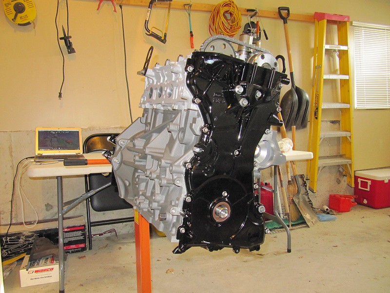

Flip the block upside down in preparation for the oil pan installation.
Part of the timing cover hangs below the short block. If you recall, we spread a bead of Permatex sealant around the entire perimeter earlier. Well, some of that Permatex never made contact with anything and has probably dried up by now. Wipe the excess off.
Spread a bead of Permatex sealant around the perimeter of the oil pan. Don't forget to put a bead on the portion where the oil pan meets the back of the timing cover.
Lower the oil pan onto the block and install all the bolts. Make sure your drain plug is on as well (no picture unfortunately).

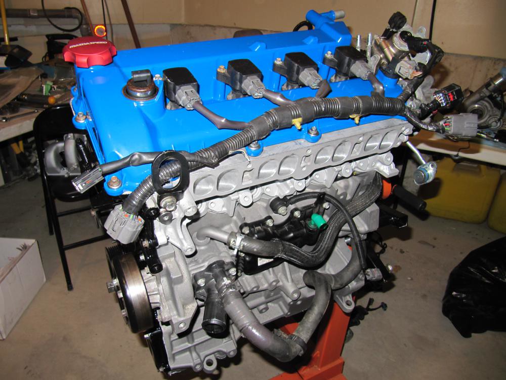

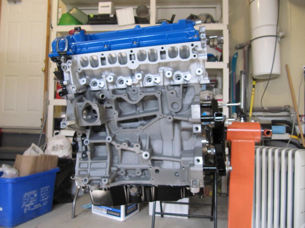

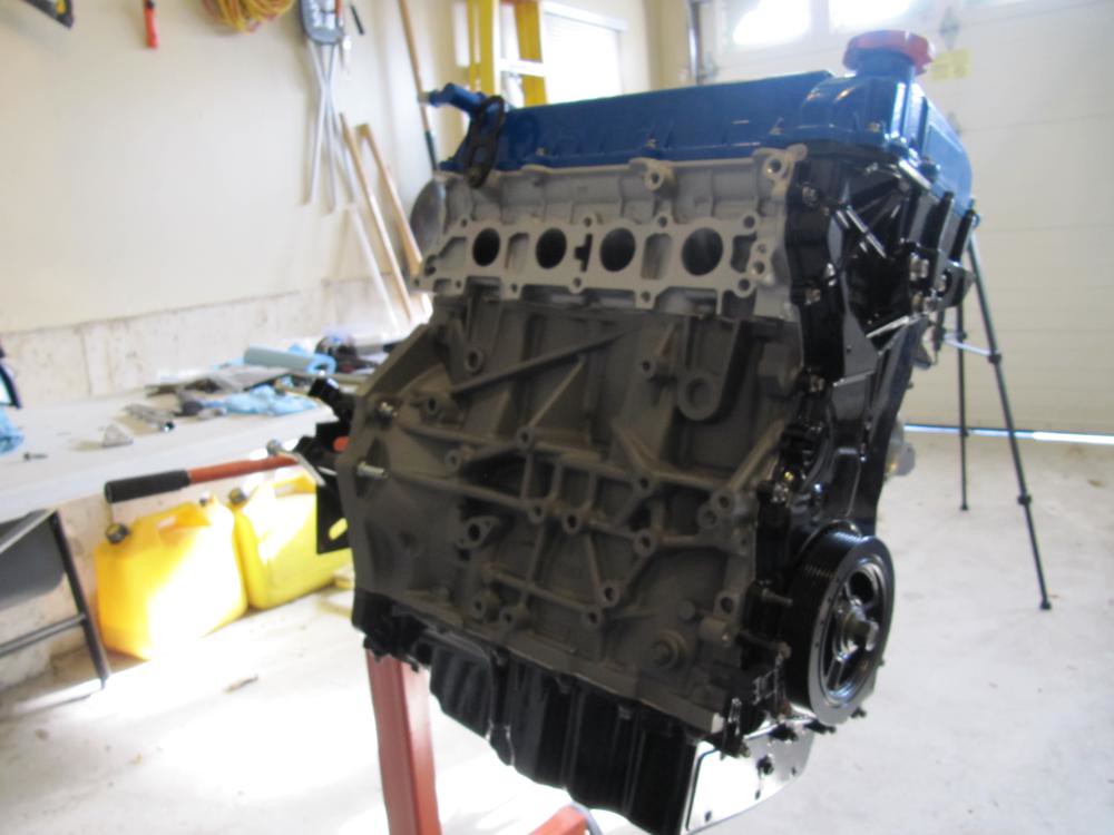

Flip the block right-side up and install the valvecover. Your engine should now look something like this.
If it looks like a barn, you did it wrong (Simpsons, anyone?).

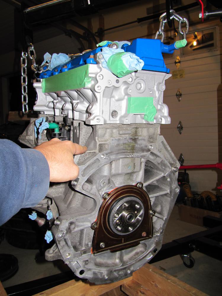

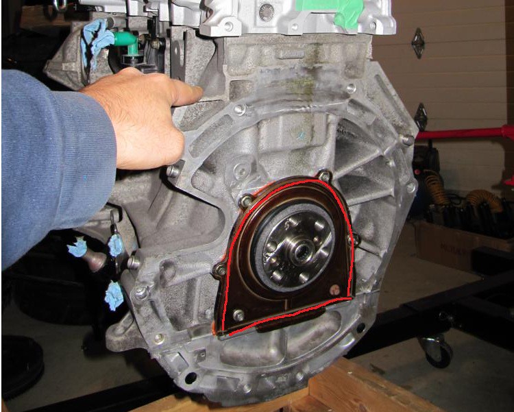

Get the engine assembly on a hoist for the final piece; the rear main seal. I spread a bead of Permatex in the following manner; the Mazda manual omits the bottom portion. There was nothing to lose which was why I did it the way I did.
*NOTE: The bead of Permatex was spread on the INSIDE of the rear main seal. I do not have the proper photo*
Install the rear main seal using the supplied install tool. All you need to do is position the seal onto the block, tighten the 6 bolts then remove the install tool (you'll know exactly what I mean when you see it).
DONE!
That make me wish someone would do the opposite write up - How To CORRECTLY disassemble your engine for a rebuild......

Just make sure that you install the pistons in with the valve cut outs on the front of the engine. If you install them with them in the rear your intake valves may hit..

For those that would be torquing there head studs to 80/90 ftlbs, would you make a 4th pass to do that or do you still only want to do three passes with the torque wrench?
Where did you get your block?
Haha. I'll make it anti-climactic so you'll take it back and groan me.
If I were to torque the head down to higher values, I'd just add an extra pass (in 20ft-lbs increments) until I reached what I wanted. The purpose of the multiple passes is to inch it down towards the block nice and true.
I got the block off a friend. He stripped his car and will be sourcing an LS motor sometime in the next year.

Great write up! Do you by chance remember what size the stock head bolts were? Can't find the proper socket to remove the stock 12pt head bolts.
cplensdorf is offline   Reply With Quote
The Following User Says Thank You to cplensdorf For This Useful Post:
BlueStreak (02-04-2012)
 Old 02-03-2012, 08:42 PM   #30
qtrmile beast's Avatar
Location: charles co, MD
Posts: 2,423   (View Stats)
Thanks: 1,295

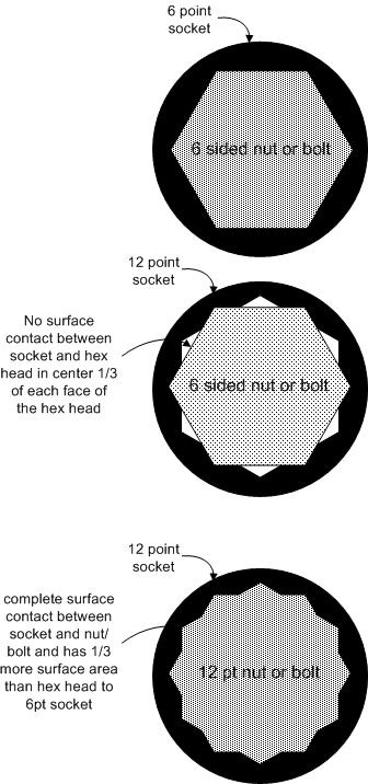

lol you use a 12 point socket... the 6 point will not fit...

I think it was a 12mm 12 point. Can't remember 100%.
Valve clearance is adjusted by swapping in buckets with different thicknesses that will take up the slack between the top of the valve stem and the cam lobe. They are numbered on the inside and Mazda offers around 20 different bucket measurements in very small increments.
I don't know what measurement is ideal. I can go back and ask the engine builder what mine were set at if you'd like. They document everything.

Aha!
Holly shit.
I am glad I read this thread. Found the specs in the manual.
0.22mm to 0.28mm intake
0.27mm to 0.33mm exhaust
Tomas is online now   Reply With Quote

Everyone keeps saying 12mm 12pt but that just spins...this is frustrating...tried multiple sockets including brand new one....
 Old 02-04-2012, 06:59 AM   #34
Thanks: 1,295
Take a video of it but if it just spins then maybe it is either already loose or broken perhaps, hope it is not stripped? Is it all of them or just one that it is doing that with? have you tried the 11mm 12point or other sizes since it is spinning on the bolt?

For those in need of a bit more clarity, like me, a picture
I had thought it was a special socket for the head bolts, but nope, just actually using all the contact area of your average 12 pt socket.
Nifty...

Yep..tried 11pt and even standard. Too small or too big. bolts aren't stripped. It is all of them and none are broken or loose. Its baffling.

By the way,
Do you get any cold start piston slap at all with the wiseco pistons? If yes, for how long?

any particular reason that you applied lube to both sides of the bearing. ive always left the "block" or "rod" side dry as to make sure there was no chance the bearing could spin

By the way,
I get piston slap for cold starts under 10*C. The length of the piston slap correlates with how cold it is so its hard to say.
I put lube on the outer sides of the bearings to help them fit in easier. I wasn't worried about them slipping.
