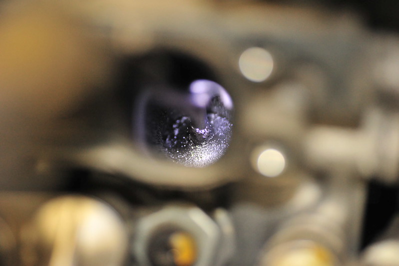

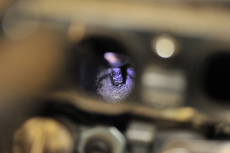

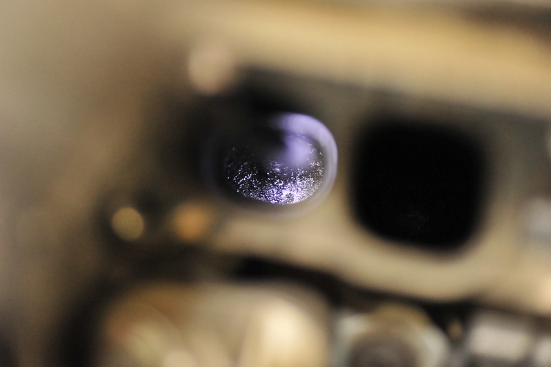

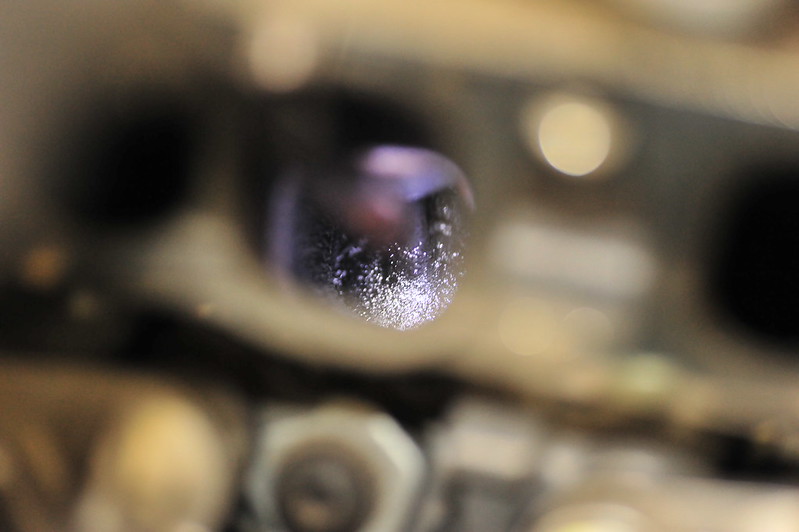

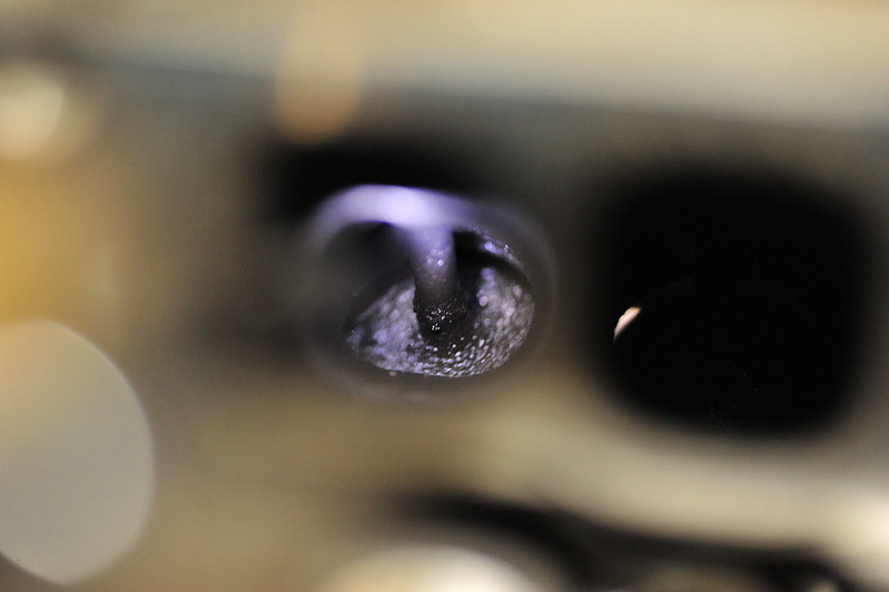

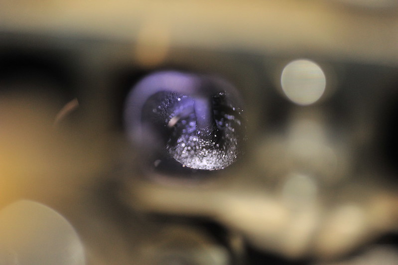

Posting if anyone is curious to see what the valves look like for a speed3 with methanol injection, EGR blocked off and OCC.
Car Details:
Mileage: ~92k kms
EGR blocked off since ~30k kms
OCC since ~30k kms
Methanol injection since ~60k kms
Seafoamed 4x, as recentlly as ~8k kms ago
Oil: Mostly Rotella T6 5w40 but have since switched to Redline 5w40 to reduce deposits.
Driving style: 100% city driving
Diagnosis:
TB, Intake manifold and VTCS flaps were pretty clean. VTCS flaps had minimal carbon deposits. This is where methanol injection helps keep things clean. The carbon around the valves was moist, sticky and paste like.
#1
#2
#3
#4
Car Details:
Mileage: ~92k kms
OCC since ~30k kms
Diagnosis:
#1
#2
#3
#4
Did you end up cleaning valves? If so what did you use? I ask because I just started my cleaning with similar setup

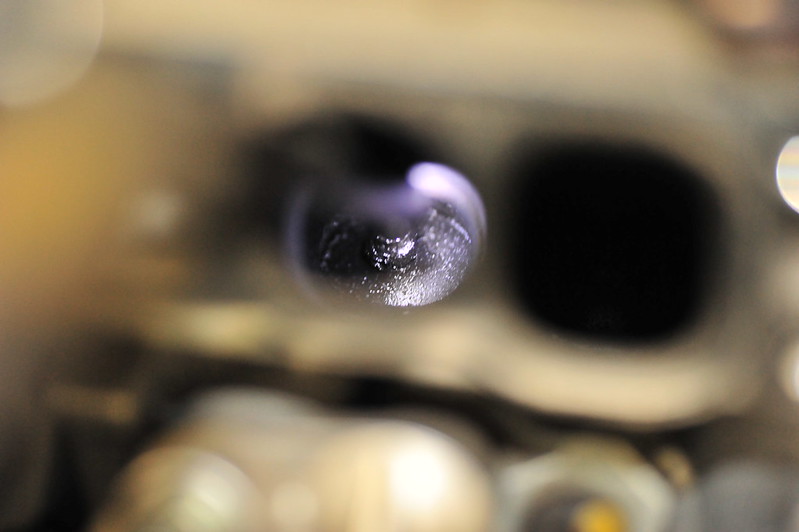

well, if nothing else your post proves that even someone with no idea of what they're doing can clean the valves.
I had no idea* what I was doing and following this, plus a how-to on IM removal here and the writeup on JBR managed to get it done with no issues. I just had a few notes.
1) The 1" hose you used. Was it 1" ID or OD? I bought some 1"ID hose and could not cram it into either runner. When I do this again I'll be sure to have some smaller stuff on hand.
2) If you are buying the media blaster for this purpose and do not have a air compressor with a decent CFM rating, consider buying a dedicated media blaster from HF. That little gun is total crap. I had a 2-stage dryer on and it clogged non-stop using fine media. Gangster style or not.
3) I used a syringe to get the B12 out of the can and into the runners, 20cc fills the large one perfectly to the top of the stem and 17cc fills the small one.
4) Not having a fluid transfer pump nor a shop vac I'd want to let explode, I made this little venturi pump, and had the other end in a bucket with some rags. I cut a small slit in the side of the tubing stuck the tip about halfway in. I did the blasting first followed by B12 and still managed to nearly clog the tubing with the crap is sucked up. I have 130k miles and the previous owner never cleaned the valves. I wish my pictures came out better, the valves were just downright gooey.
*no idea in that I have very little experience on cars but work on particle accelerators for my job and am very experienced taking things apart and keeping things clean and being careful.

Originally Posted by Lex2007 View Post
Does the car run better? Stronger? Smoother? No diff?
Its minor, but very noticeable. Starting was terrifying, but once it actually started it ran fine in like 5 seconds.
My idle is now smooth. After the engine is fully warmed my idle was rougher than I wanted, after the cleaning it is perfect.
I was getting uneven power at around 3k RPM under moderate acceleration. I cleaned the IM as well, especially the swirl valves, and I'm wondering if is has more to do with that than the intake valves, but either way its completely gone. It felt like a miss but was more subtle than I'd expect.
My LT Fuel trims went from -5.5 to -2.8 after the cleaning too.
In the end I'm quite happy I did it, maybe I'm imagining things but someone else said they felt like it was a smoother application of power and I'd completely agree.
One more tip though, if you take off the swirl valve actuator, maybe you want to follow these instructions, its a TSB from Mazda. Short of it is to use a hair dryer on the plastic.

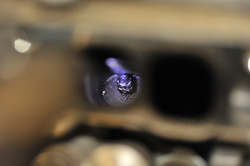

Sorry to rez this thread, but I'm looking into cleaning my valves very soon (like the next couple days). Now I see a few threads on valve cleaning, but has anyone had any experience with the B12 eating away at seals or any other hoses/fittings? Seems like Seafoam is a little less harmful, but could also be a little less effective at cleaning the valves.
I just got done cleaning my IM, bought a replacement gasket, ordered an EGR delete kit and stage 1 OCC + VTA option from DM, just replaced my high-pressure fuel line with the CS line, and am in the process of upgrading my injector seals to the CS seals.
Talk about a process....

Ah, thanks for the reminder. I saw this the other day, but got pulled back to work. Just reported it.
