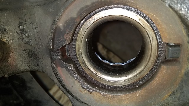

National 510096 front Wheel Bearing fits Gen1 Speed3 BUT THE TONE RING IS NOT READ BY THE ABS SENSOR. National claims its for ABS cars and its listed in ROCKAUTO with a heart but it didnt work for me. Total waste of time.
I switched ABS sensors from one side to the other and checked continuity in the ABS wire. Even after cancelling the ABS/DSC dash lights 3 times, they kept coming back. I even took the hub off again to make sure I had put it in correctly.
Maybe this part is faulty. I am perplexed. I did the other side with an OEM bearing and it worked without issue.

It's installed correctly but no signal received:
[IMG]IMG_20170831_201511655[1] by xcvx4, on Flickr[/IMG]
Installed an OEM bearing and dash lights gone.
Do not use National bearing 510096 for Mazdaspeed 3.
