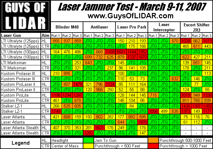

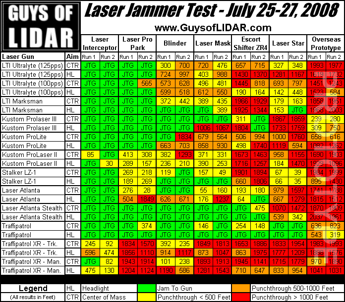

The Laser Interceptor laser jammer smokes the competition.
Radar Detector Tests and Reviews by Guys of LIDAR
Guys of LIDAR - Laser Jammer Test - March 2007
Laser Interceptor website:
Laser Interceptor USA - Distributor to The USA, and Canada

Correct.
I considered the LI, when I was deciding what to buy.
My Blinder paid for itself already.
It works real world.
And costs less than half the $$ of the LI.
I like value, the Blinder is value that works.
Plus the LI doesnt have wireless setup yet, the Blinder does that was a huge plus for me.
I wasnt 100% sure when I bought the Blinder (I saw the tests) but after my first "Save" I am a believer, it works and it is a LOT cheaper!
Not only did it work, it worked in a difficult situation, the LEO was way up on an overpass and off to the side.
